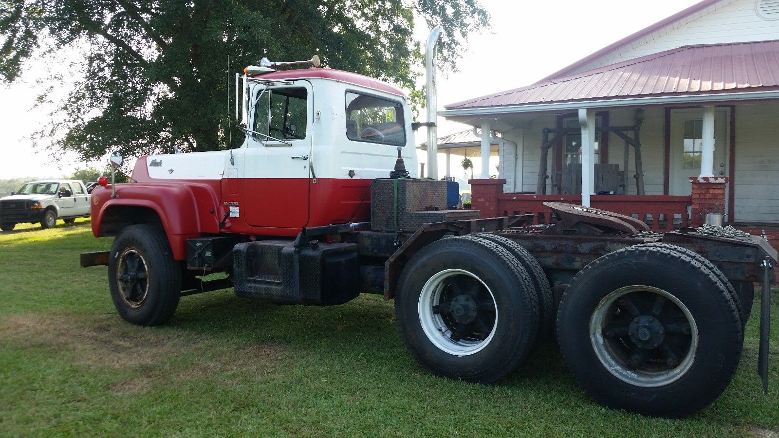

1 hour ago, 1965 said:
Would that have the short cab?
That is the +3 cab. Dead givaway is the grab handle on the cab corner. To the somewhat experienced eye the cab corner is also wider than the shorter cab with the steel dash which ended in 1972.  Has heavy rears too.
It would either be the ENDT-865, and ENDT-866 engines dependent upon "Maxidyne, or Thermodyne", and transmission choice.
All  kinds of errors in that listing. I suppose the owner is not handling the sale. Listed as 300hp and if original would be 325,  Mack "triplex" trans but it's probably a TRDL-107, (two stick six speed) as the truck is an R-795 and that was common. It could have the low reduction trans like mine which is a TRDL-1071.
Lot of guessing on my part as anything can be changed through the years.

If the photos are honest I could believe about 500 miles on the front drivers and steer with a bit of a stretch. The rear rears, not so believable.
I'm always skeptical when there are known errors, or third parties involved in a sale of something I know a little, (borderline nuthin) about.....
Thanks; I knew it was early 70’s something. I noticed the very rear tires were different tread pattern it seemed. Thought the tri-plex was kinda strange for that year too.
