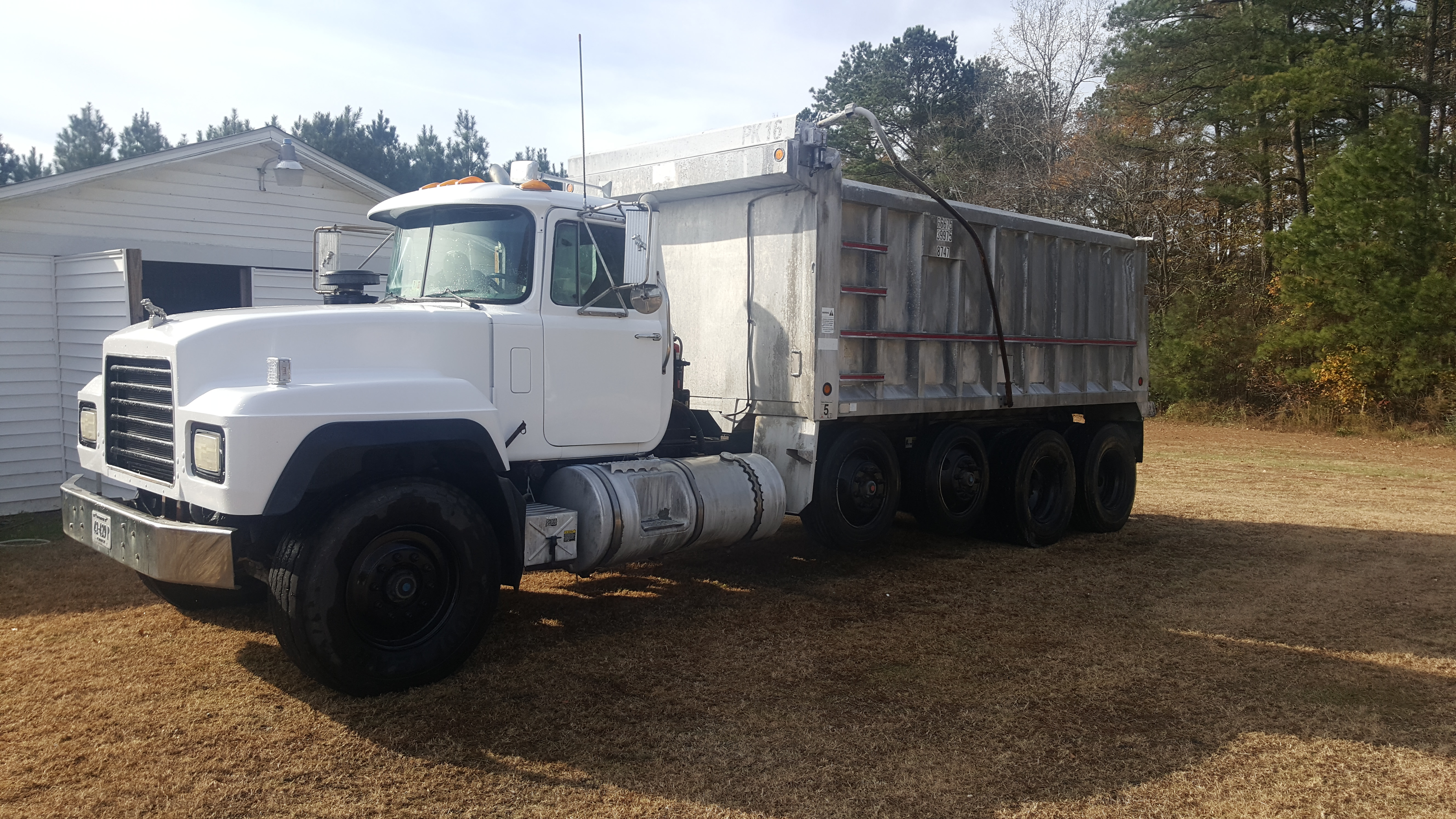

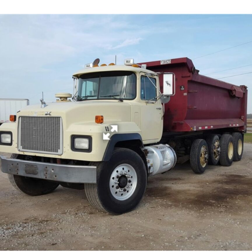

Ok guys went had both my dumps rd688s and rd690 a.c. service 688s blows but not the best 690 does not blow cold at all..both was charged and checked by a shop so I'm thinking that the units are dirty and need cleaning from dust and whatever else..so my question is where do I start and what do I need to remove. To clean the evaporator coil..
