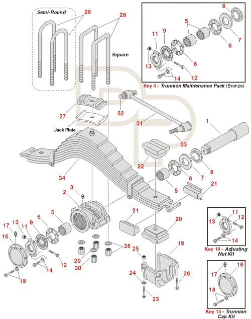

Hi all. I’m new to the site and I’m looking for some help figuring out an issue with my 1985 R Model Mack Truck.    I Purchased the truck a year ago and have been working on it.   I only use it sparingly because it is pretty much my baby. I’ve been getting some snapping and popping noises when I’m driving it.   I am no mechanic but it seems like a lubrication issue. I’ve tried all I know how to do to get it lubricated.   I’ve tried greasing it when it was loaded. I’ve tried jacking the truck up and greasing it.  I also took the cap off and cleaned out the old grease and put two new trunnion end caps on.   I believe the other ones were damaged and allowing moisture in.   I don’t believe the bushings are bad.   The trucks sat for a long time and I don’t believe it was greased properly. I’ve tried all I know how to do and the problem is still not fixed. Has anyone experienced something similar to this?  Any suggestions are welcome. Thanks in advance for your time.

 I had a little time to look into some of your suggestions on my 85R model This weekend checked for cracked rims all appear to be in good shape.   Checked all Lugnuts everything was good and tight   Jacked her up and got all drive tires off the shop floor and got her in gear and rotated the drive tires and forward  and reverse  truck was quiet as can be . The sound is definitely coming from the trunnion .  As you let the truck down off the jacks Trunnion  seems to be bound up making metal on metal sound   What you can hear in the earlier video  You can watch the trunnion  having a hard time getting back to level out  almost getting stuck in position  i’ve also noticed this while driving it over grade changes  I cannot get it lubricated and taking grease.  I guess at this point asking for suggestions could something be installed incorrectly or put together too tight in the trunnion? Or at this point should I go ahead and  have bushings replaced? Just don’t want to do further damage to an expensive component .  This truck has sat for almost 4 years before being put back into service  just trying to get some bugs worked out of her .  Sorry I try to explain what I’m experiencing the best I could I am no mechanic could I be missing something?  any suggestions would be helpful and thank you for your time in advance

If it isn't taking grease, I would say to stop using the truck.  All the old grease needs to be flushed out of the bushing and replaced with new grease.  Old filthy grease is just going to grind the trunnion bushing up.  After cleaning and inspection, you can see whether the bushing needs to be changed.  All the weight on the rear of the truck is being held by the bushing, it needs to be lubricated.

I have never worked with the heavier Mack rears but I see it has a cap that can be removed. I would pull that off and then see what it looks like. If its possible to jack it up from the center tube or lift from the rear of the frame that will show if it has to much slop. it will also help push grease into the bottom of the bushings when the weight is off it.  Pull that cap and let us know what you find

That will give you an idea of what your looking   Like mack attack said pull the end caps get the weight off the suspension give it some grease and see if it gets to the bottom
