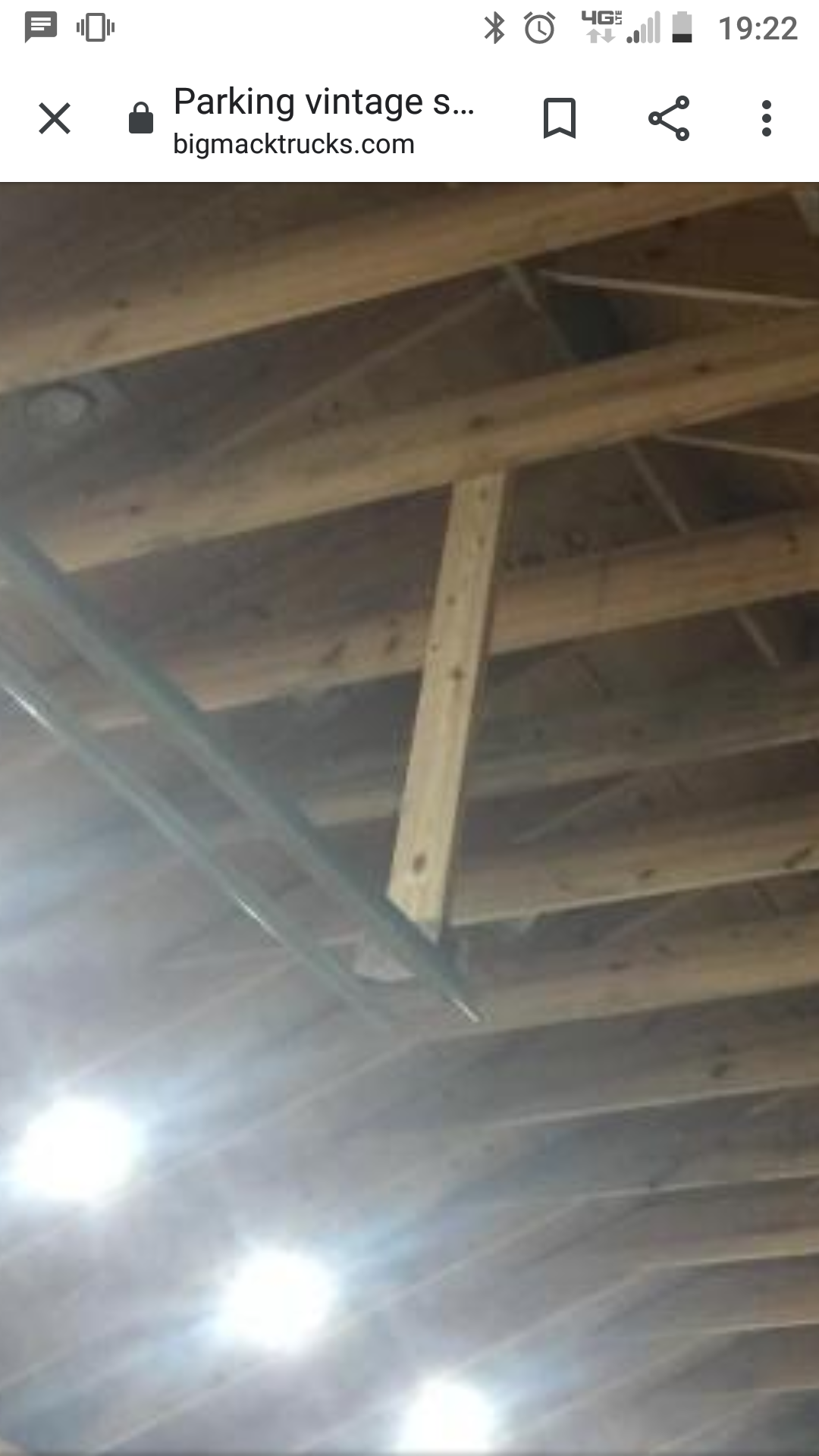

Got 1 row of  9.  1500 lumen can lights wired up.   I think when the other three are wired in I should have more then enough light .
Careful on those 2x's that the garage door tracks hang from, they should have a diagonal brace to hold them from swaying. If they away, it'll pull the wheels out of the doors and drop it on your head. I'd have run the 2x's past the collar tie and put diagonals in above the collar tie to maintain headroom.
I plan additional bracing to the sides.  It is a yellow pine 2x6 right now and will have a 2x6 brace v ‘d off each side.  The sides mounts near the wall will just go horizontal to the rafter above with a 2x6   But can you sketch out what you described.🤔

Needs a diagonal brace so it can't sway. If it sways while a door is up, it will drop the door on your head. If that 2x6 were run past the collar tie and attached also to the ridge beam that would suffice without cutting into ceiling work height.
