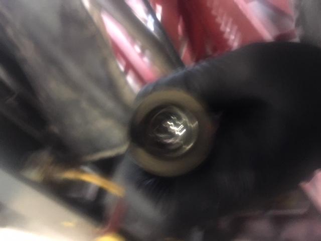

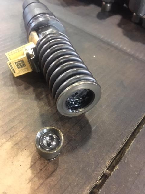

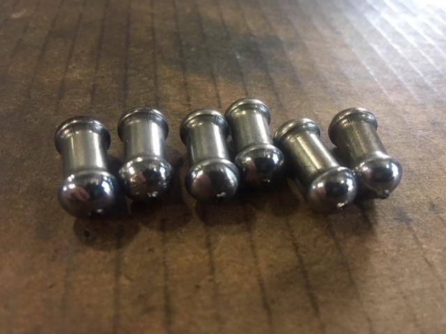

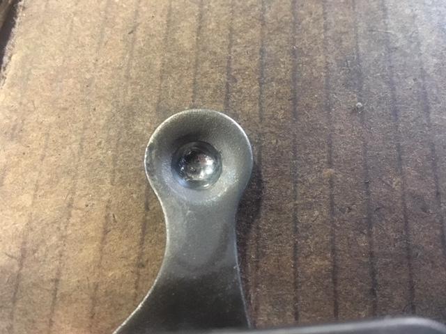

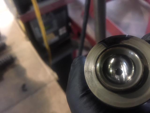

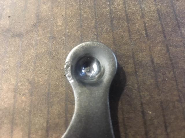

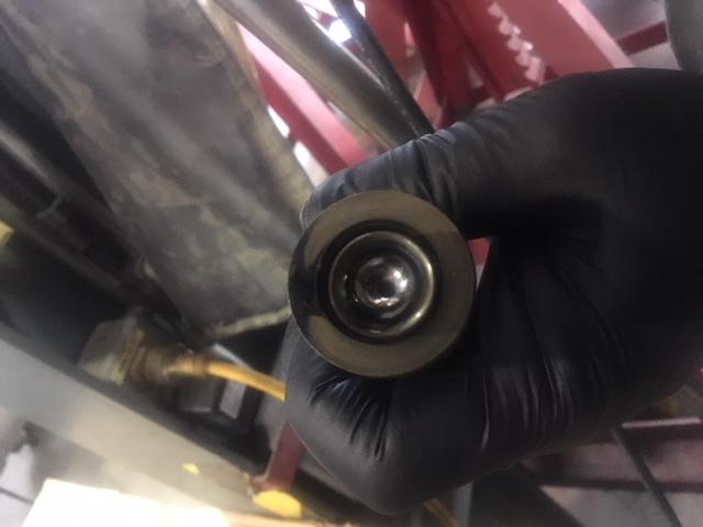

Just an update.  Brought the truck back to Mack for round two of diagnosis.  Confirmed combustion in coolant (even though it looked fine visually)  They tore into the top end.  Ended up getting injectors, cups, seals, new buttons....blah blah blah.....along with a lovely bill.   6500 CAD.  Those are pics of the parts.  The #5 injector was actually BROKEN.  Apparently it was "dancing" around in the cup and letting combustion pass.   Just heading out.  I sure hope with this kind of a repair, this issue is resolved.
