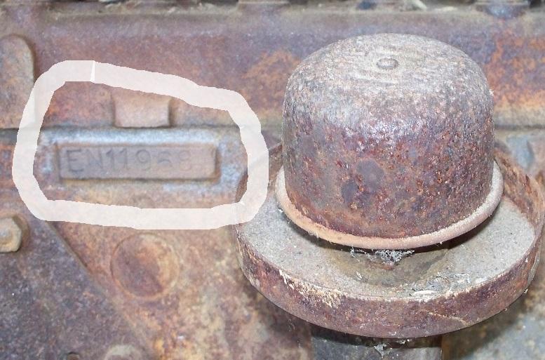

I need all of your knowledge, well because this is not my strength. Short story, 1935 B series Mack Fire Truck with a flat 6. Engine is not original to the truck. We ran a compression test and the #3 cylinder is junk, looking in through the plug hole we can see the piston is cracked.  We are not sure of the engine, some say its a 36, others say its a 43. Markings on the bottom end are M 6(or maybe S) 00A602X. On the top it looks like 827 56. Trying to figure out where to go from here. We are a non profit with limited funds. I appreciate any info and suggestions you all may have.
Thanks.
Compression Results front to back. 100, 92, 15, 80, 98, 78.   Verified #3 with a second gauge.

When looking at the left side of the engine, there should be a machined pad with numbers stamp near the front of the block just below the head.  Check to see if you can get the numbers.  Example: white circle in picture.
There are M6253, M6271, M6290, M6330 engines.

Found it EN 2710-2184
OK.  A Mack EN-271 engine built by Continental (M6271).
