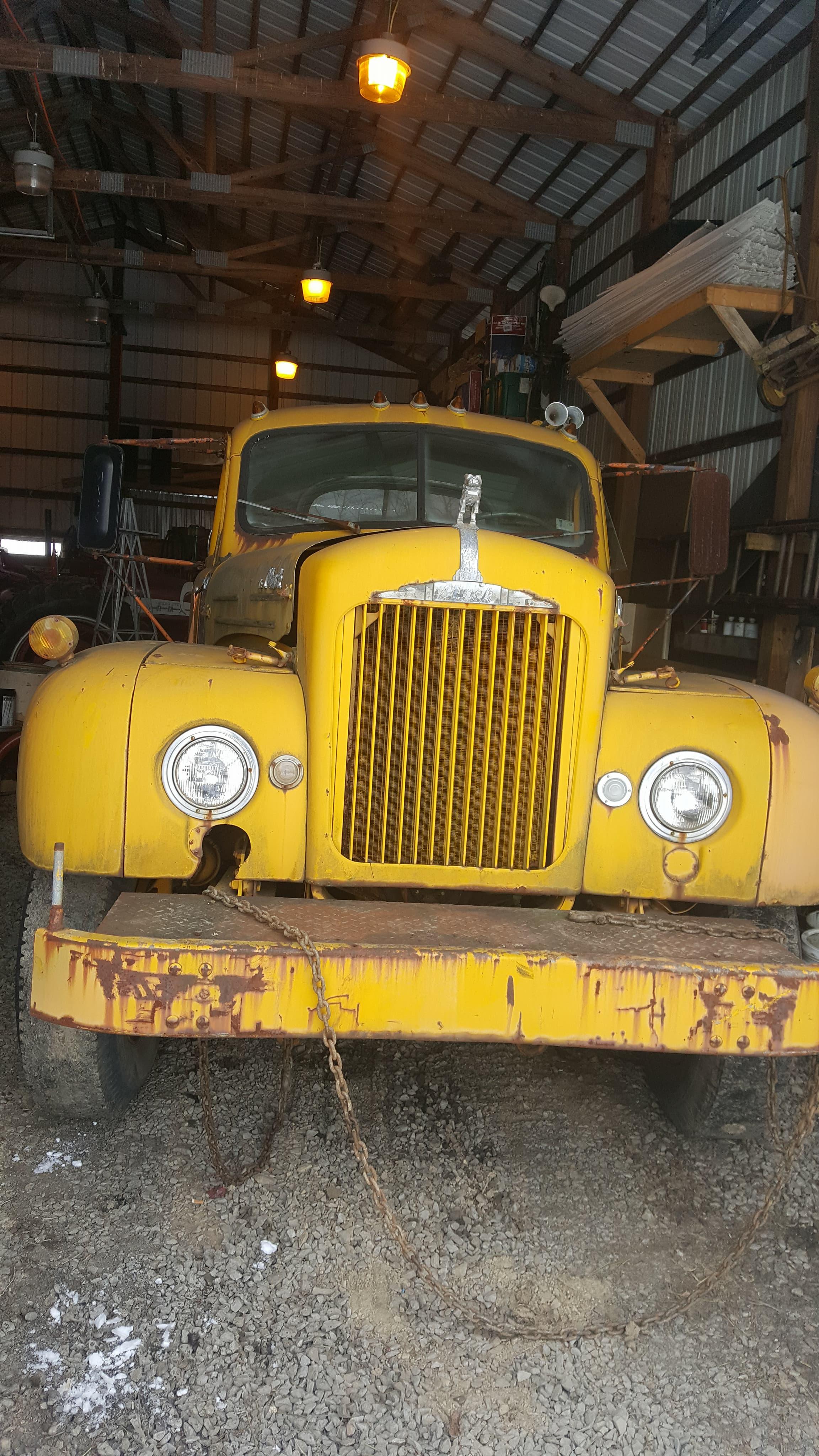

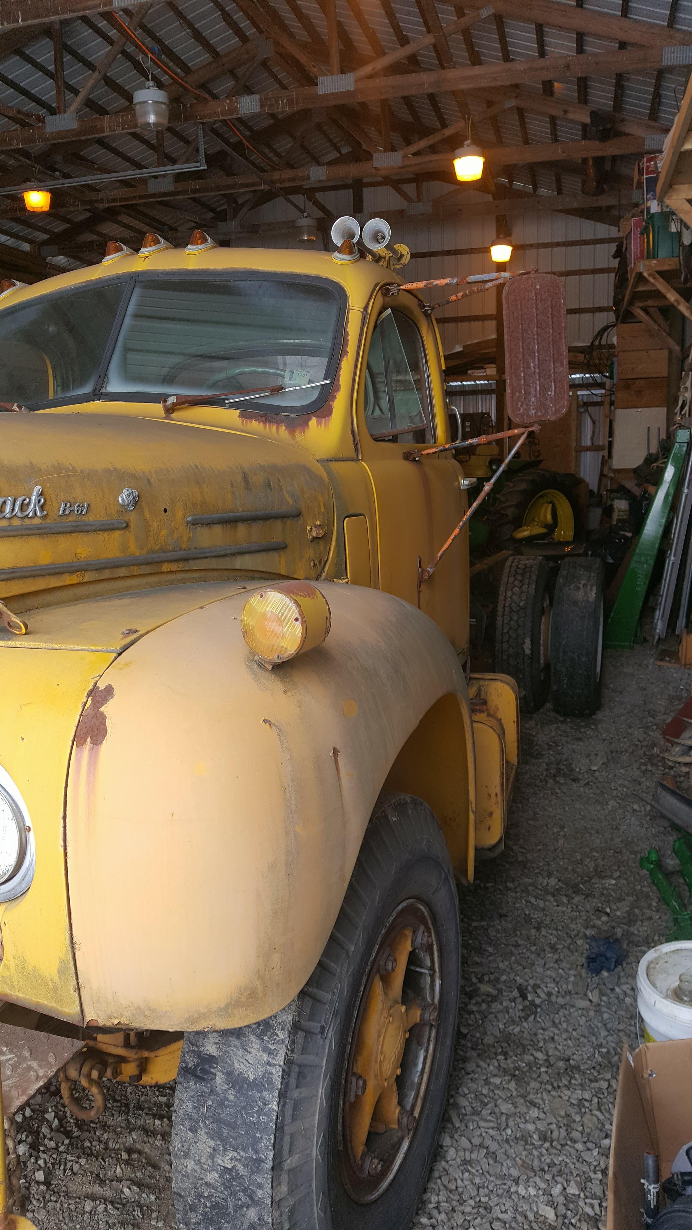

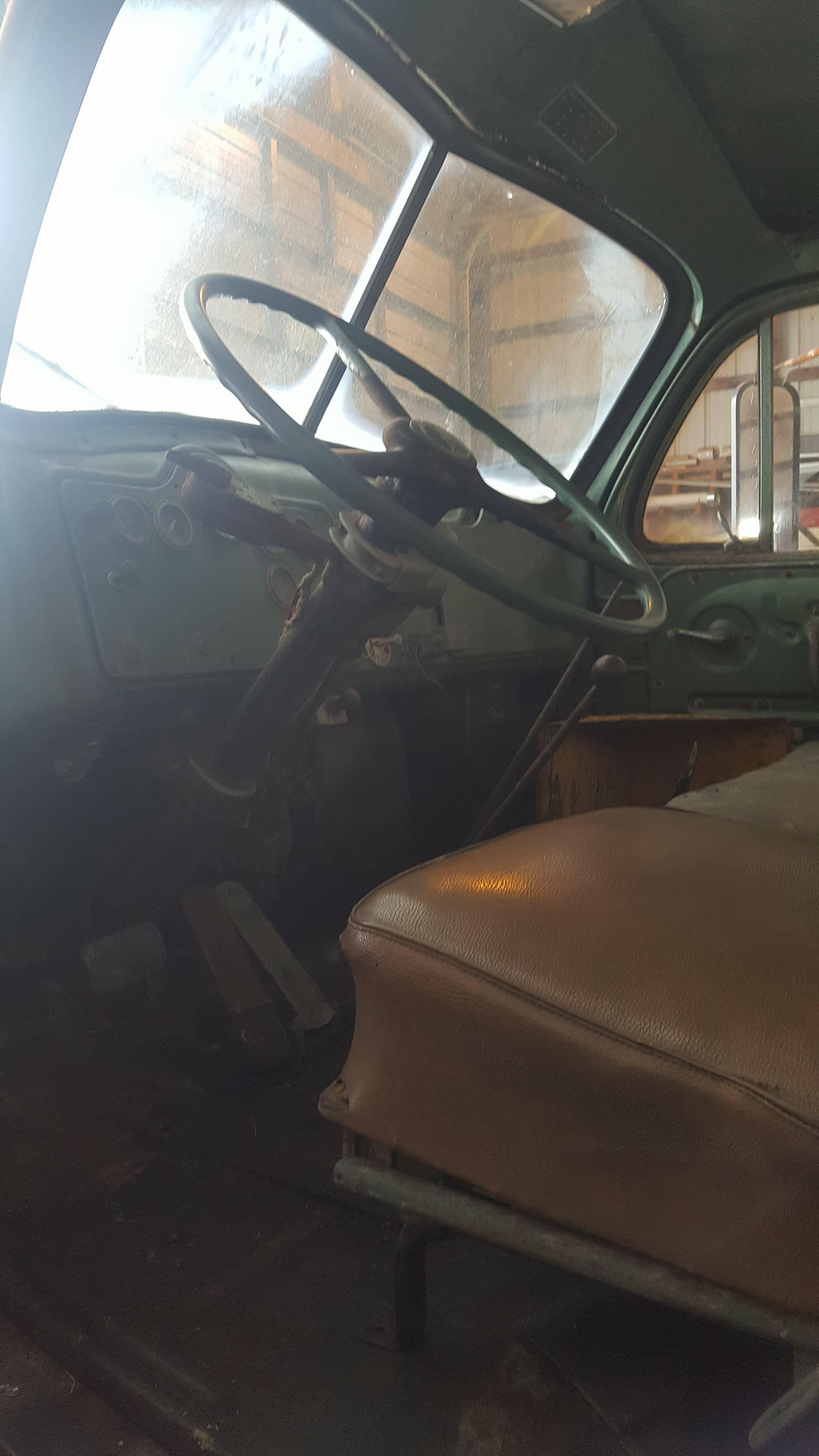

       Tonight was the night! The title has been transferred to my name and I am officially the owner of a 1958 B-61. I'm still trying to learn about this truck. I've wanted a "B" ever since I was a kid and finally it has happened. I've attached pictures of her. Hopefully it will become everything I have hoped for! Not quite ready to start working on her but I couldn't let one slip through my fingers, especially this close to the house. I'm open to any input.
Welcome!  Looks like you have a project now.
A B-61 is a diesel powered truck not gasoline.  Does the VIN match between the door tag and the number on the right front frame rail?

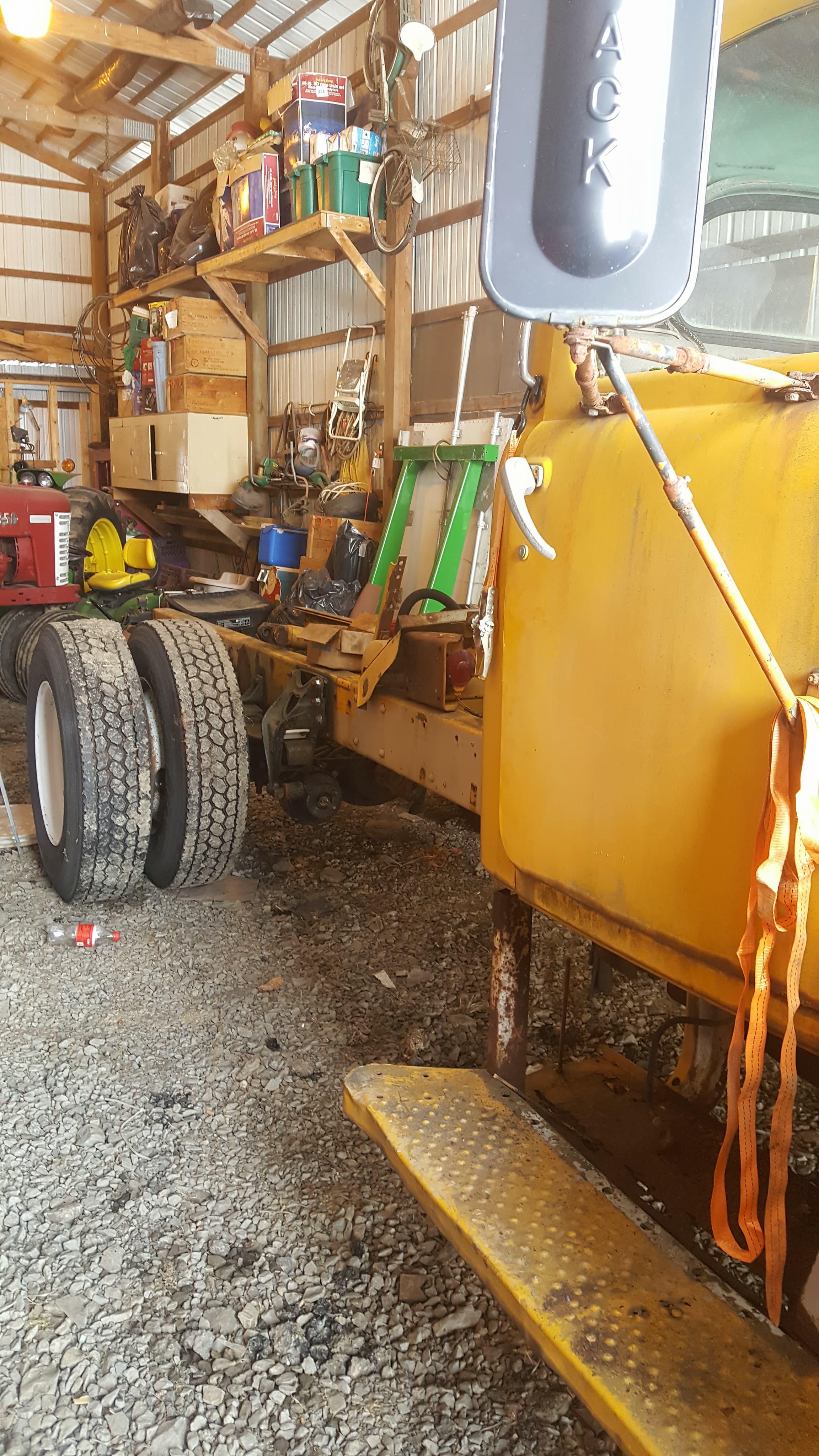

Seeing that it was a tandem rear suspension and also an extended front bumper, was it a cement mixer?

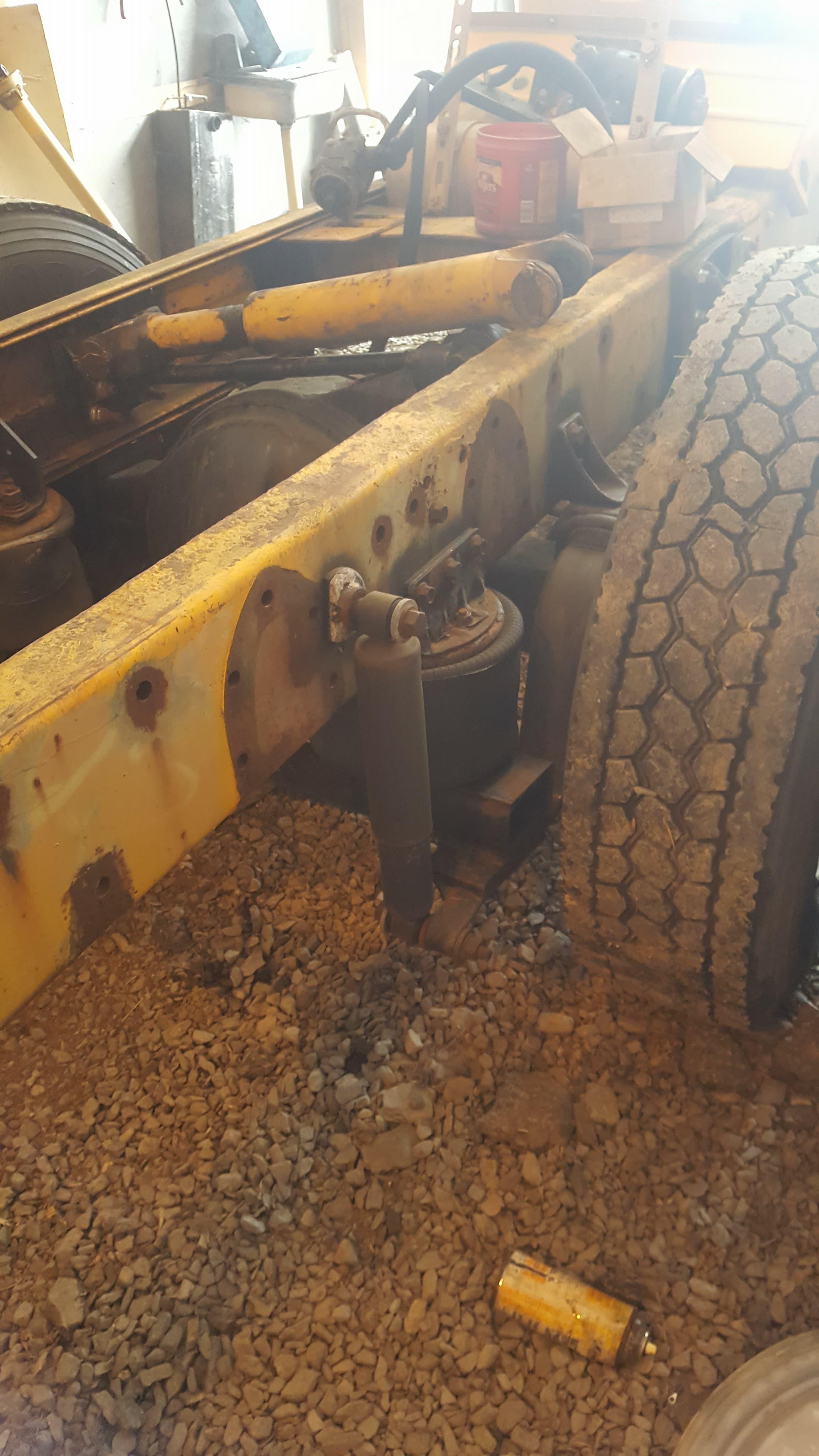

Congratulations on your find. The emblem on the hood is B-61 and as pointed out the engine gas. A little research will tell which has been changed. I like the air bags, means smooth ride when you get her on the road. Good Luck.

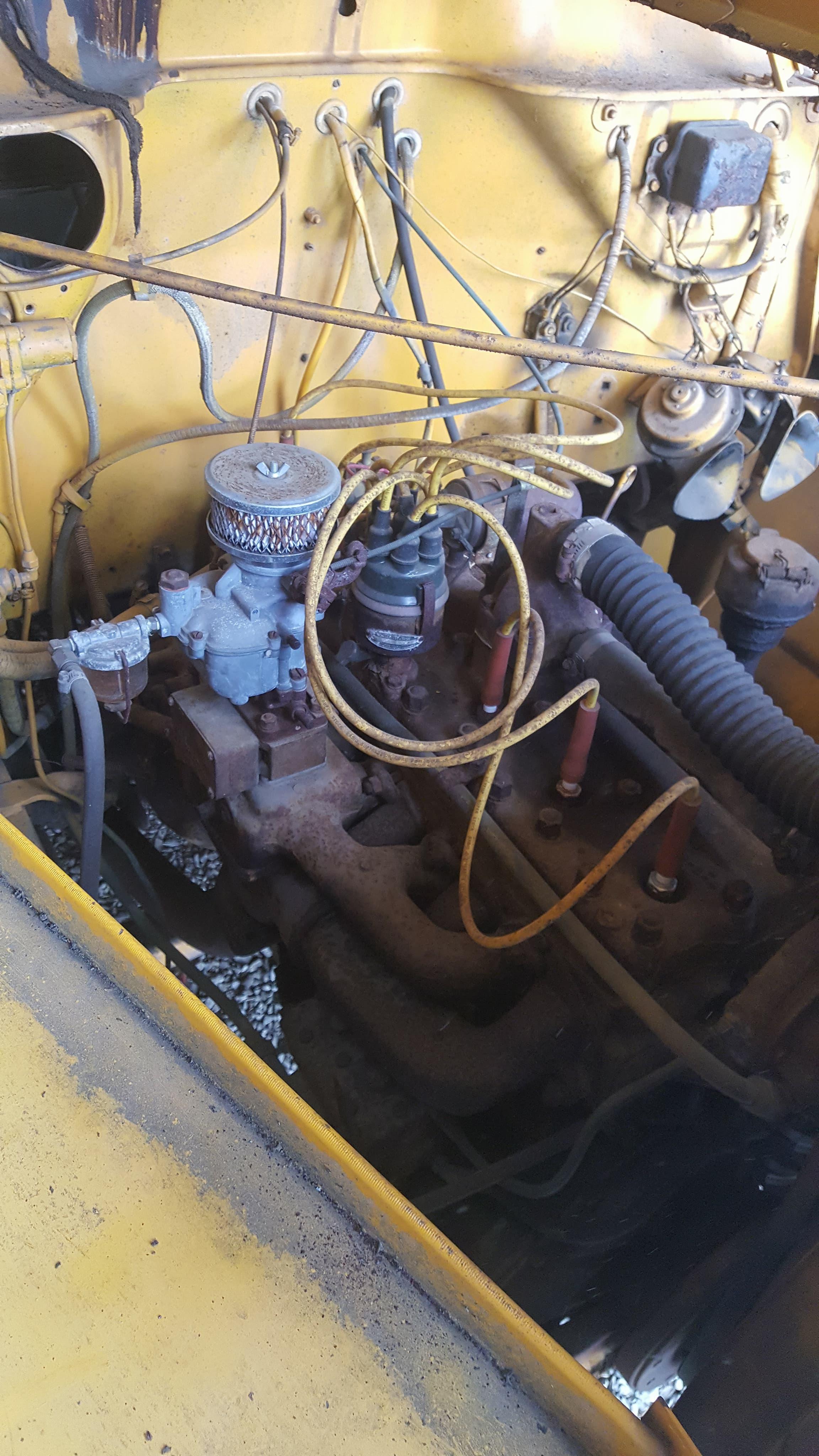

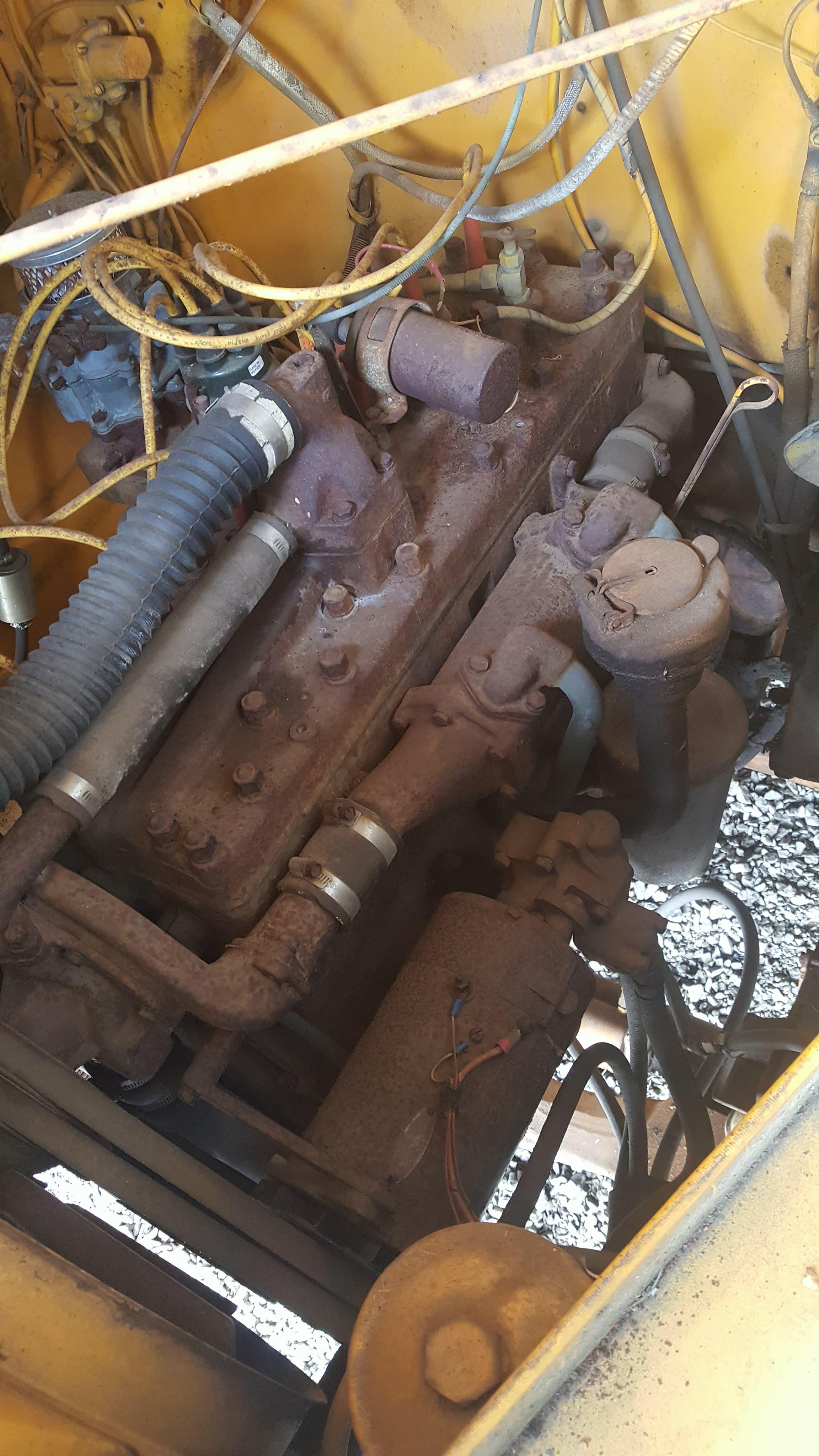

I was told it started life as a cement mixer. It is double framed. I need to dig into it more to figure out which gas motor I have. I believe it is the Continental 6 cylinder. It's married to the quadraplex 5x4. Couldn't pass it up for how solid it is. I'd love to switch it back to diesel and as cool as it would be to keep the trans, maybe put an 8LL in it. The suspension on the rear was changed two owners ago and basically left as is by the owner I got it from. He included a newer style front axle to complete the conversion.

Awesome info, thank you. It appears that I do not have a B61 but rather a B-42. VIN reads B42S15224. Regardless, I still love it. I can't wait to get it home. Also, it has the power steering setup that's driven off the rear of the generator. From what I gather, that's a hard to find option? Maybe it'll become a B-61 someday 😉
