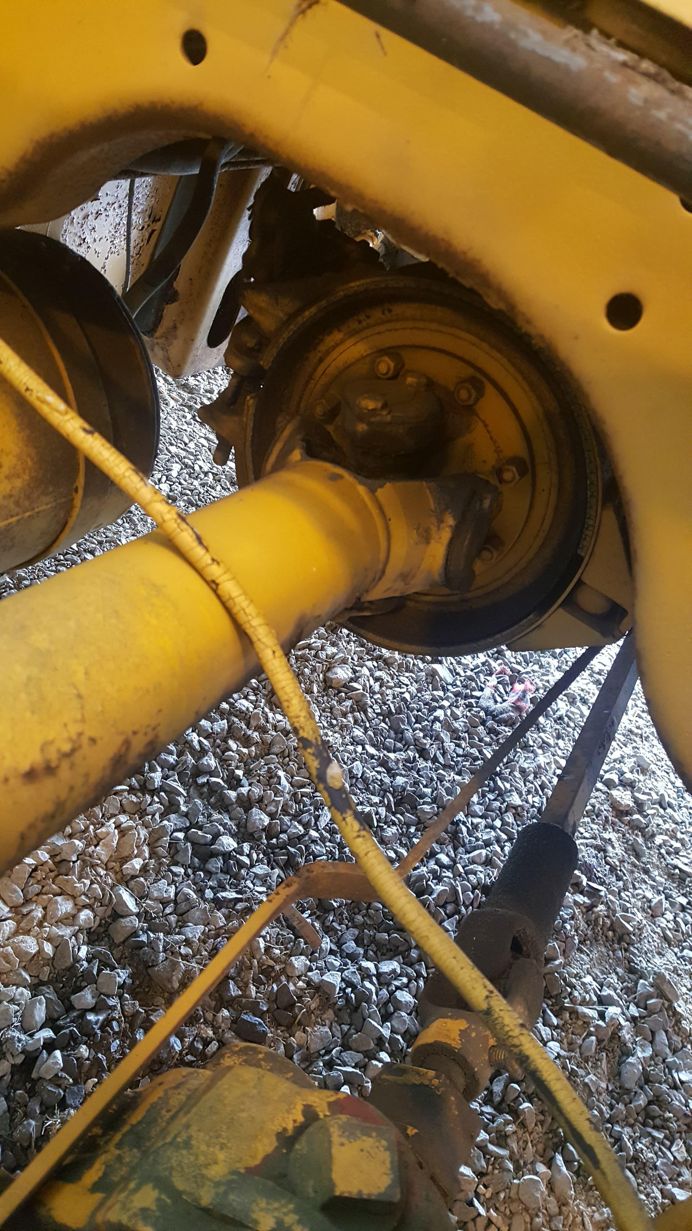

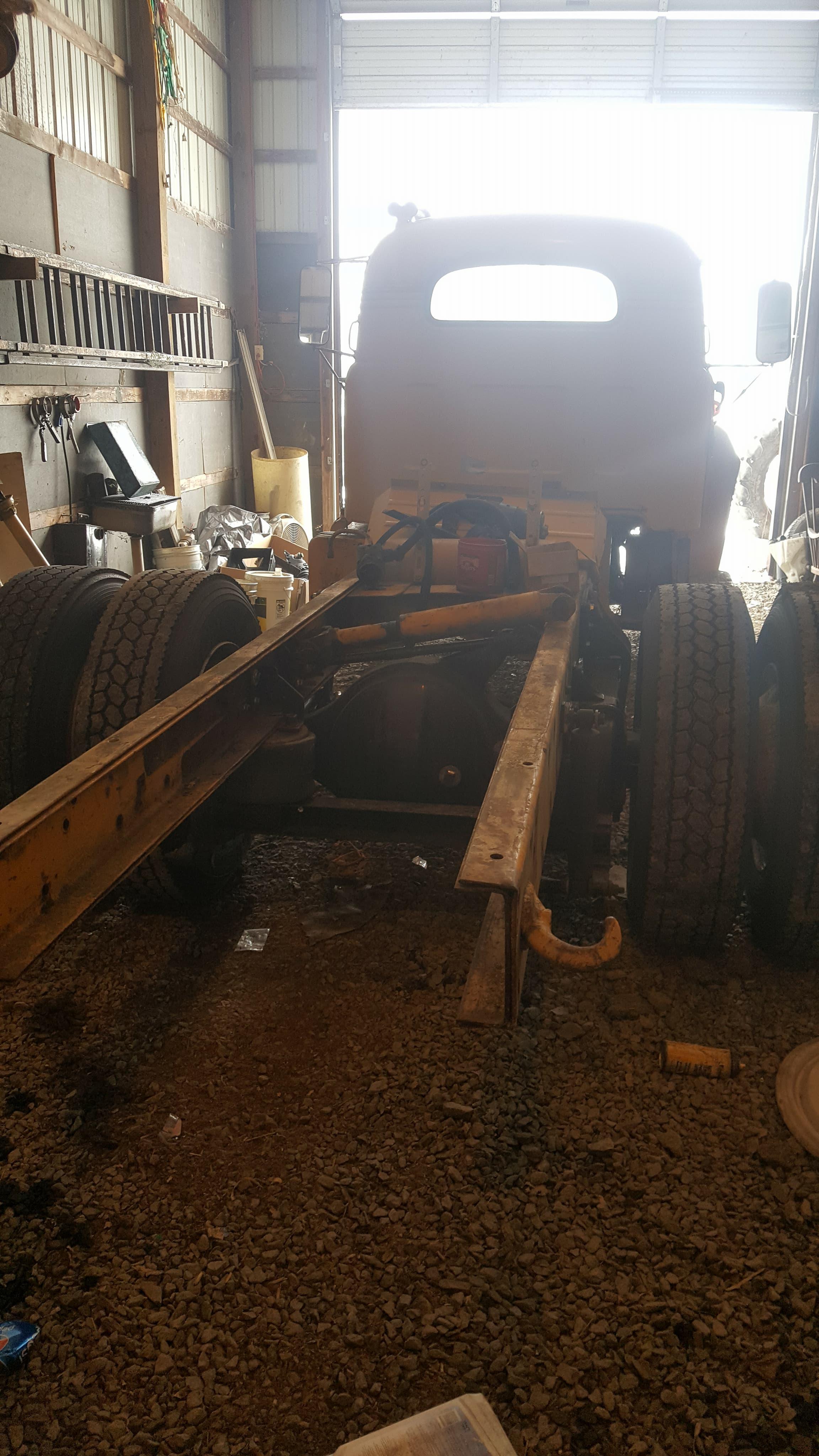

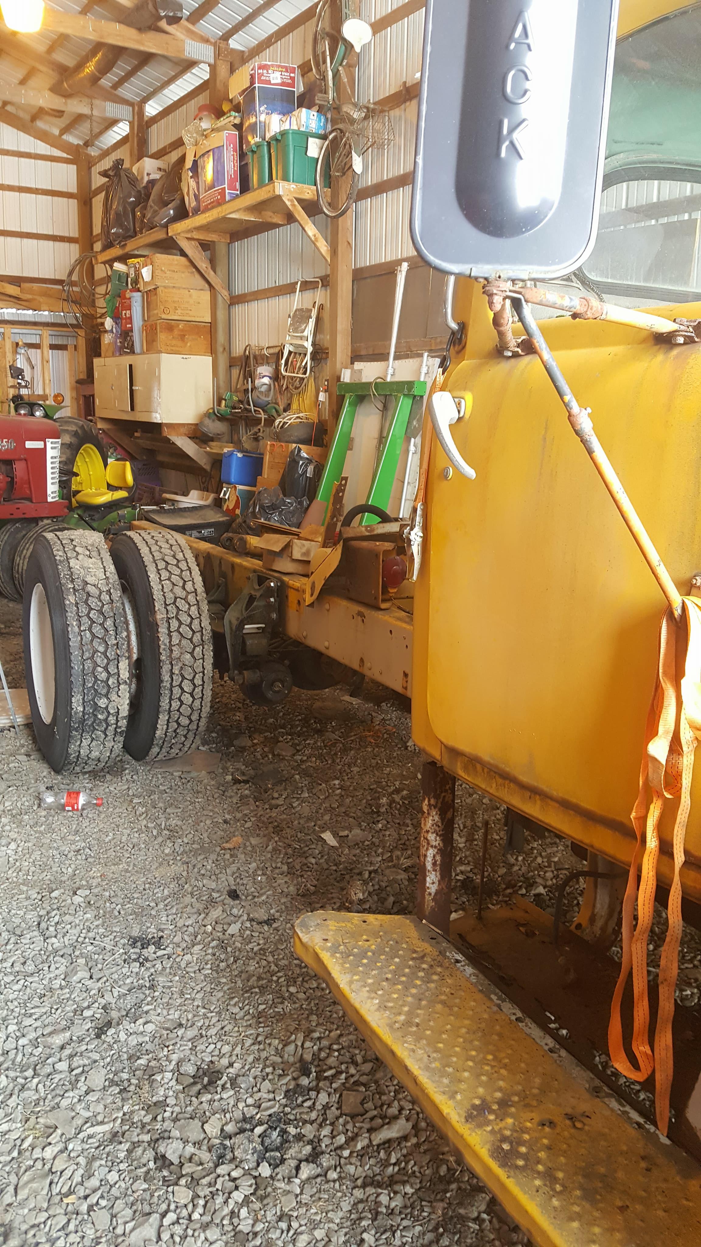

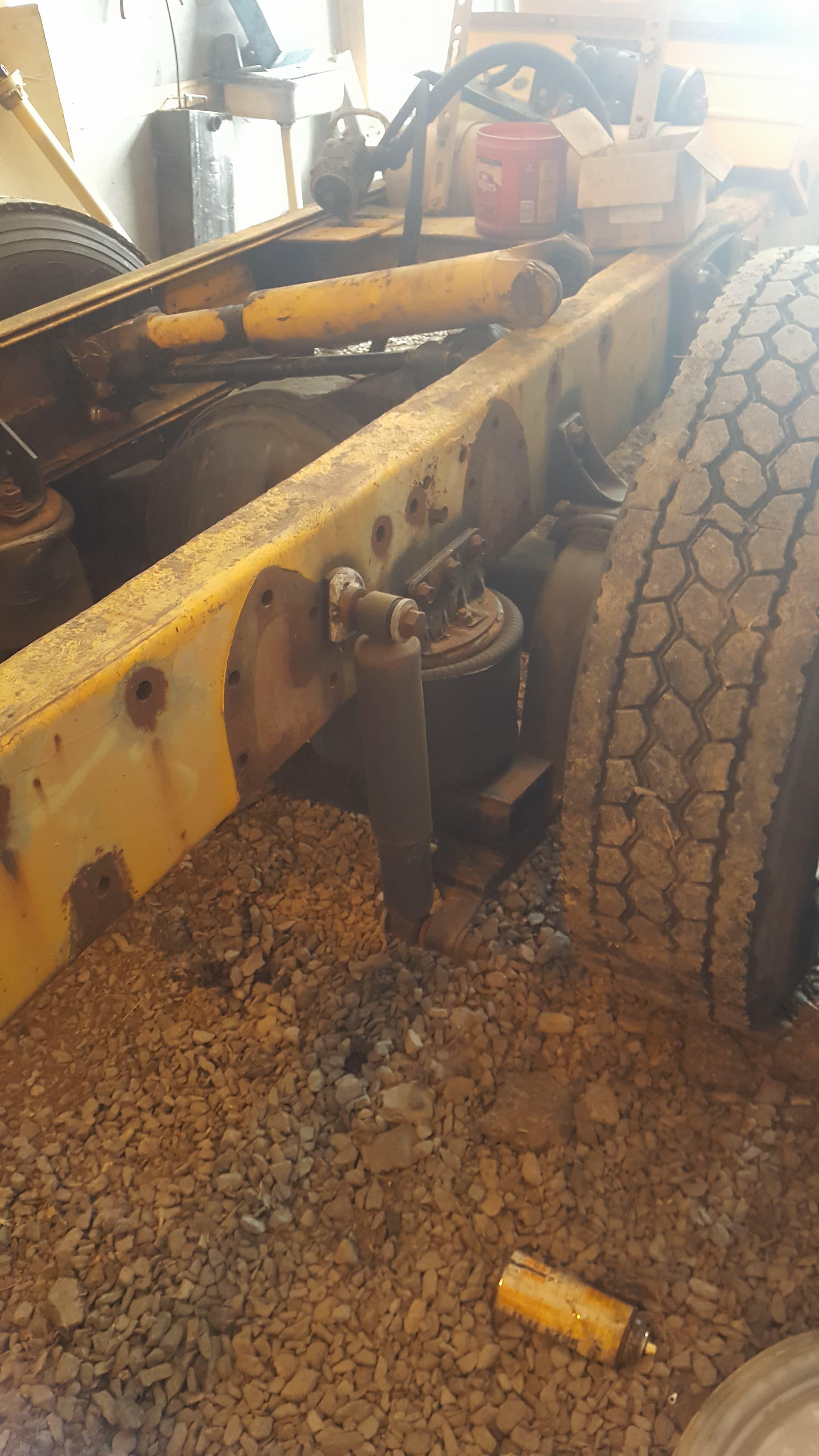

I just purchased my first B. The previous owner (2 owners ago) ditched the rear axles and swapped in a Hendrickson suspension. I think it's off of a Freightliner by the looks of it. None of the airlines are hooked up and also the driveshaft needs figured out. Best I can tell is the pinion angle is off from the original carrier bearing. Has anyone ever attempted this conversion? Would it be easier to just go back to the OE setup? Until I get it home and look at it, I'm not sure what the gear ratio is. It's a Spicer rear and definitely heavy. I get the direction the previous owner was heading but with the gas motor and quadraplex, I'm not sure how well that's gonna fly... Thanks for any guidance.

I put a single axle airliner air ride from a freightliner under my B and it drives  and rides very nice.    Mines a 4.30 gear ratio with my diesel and dueplex it maxes out at 65mph at 2300rpm with 12r 22.5 drive tires.   Drives nice bobtailing but can definatly tell when it's loaded.
You air ride should only take 1 airline to supply it going to the leveling valve then tee-ing off to each air bag.

Revisiting this post now that it's finally home. The rear that was swapped in is an Eaton housing with 4:11's. Working on cleaning the mildew off of her yet and learning more and more about her. Got the 401 running. Mechanically it sounds quiet. The carb could definitely benefit from a rebuild though.  Everything except the rear appears original to the truck.
