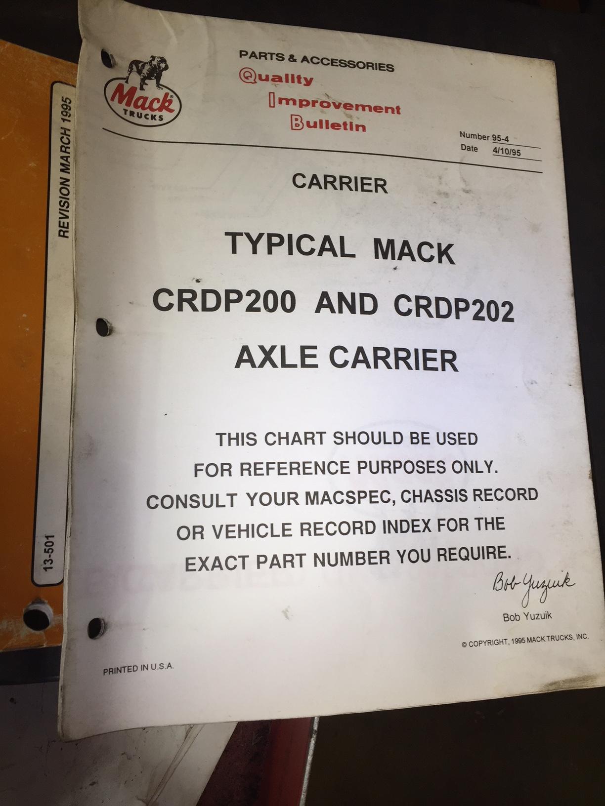

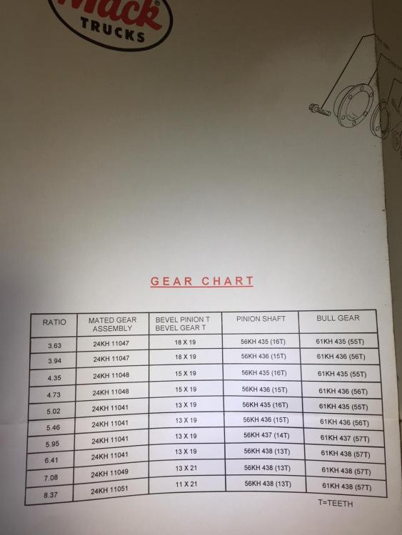

Check your ratio, tooth count top and bottom, on the failure and on the received rebuilt carrier......... trust no mortal !!!

thanks for the screen shot on the tooth specs. ill be sure to check!
