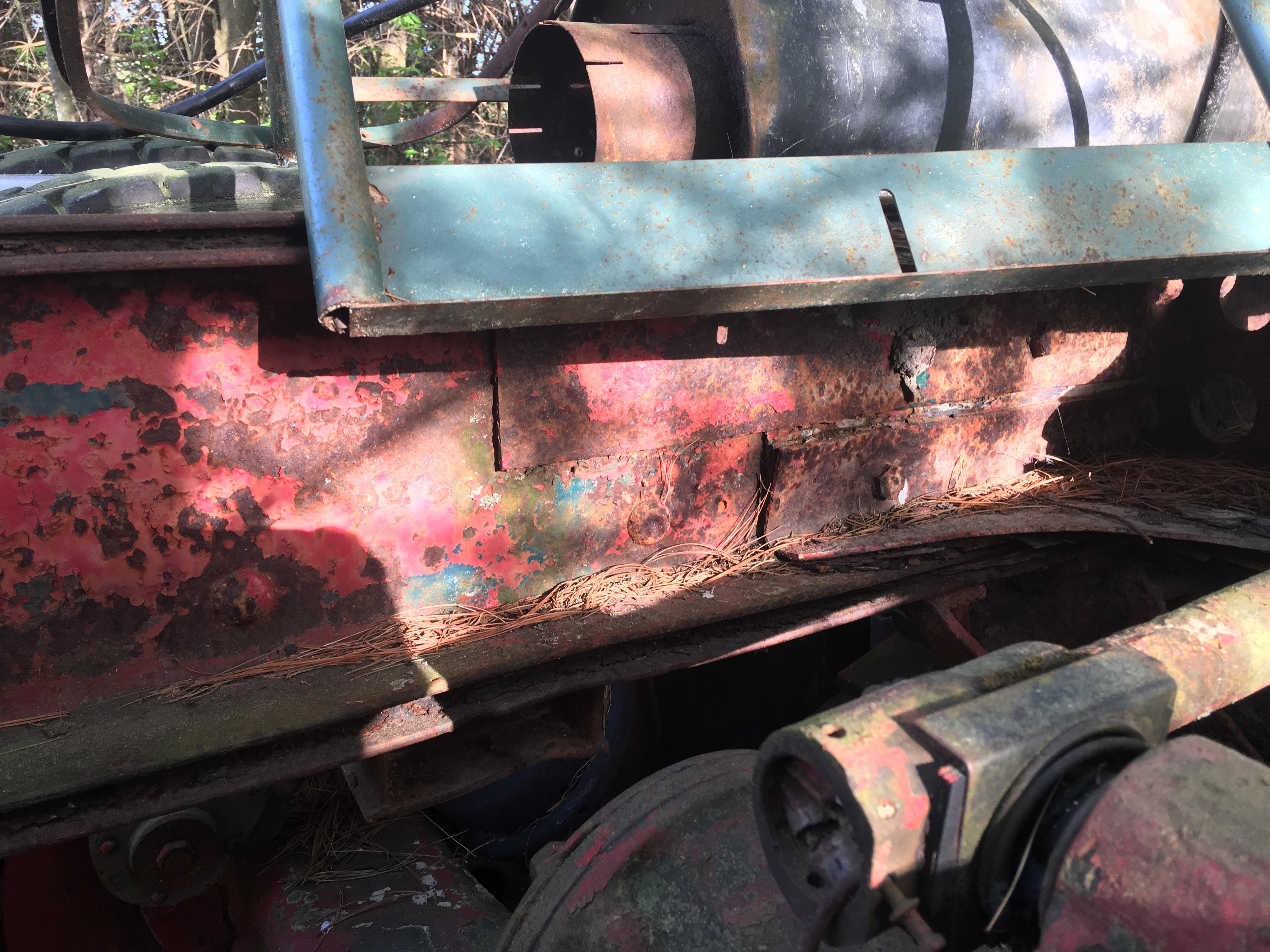

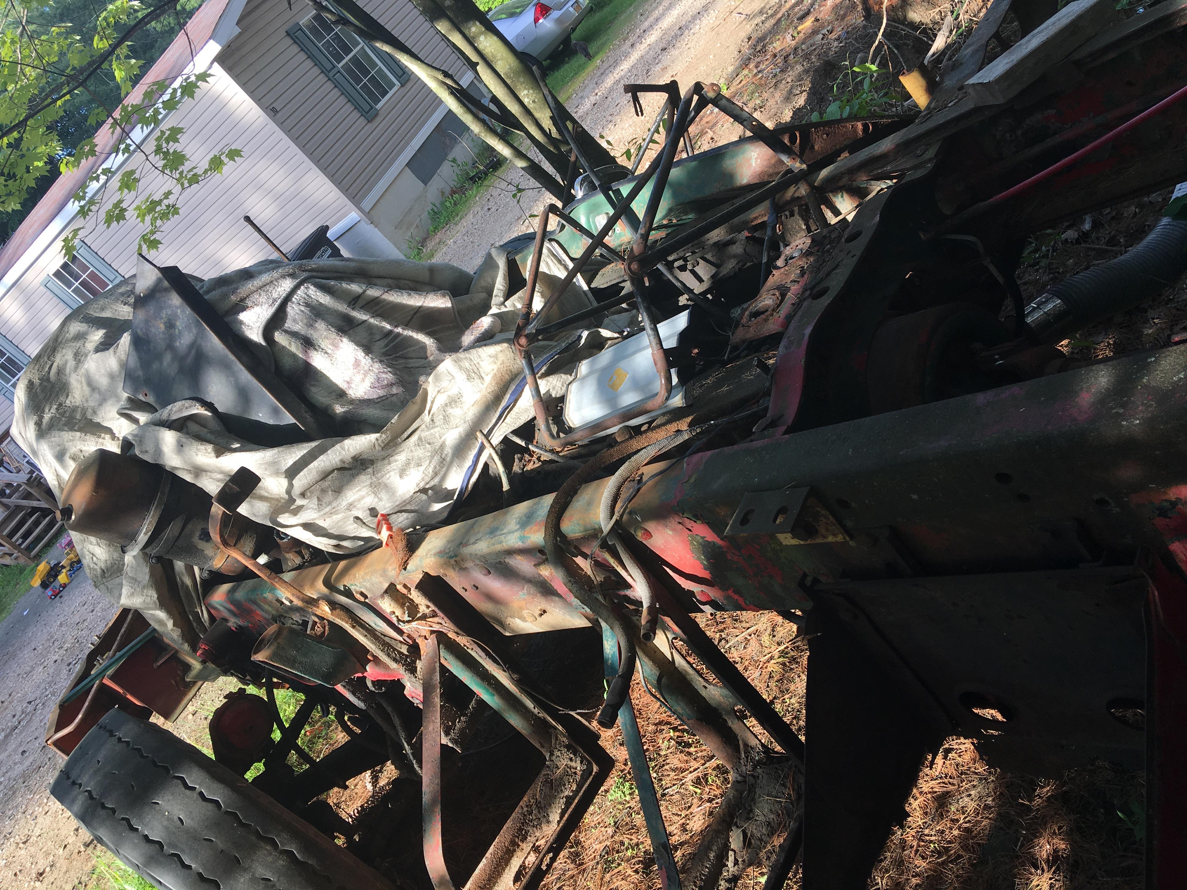

Started the easy part today, found a few problems to fix when it goes back together. The front of both genders was cob jobbed to the radiator support so I may try the piano hinge idea for the front fenders. If anybody wants a 9 speed duplex or anything off the 401 send me a pm. I don’t plan on keeping them around too long after they are yanked out.
