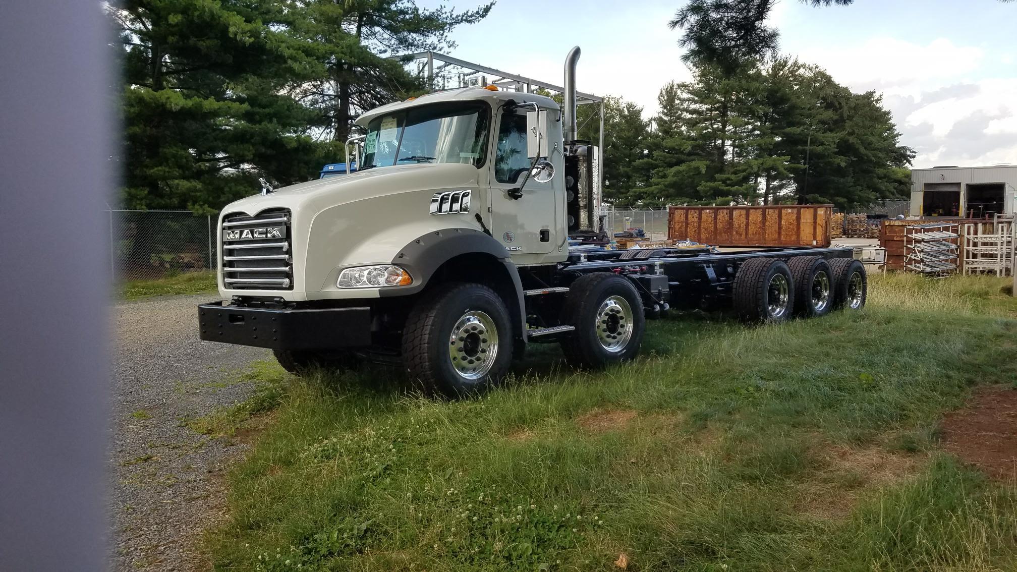

Nothing really Super about it. It would be best of they had a cooler model designation then just a Granite though.
 Fairly common up here. Most for the Canadian market are ordered and built as single steer with factory tridem drive and have the second steer strapped to the frame for delivery up to Simard suspension in Quebec. Trucks ordered south of the "great white north" have the twin steer factory installed at Macungie. Simard I believe holds the patent on the twin steer design and has a deal with Mack/ Simard for the shared installs.
It's a set up commonly ordered for maximum gross hauling ordered by a few cement companies here in Ontario.
The ones I've worked on are MP7 powered with Allison auto trans and tridem drive on air ride.
Replaced an SCR can on a "Super Granite" last week. For as big a truck as it is with a mixer on its back, that MP7 and Allison go like heck.

That's the one. Saw a dump set up on U tube like that. Would make a nice heavy haul tractor if  Volvo allowed Mack to have a big six or V8.
The Dump set up on you tube you may have seen was a deal between Mack and Simard to make large tonnage haul trucks in a smaller package....i think they were called Dramis...the first trucks built were on Granit chassis but Simard decided to go with Kenworth and Western Stat as the Chassis supplier.
The truck could haul 55 metric tonne if I remember correctly.
Had an MP8 engine with Allison trans.
