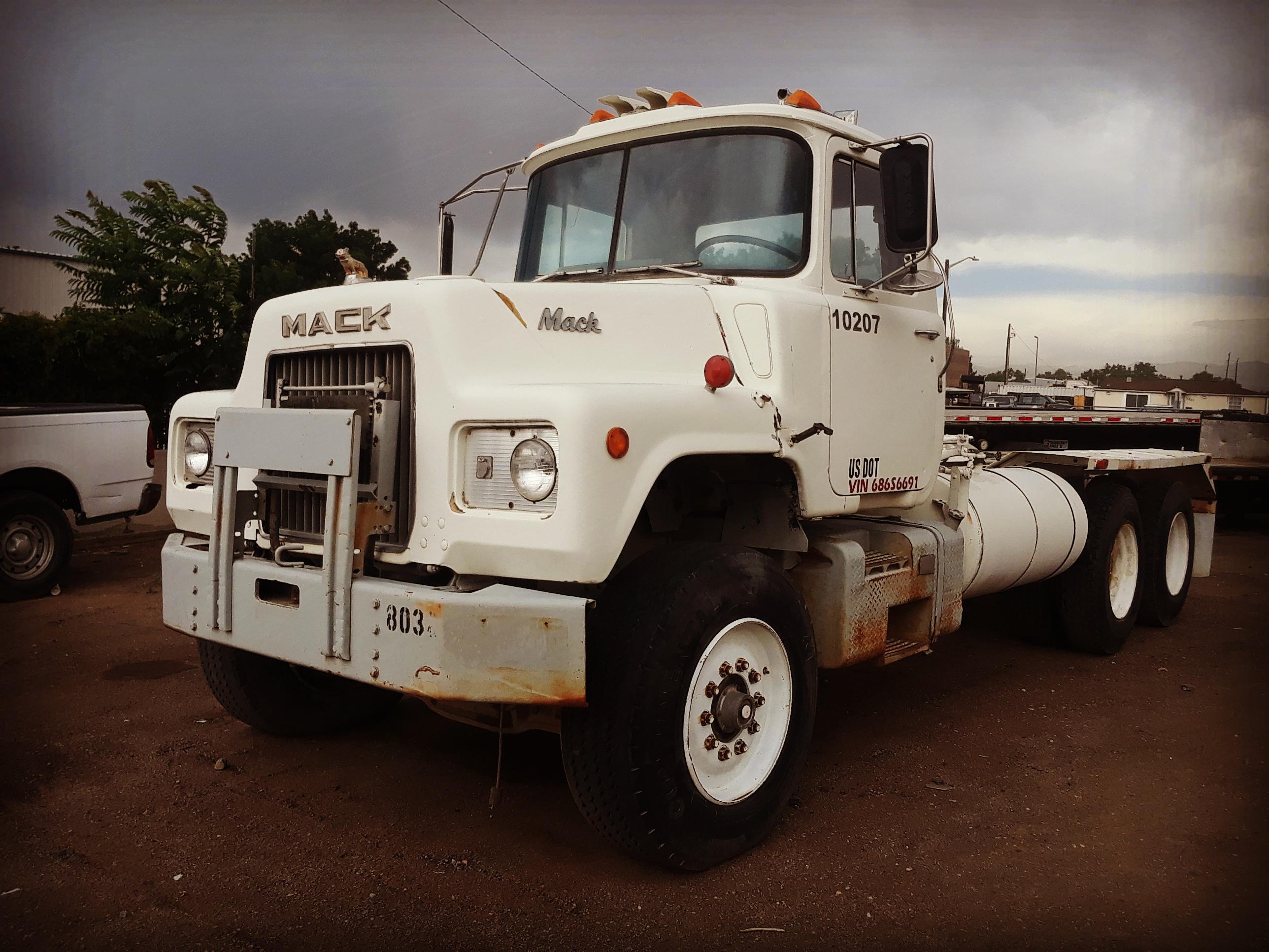

Vicky is a 1989 DM686, ex-mixer chassis that I bought as of last week, clean title, running and driving (if a tad low on air pressure in the tires). I bought the Mack for the purpose of building a heavy spec local 4-axle tractor.

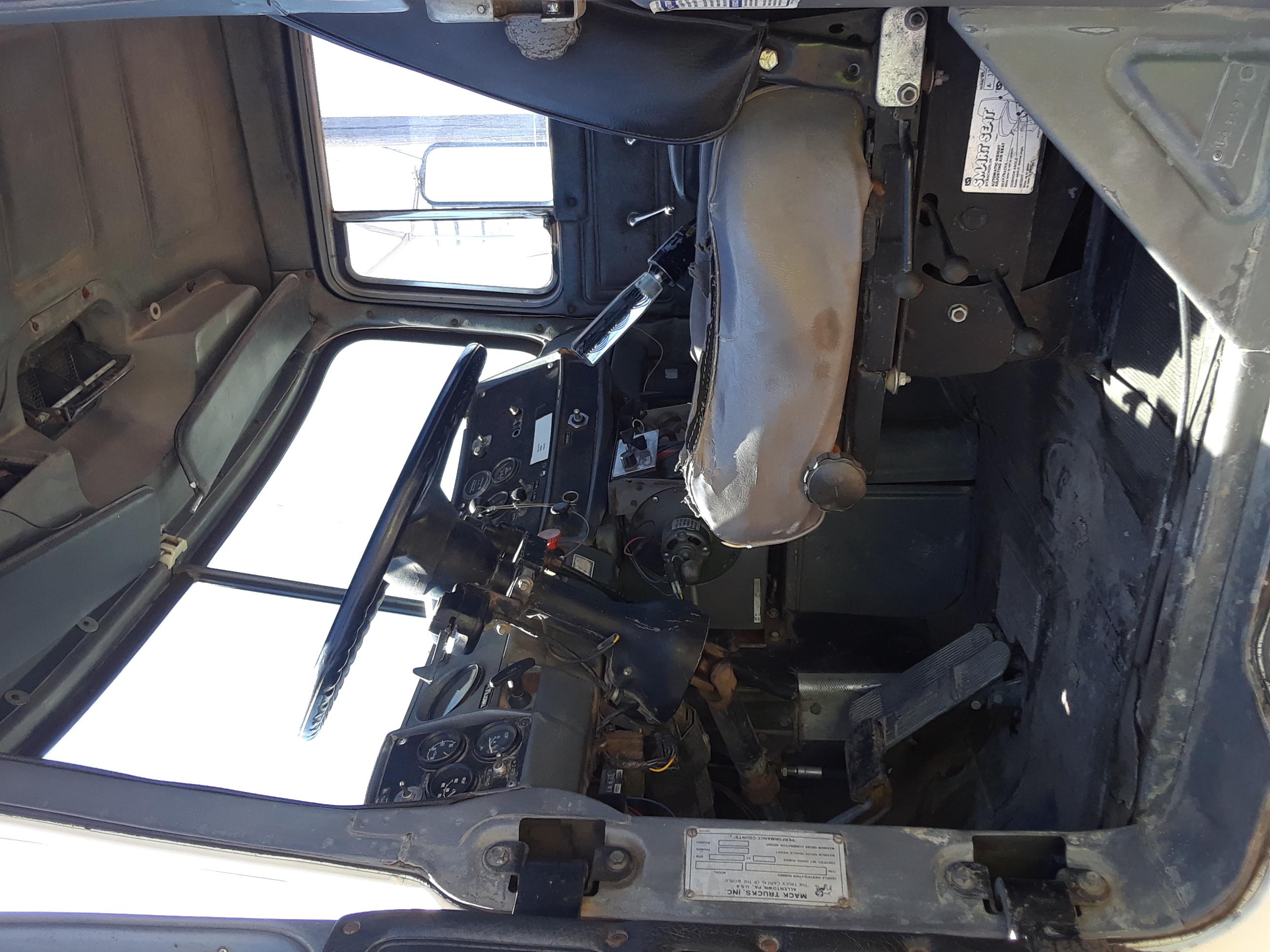

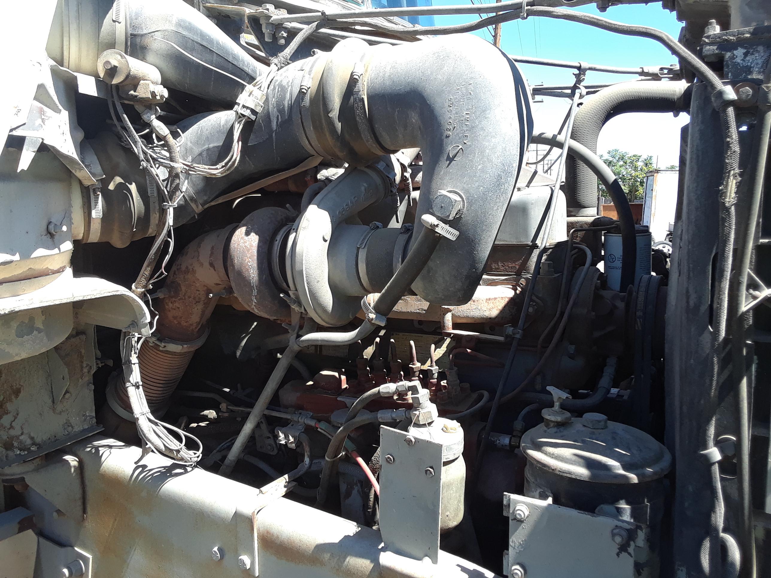

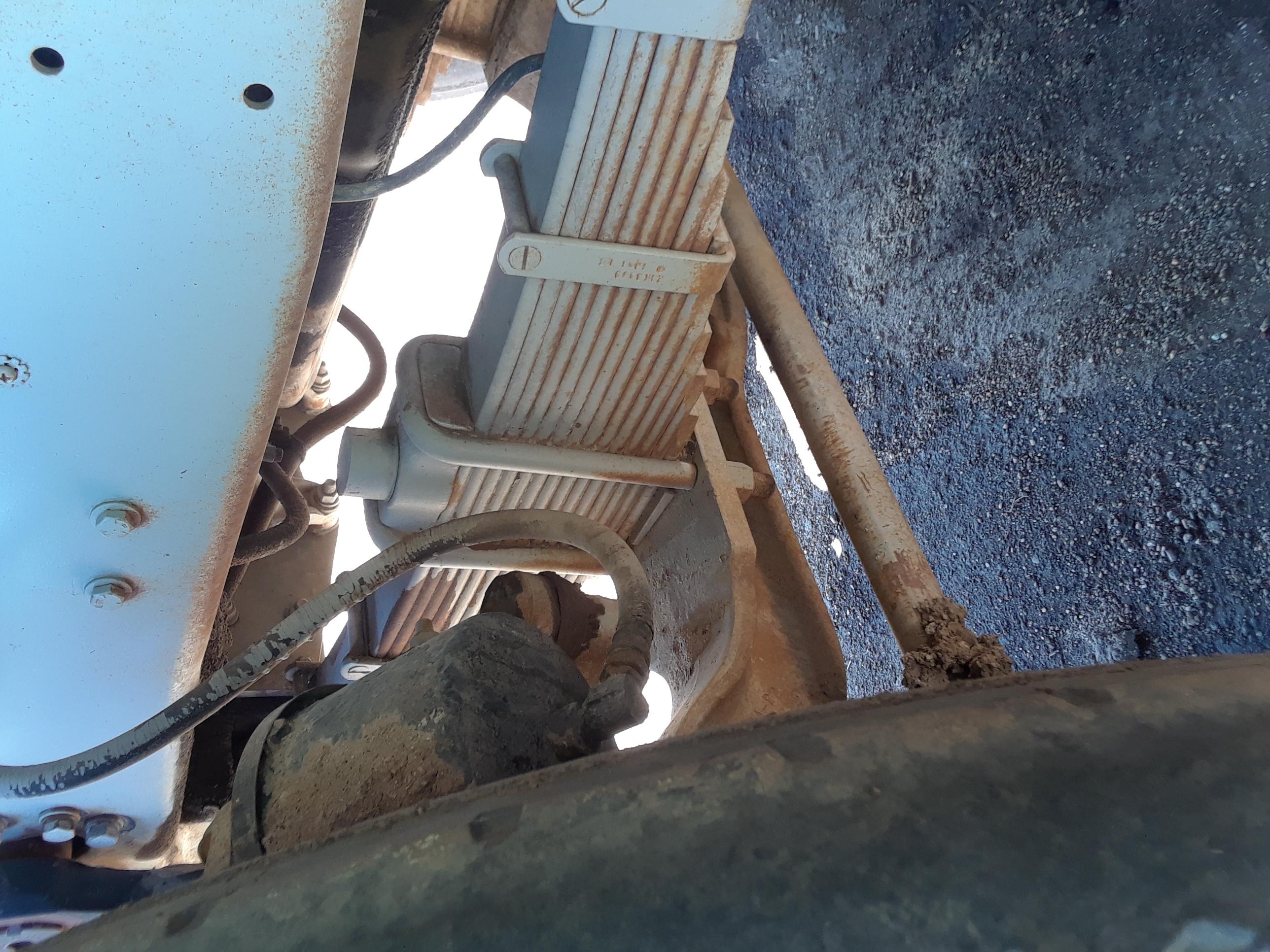

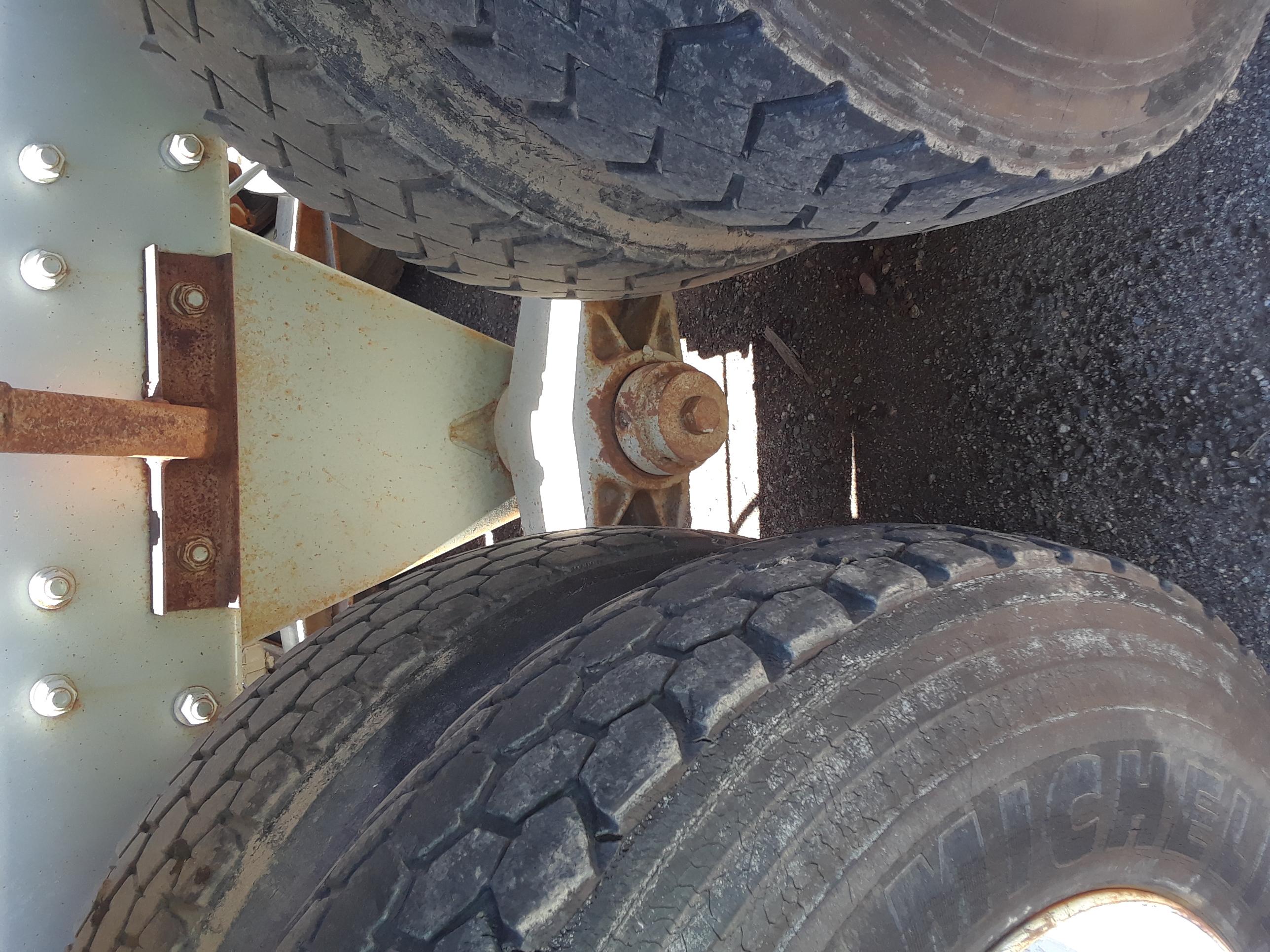

I've looked over for rust issues thoroughly. Luckily, as a western truck (it operated out of Baggs, Wyoming when it was a mixer) the truck lived in a much drier climate than a lot of Mack's out East do. I've found some surface rust areas around the cab, but, nothing cancerous.
The most important aspect, the frame, is very clean. No decades old concrete stuck on or heavy rust. The cab and hood have a couple rough spots, nothing unfixable though. The main center bushing for the walking beam appears to be in good knick, the control arms will need rebushed, but that's a pretty minor job.
Interior wise the seat is a little rough, but a peak behind the dash shows good, if dusty, wiring.

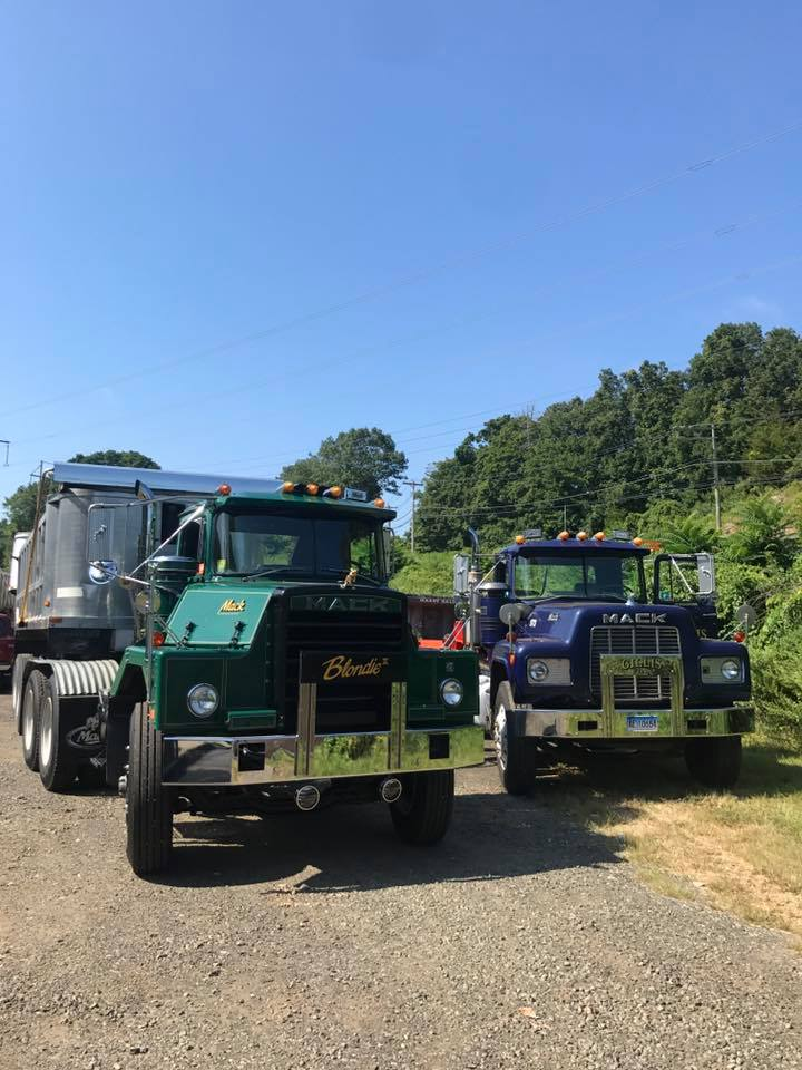

17 hours ago, gxbxc said:

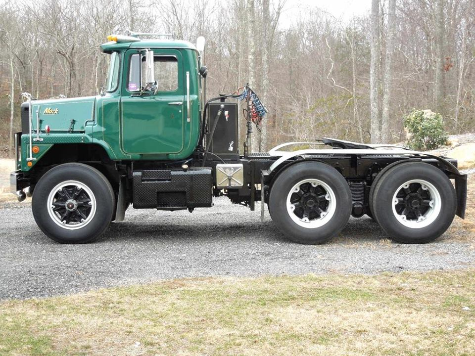

Black dog where did the hard nose DM come from, use to see a lot like it when I lived in Ct, and it is one nice looking truck
It was a tri-axle then a crash truck then the guy I bought it from turned it to a tractor changing the rears ratio does 71-mph F.P. RYAN aka Defelice the body went up hitting a bridge bending frame and hitting cab a couple months old  new cab level 3 dual air seats A/C .
