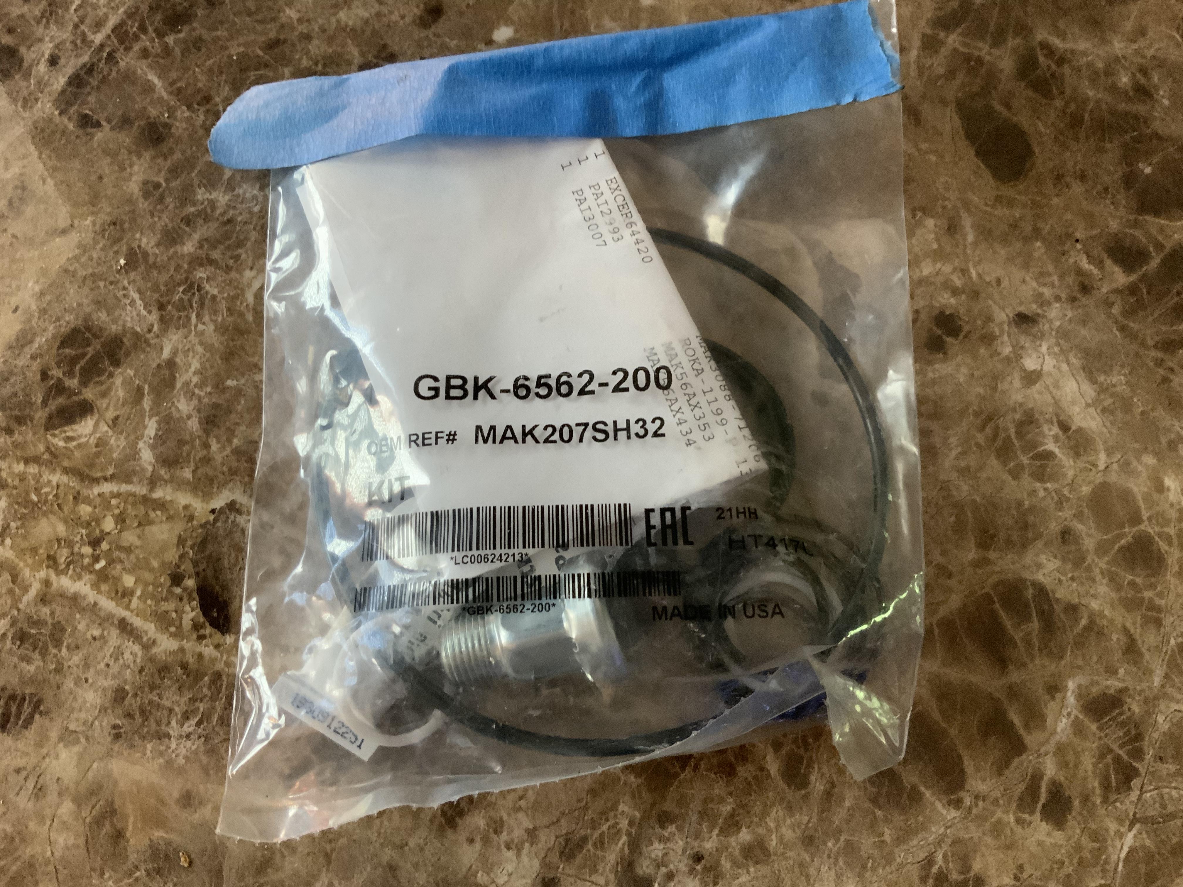

Please let me know if you can allocate the rebuild kit #. I ordered a standard o ring kit plastic washers and a snap ring kit to ensure I have a large selection on hand. But would prefer to know I have all I need with a kit can piece it together. Thanks in advance!

Here it is this is a pai kit,not sure where I ordered it just google it you’ll find it,this not only fixed the air leaking from the exhaust port but I also had a problem shifting into reverse when it got cold out like neat freezing,this also fixed that problem..let us know how it works out,like I said it’s any easy fix but use the kit,the o rings are a little different then you’ll find elsewhere..
