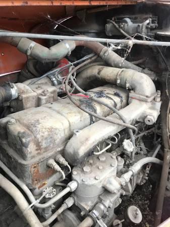

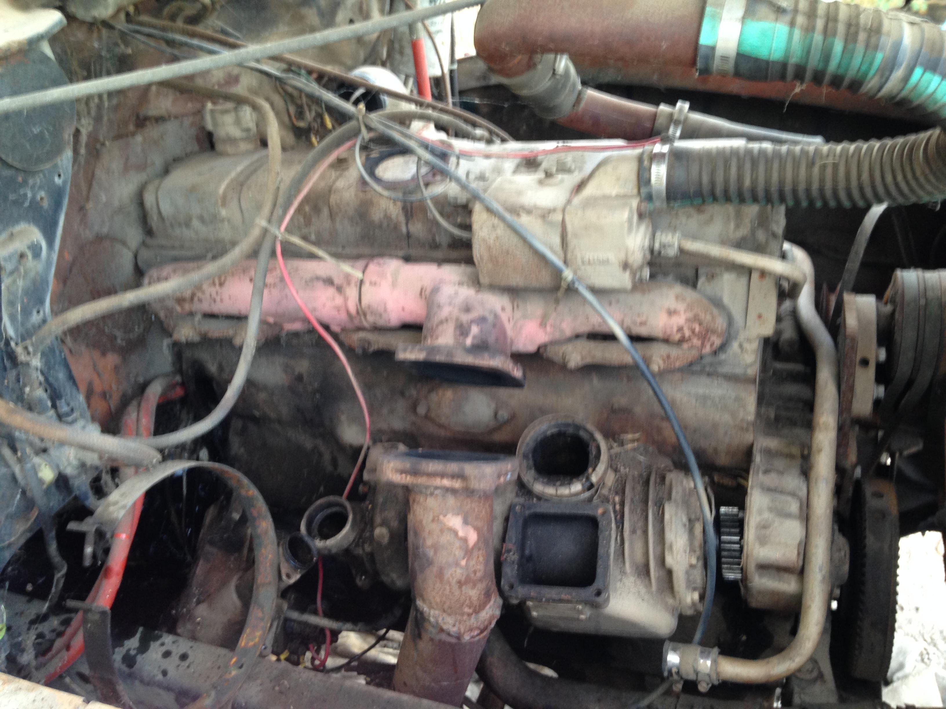

That is an old J series Cummins, With the blower it could be anywhere from 180 to 210 HP. Haven't seen one of those for many years.
They were commonly called the C-180, C-190... etc. depending on the HP rating. I saw one once with a gigantic oil cooled turbo that only had a 160 HP rating.

17 hours ago, mrgumby said:
I drove a truck with one of those motors in it about 30 years ago.after 12 hrs of driving my ears were ringing. It was a screaming mother  loud as hell
Worked for a company that gave me a White Compact with a C-180 with a blower for a service truck, man that thing could howl. Had a 510 roadranger with a loooong stick (no linkage), on bumpy roads you had to be in a forward hole with the stick or it would jump out of gear. I remember hot and noisy was the best description of the cab.

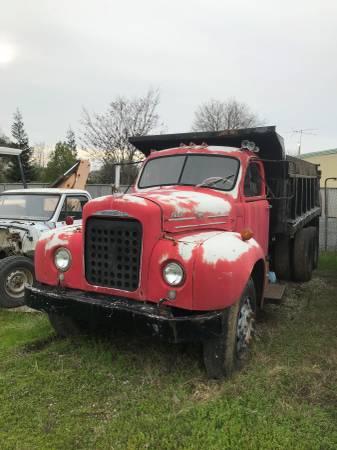

Welp looks like I need more than a radiator. I went to start it only to find out the engine is stuck. I tried turning it by hand, it turns very little one way and comes to a dead stop. Turns back a little and same thing comes to a dead stop. So I'm on the hunt for an engine. Anyone have a cummins c160 or c180?
https://www.bigmacktrucks.com/topic/53823-info-needed/#findComment-402674
i dare say that truck is probably a B42 or a B62. both commonly repowered with 160 and 180 cummins motors years ago when the gas jobs let go. hard tellin if your radiator is original to either model. they were different between a B42, B62 and the original B61 diesel radiators came in a small one or the larger radiators that completely filled the horse collar was fittin to B61 turbo trucks or trucks with 711 motors
Its definatley not the original engine. The firewall was cut for it to fit in there.

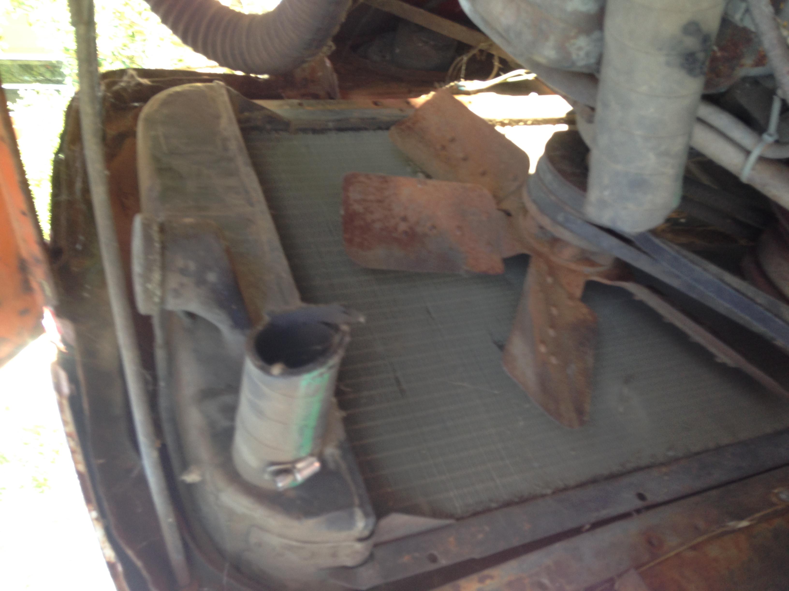

On 7/18/2018 at 8:34 PM, yarnall said:
I have several radiators that would fit behind your shell.   I'm in PA.  Where are you?
 I'm in California. Here's  what my radiator looks like. I'll get better pictures tomorrow. I don't know why they upload upside down and sideways.
https://www.bigmacktrucks.com/topic/53823-info-needed/#findComment-402943

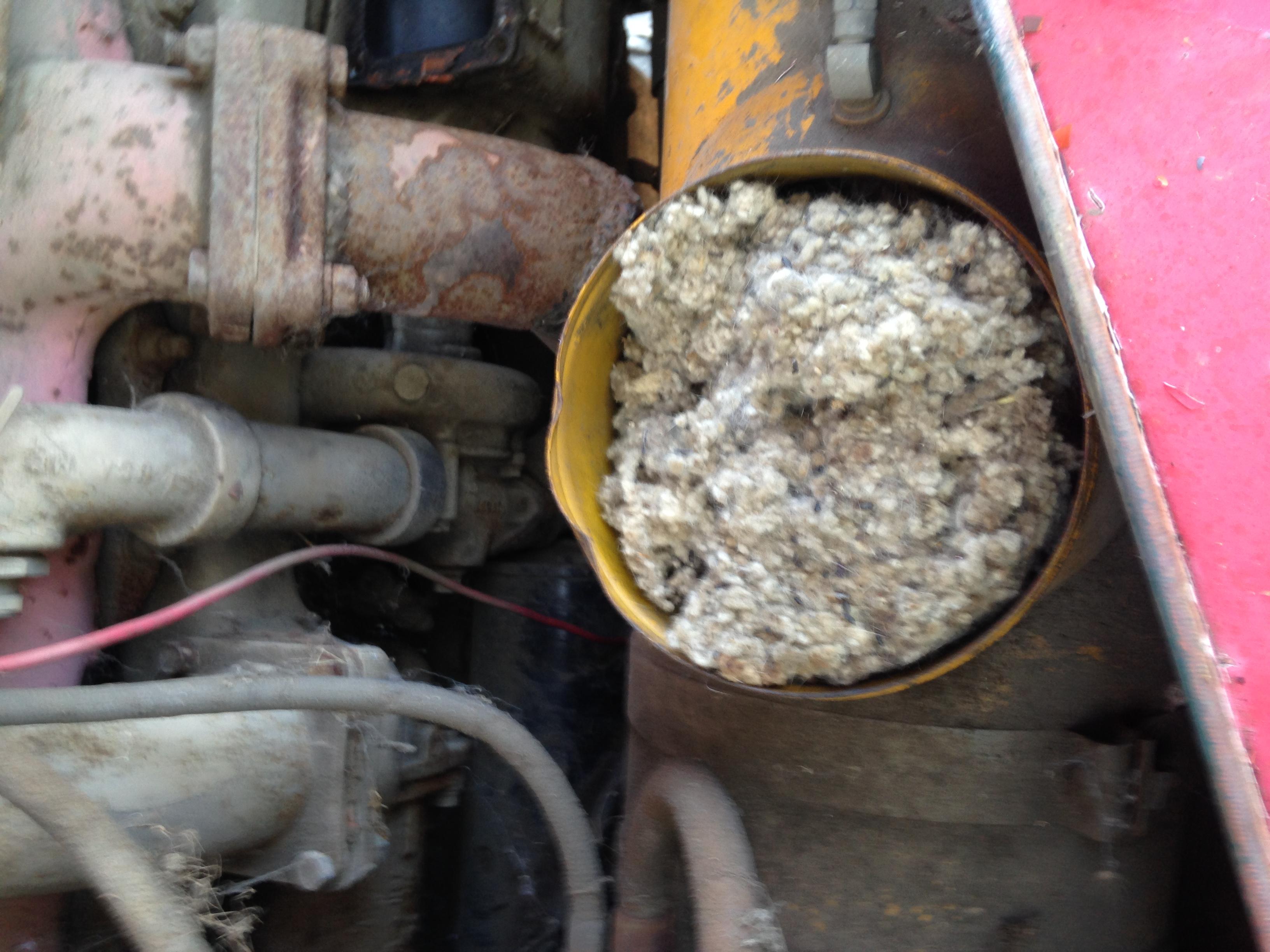

that's a B62 radiator btw. mice love old Macks. we had a b61 we bought that wouldn't turn over, turns out the mice went up the exhaust, found and open valve and built a nest on top of the piston!. turned it one way then the other, didn't have enough clearance to outdue the nest without pulling the head. they love air cleaners to, have had to clear out a few after sittin for years and glad i did before we tried to start the engine
