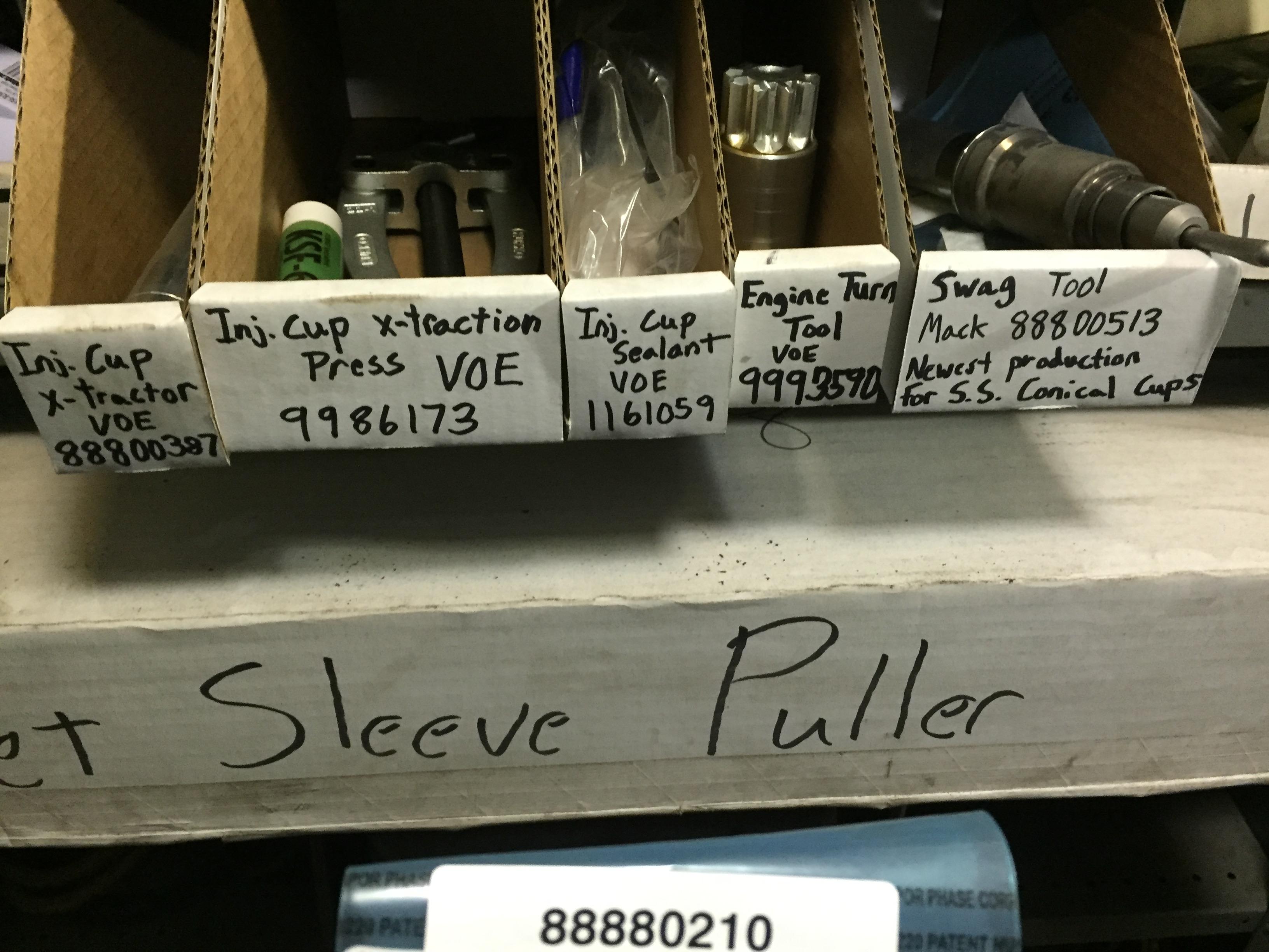

Is this what you ended up with or am I outdated? Keep in mind we are in 2010 emissions so I'm possibly outdated to the dealer intentionally. The pictured L180HL machine showed up without a common rail.
Inj Cup Puller
Inj Cup Swedge
The latest design cup installer pushes a teardrop shaped piece down through the cup tip and then pulls it back through. I've never seen a puller like that.

Actually there are 3 install tools. One for stainless cups, one for the early stepped bottom copper cups and one for the standard flat bottom copper cups.
Do you have the part number for the install tool for conicals? I never knew they had one other than the pull thru. Is the push thru easier to use?
The 8888.... number at bottom of screen is a bag with replacement swag bits. If you see VOE on the box that is a “Volvo Original Equipment” number. That means it was cheaper to buy from Volvo. If you want the numbers Grab it since I have to erase pics soon, too little storage left. If you give Mack the Volvo number of any of these their system will automatically supersede to a Mack #.
