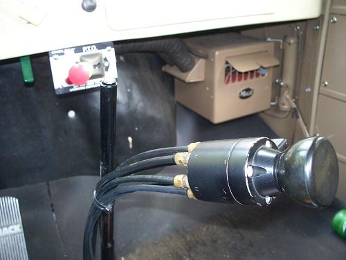

Left the show today and the gear lever broke at the threads while shifting.  Hopefully I can get the broken thread portion out of the Select Air Knob.  Either will need a new stick or repair this one. I will look at it in a couple of days.
This wasn't on my list of things to do....

Took a quick look and it appears to have been cracked for quite a while at the point of the knob jamb nut. There is a little tiny section of really clean metal on the break and the rest of the damaged area looks a little dirty.
Thankfully it is a hobby truck and isn't on call for Monday morning.  It will be put on the repair list but at the moment, there are a couple items that are higher on the MUST DO list.
