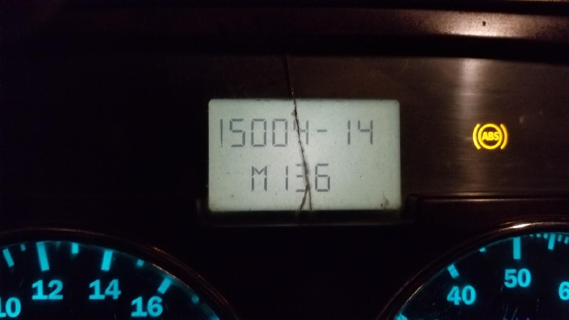

What does this error Code - !5004- 14 / M136 mean?
Sometimes lighting bolt comes on and it feels like power is being robbed from engine.
What could be the cause of it?  Fuel filters have already been changed once in past month.  What does the !5004-14???

That is S 004- fmi 14, which is the left rear( I think left ) wheel speed sensor. If it’s intermittent, quite probable your have a loose wheel nut and allowing hub to move in and out just enough to cause code, check your torque on the wheel nut(s) and might want to pull drum off and check the sensor adjustment, anytime you do brakes, always push the wheel sensors against the tone wheels while you have drums off
