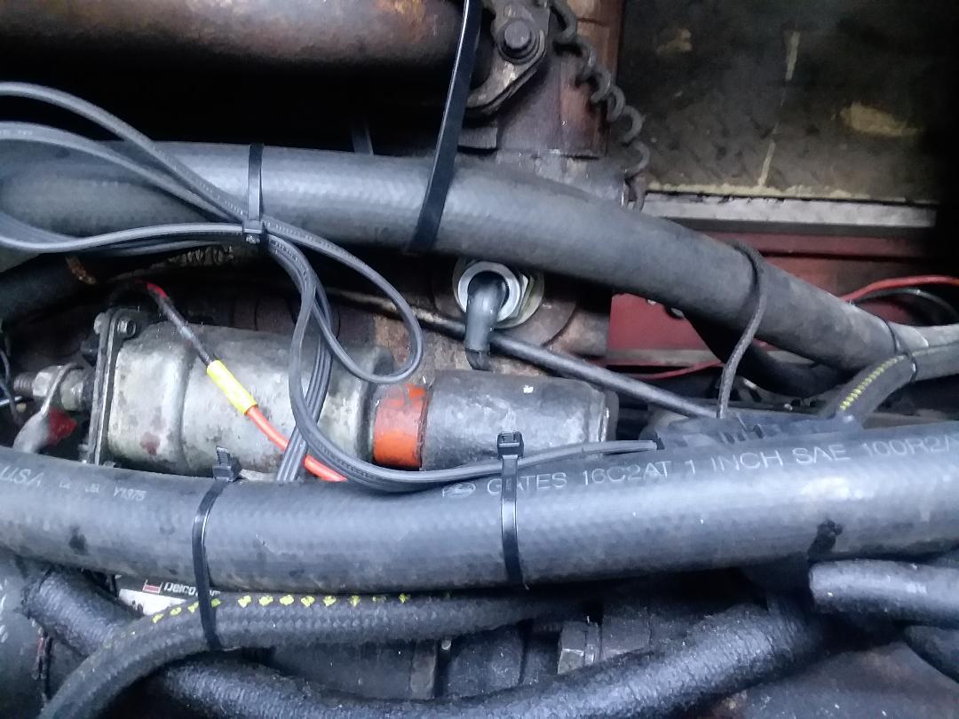

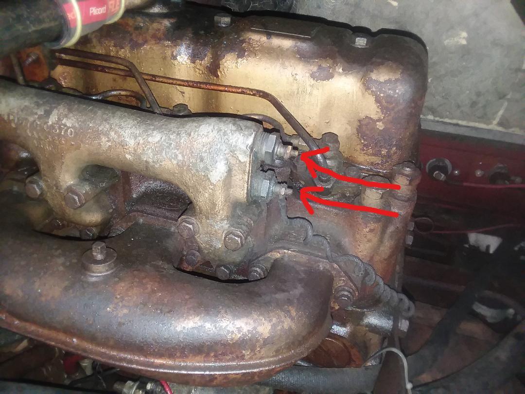

Winter has arrived. The last few days the temps in this area of the planet have been about 10 degrees below average for this time of the year. So much for global warming. I've been making slow but steady progress getting my CF road worthy. Working out the bugs since August. Tracking down some wiring issues and fixing lights. I blew and oil line and a coolant hose. Lost two gallons of oil and six gallons of coolant. Blew the oil line on October 28th and the coolant line a week later. Fixed both problems with a new line and hose. Also new front wheels and tires mounted this past Monday and state inspection Tuesday. Overnight Monday into Tuesday morning the temperature got down in to the high 20's. Tuesday day morning starting the truck to get it to the state inspection station the truck struggled to start with the temperature so low. It definitely needs the assistance of a plug in block heater when starting during colder weather. I've looked the ENDT 675 engine over and I can't find an obvious location where there is a block heater. There is a plus and wire that leads to nothing that has been obviously cut and terminated by a previous owner for whatever reason. I’m not sure if the plug and wire even went to a block heater. The only thing the wire might have connected to is shown in the attached picture. Is this the block heater or something else? I don’t want to hook up 120 volts of AC power to anything without definitely knowing what I’m hooking up to. The result of not knowing could be SHOCKING.

Block heater element is a 1 3/4" threaded unit that replaces one of the core plugs on the engine block.I bought one a while ago for my R made by Zero Start  I think the number was  8600880 the box it kind of trashed . The kit was close to $40, fits Mack E6 673 675 676 707 711 engines.

11 hours ago, HarryS said:
Those look like water temp sensors to me.
That would make sense. I believe you are correct. When I got my truck the pump panel was removed. The stud without the wire attached probably went to a temp gauge to the pump panel. At least I can give myself credit for not hooking up AC power to the studs. Notice how I didn't say I was smart enough..

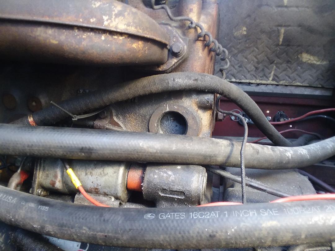

I'm going to have to look closer and crawl around to see if the truck might have ever been equipped with a block heater. Could anyone direct me were to look if there is or was a block heater.
  • 0
I contacted Zero Start this morning. They sent me an pdf installation guide for a block heater for a 673, 675 and 676 engine. I can confirm my truck is not equipped with a block heater. Where is should be on the engine there is only slotted screw plug. The fun part is going to be trying to remove the plug I'm guessing to install the heater.

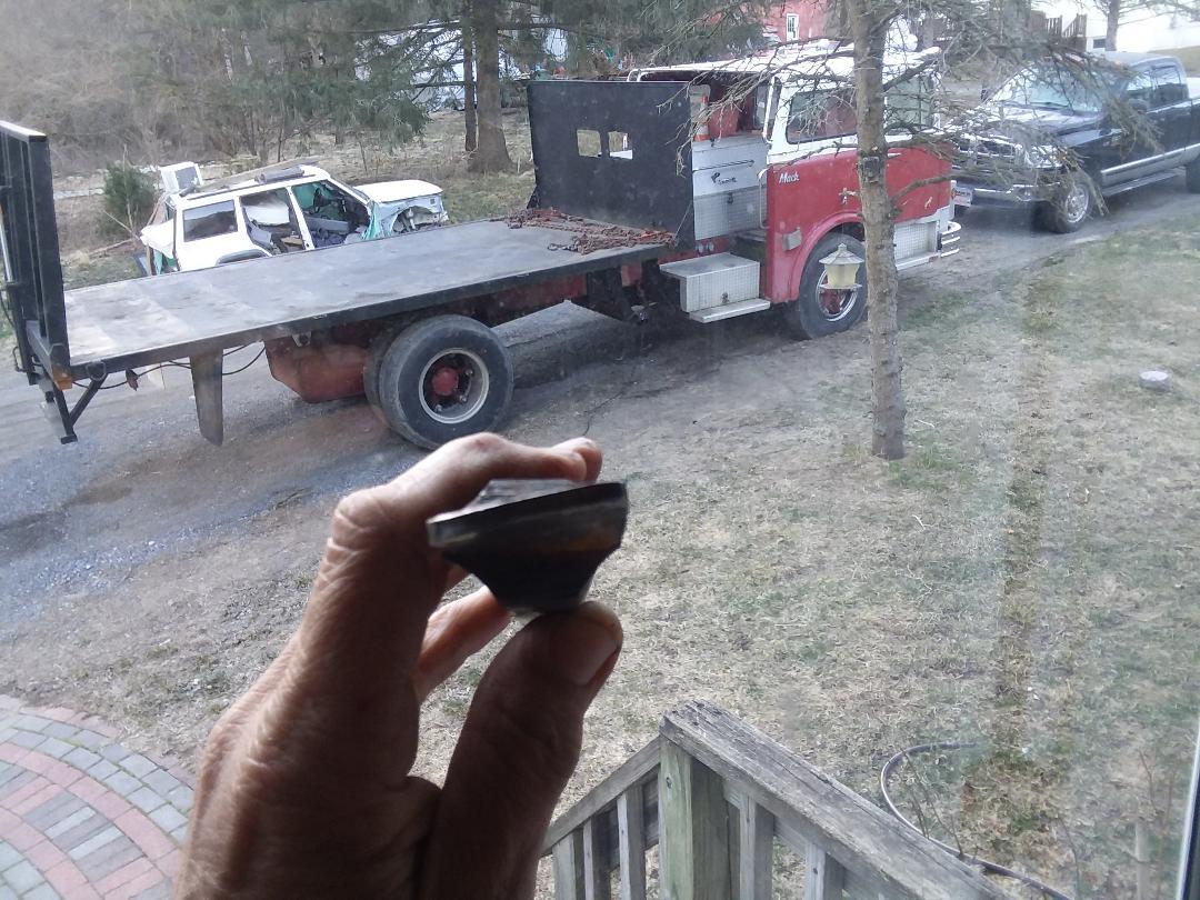

I'll be firing up the forge and putting the Nazel 2B Air Hammer to work making a slot tool out of 5160 7/8 inch or 1 inch heck alloy steel. I'm be attacking the threads with some Kroil to hopefully loosen up any corrosion that might have accumulated over the past 46 years.

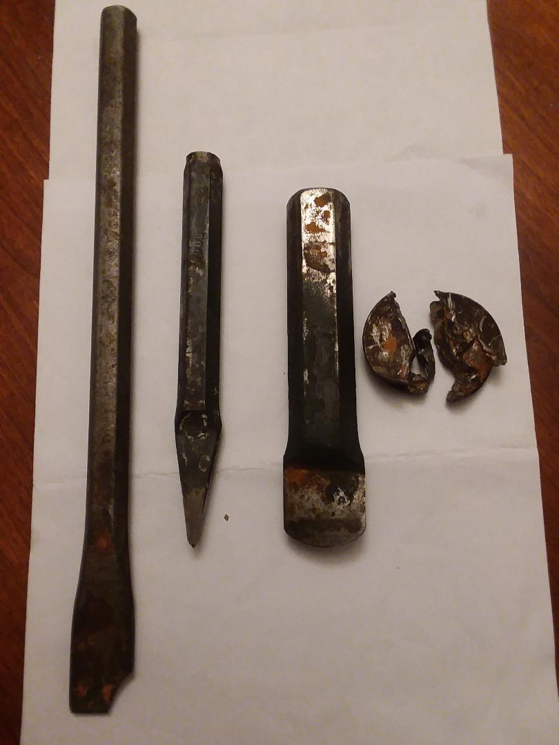

Update - I let the my CF-600 sit mostly over the winter. This past weekend with warmer weather I attacked the core/freeze plug to install a block heater to assist with cold weather starts. Removing the plug turned out to be as difficult or even more so then expected. I started out with a tool I forged to fit the slot in the plug with a breaker bar. No luck. I tried the same tool with an impact and wrench. Hammering away with the impact as I used a box wrench on the tool I forged for added leverage. No Luck. I used a Dremel to cut the slot deeper into the plug in an effort for the tool to get a better purchase. I cut into the water jacket and hammered the male end of the forged tool into the slot for a tight fit. I used a breaker bar with a pipe and I wound twisting the tool. I got ugly with the plug with a drill more Dremel, Sawzall, Big F-ing Hammer, a broken cap chisel, broken straight, a bunch of cursing and a few hours later I carefully split the plug it two pieces without damaging any threads in the block and the plug extraction was complete. If there wasn't so much in the way heating the plug with a torch perhaps would have made the job easier.

After it all I have the block heater installed so hopefully next winter if I need to use the truck on cold days I'll plug it in and I won't have to use ether. Avoided using the truck this past winter on really cold days. Last time it was started and used was the middle of December. It wasn't extremely cold but the engine struggled to start.
