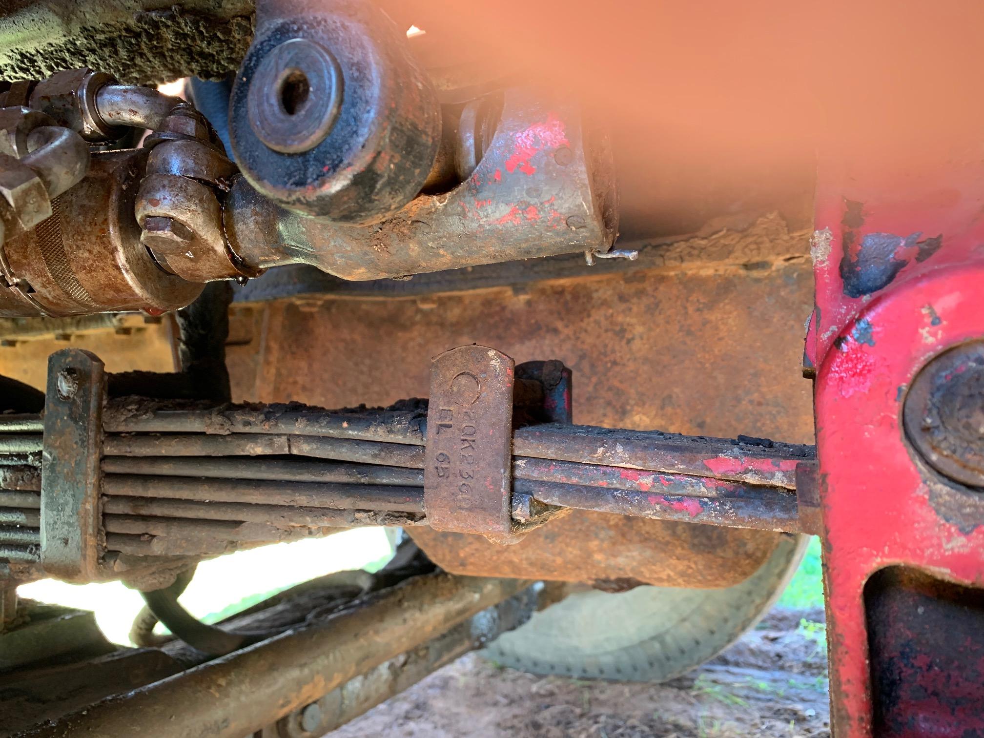

Here is a pic of a broken left front center leaf on a 1963 B61T.  I only use the truck on my property so this won’t get fixed for a while.  I’d like to here recommended solutions.  Buying a used spring from someone parting a truck versus taking the spring to a spring shop.
