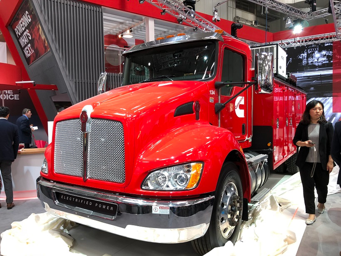

Cummins unveiled its PowerDrive suite of plug-in hybrid electric solutions on a functional Kenworth T370 utility truck at the IAA Commercial Vehicles Show in Hannover, Germany.

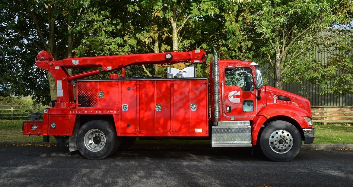

PowerDrive replaces the conventional transmission and switches in real time between two hybrid and pure electric modes, optimizing the powertrain for the best fuel economy in any situation. The hybrid utility truck featured a recovery crane that could operate off of either engine power take-off or electric power. The vehicle is also configured with exportable grid quality electric power to recharge other vehicles.

The Kenworth T370 with PowerDrive 6000 is paired with a Cummins B6.7 engine. The service vehicle was commissioned by Cummins to support EV and PHEV vehicle field tests and pilot routes. It features three vehicle charging stations with direct charging cables from the truck to the PHEV or EV vehicle requiring charging.  A Class 6 truck powered by PowerDrive can realize reduced emissions of up to 80%, according to Cummins, and can also reduce fuel costs.

This unique hybrid system is centre stage at the Cummins booth in an electric hybrid utility truck, a Kenworth T370. As the most versatile hybrid system on the market today, the Cummins PowerDrive offers both parallel and series capabilities. The PowerDrive replaces the conventional transmission and switches in real time between two hybrid and two pure electric modes, optimizing the powertrain for the best fuel economics in any driving situation. The vehicle is also configured with exportable grid quality electric power to recharge vehicles and a recovery crane operating on either electric or engine power take-off.

The Cummins PowerDrive 6000 is paired with a Cummins B6.7 in the Kenworth T370, a US Class 6 truck. The vehicle’s gross weight is 33,000 lbs (15 mt gvw). The service vehicle was commissioned by Cummins to support EV and PHEV vehicle field tests and pilot routes. It showcases three vehicle charging stations (1: 100 kW fast charge and 2: 6.6 kW standard chargers) with direct charging cables from the truck to the PHEV or EV vehicle requiring charging.
