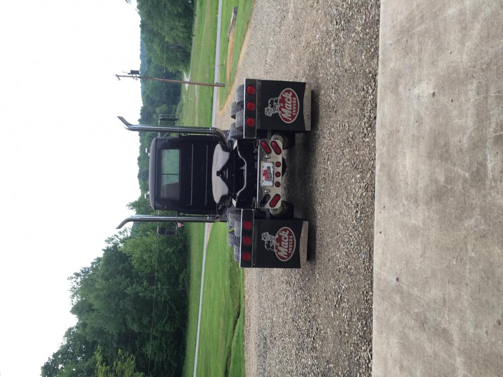

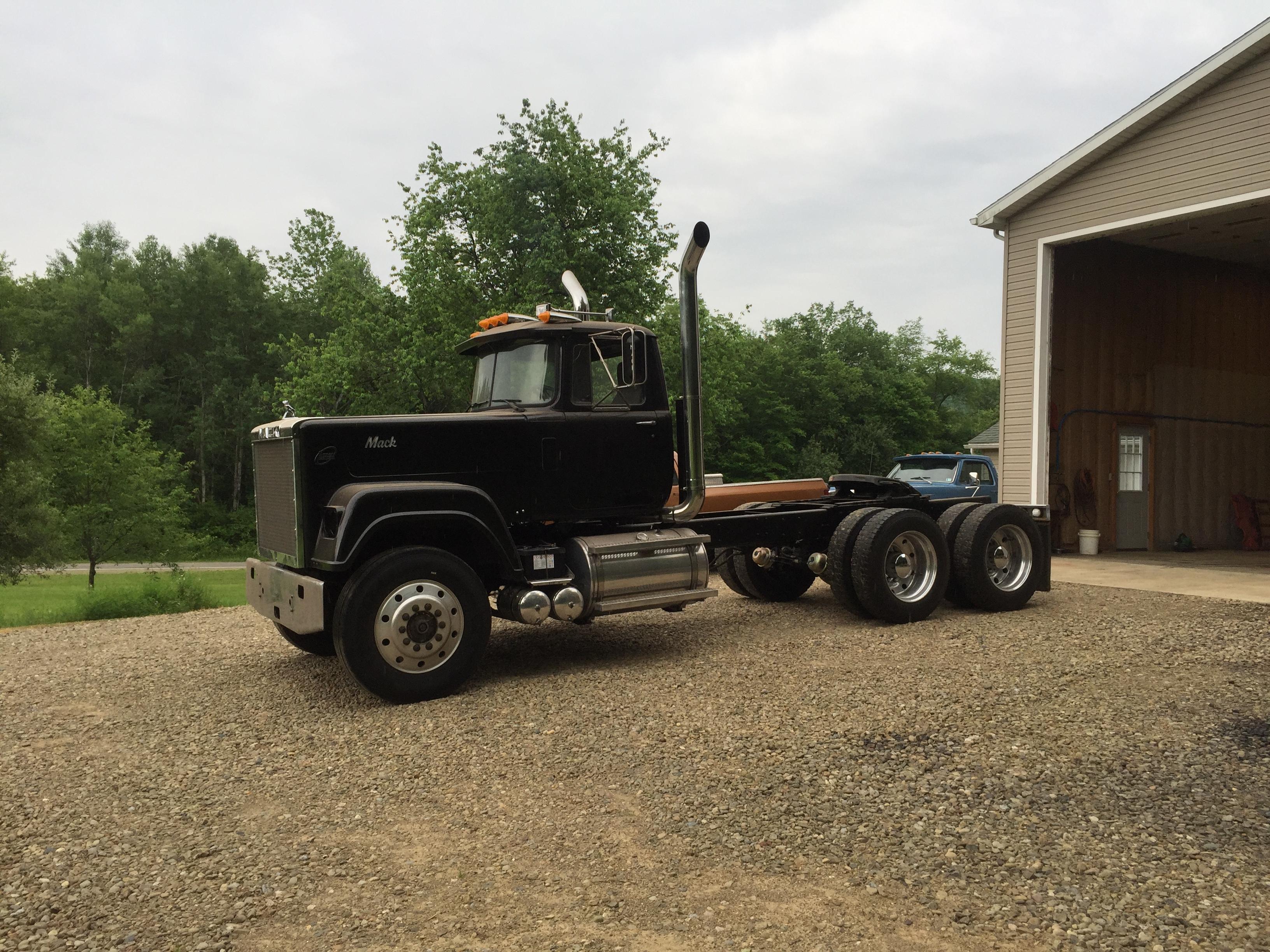

Cost for everything is relative to your area.
I just had my hubs and rims blasted this spring(dustless blasting).  I had $300? in it.  He brought his trailer/equipment and did it in my driveway.   Few hours and it was done.  I'm sure if you have a portable guy in your neck of the woods you could do the same kind of deal on your frame.
Tires?   $400-600 depending on brand, and they can go higher for high end tires.  I run 22.5" Toyo on mine and they were $400 each just a few years back I put new steers on it.
As for which truck?  Buy the best you can afford.  Try to make sure all the big mechanicals are in good shape, you don't want to have to put engine/trans/rearends in it.  Rust is common and will just have to find the best you can.  All depending on your capabilities and/or how much you can spend to have it done.
I bought my B for basically $2500.  I've done near everything but put a transmission in it over the last 17 yrs.  Every few years I find another project to tackle. I'd have to do some math to figure out what I have tied up in it, though I know it's not a large sum.  I keep it running(as I need it).   Some buy a project, tear it apart and never see the light of day again.  It can be a daunting task.
