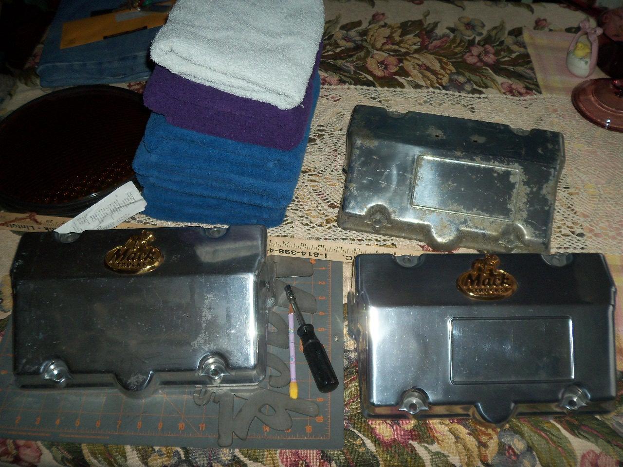

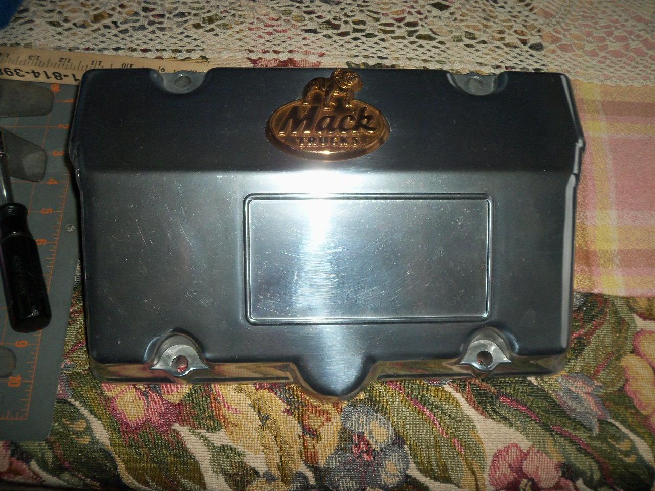

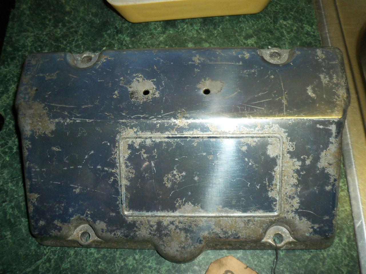

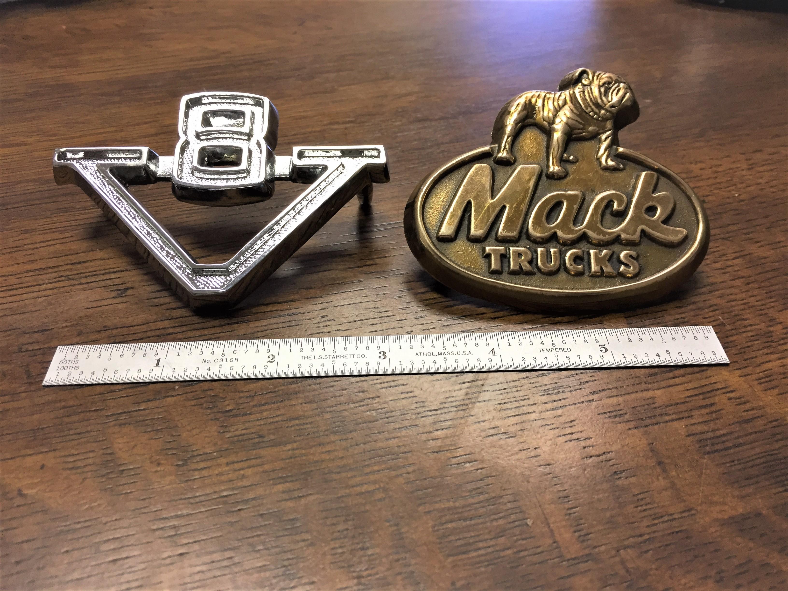

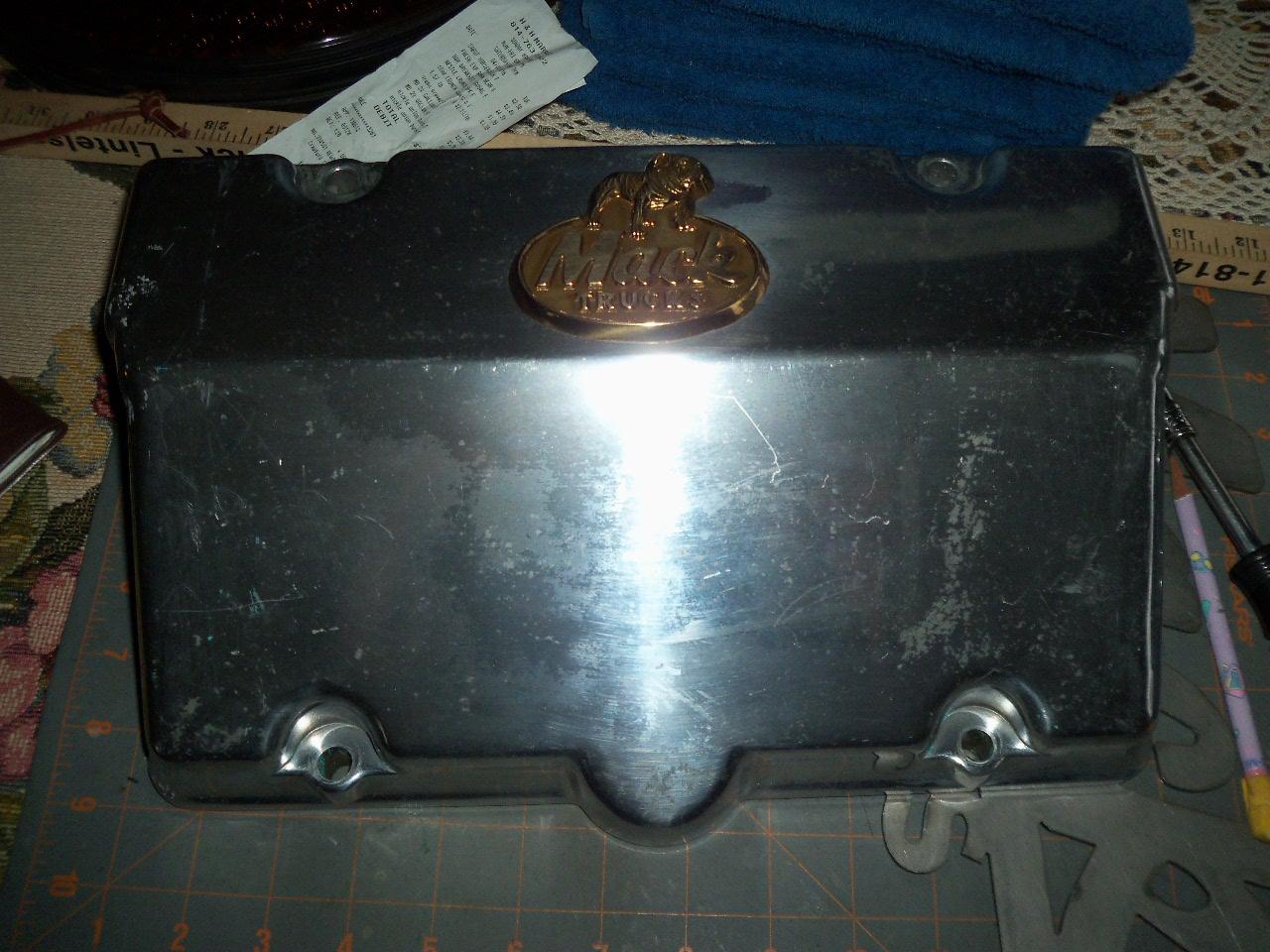

I have a need for a few of each of these very hard to find Emblems. Even harder is to find them in new condition. I am seriously considering having some cast out of bronze. The E9 valve cover Dog was bronze originally and just polished. These were produced one year only from what I can tell around 1993 for the black engine with chrome valve covers in CL700's. The V8 came be chrome plated and they did come gold plated but not solid bronze. These were used from 1963-1979 but I can be corrected. They will be made in the USA and not cheap but affordable. Thinking around $85-95 a piece. Would any of you have an interest in them and maybe the price will come down with a larger order. I am working on the patterns now and finished cost with a foundry. If I used these actual parts for patterns the castings will be about 2-3% smaller due to casting shrinkage. That is not a lot smaller but will be noticeable compared to an original.
Do you consider $85-90 apiece including chrome-plating or a brass casting only? Suppose plating itself would take about that worth or at least a half of.
As for the size decrease due to brass (oh, bronze, sorry) shrinkage I see two ways to go. The 1st and more clear one is copying the existing parts with silicone compound. Than further as I know guys cast wax or steorine into the silicone and than make a form of gyps over the wax model. Further they melt the wax out and cast bronze into the gyps. Cracking the latter after the metal is cold you get what you want. Maybe with some size decrease, I honestly have no idea. Another more complicated way is to 3D scan the parts and than draw a 3D model which you can easily rescale to compensate any size decrease. Upps, you need to 3d print it first. Or there could be another option to make it of a piece of brass by computer-operated milling machine.
Sure any of those ways is an entertainment.
The price that I am quoted is for the Bronze casting that will be polished. The Bulldog came that way and not chromed. The V-8 came chrome and gold plated. Prices from Mack when I got some of the last V-8 NOS over 20 years ago was $65 chrome, $95 gold. I don't know what the Bulldog was priced as it only came on the chrome valve covers and does not have a part number on it.
By the way I have seen the V-8 emblems go on Ebay for far more than $100 each. Even triple chroming should not add more than $25-30 each.
The casting originals will be 3D wax printed to correct for shrink and investment cast.
Just seeing if there is any interest so I know how many to make for myself and maybe a few other guys.
I'd be very interested for sure! I have a 2 set of the chrome/polished valve Cover that the bulldog emblem came on and I'm missing 2 of the emblems for them and I would be interested in extras along with V8 emblems. Prices seem fare to me. Keep us posted on your progress!

AZB755V8  There is a mob here in Australia already making the chromed V8 badges for $155 .00 Aussie dollar or you can buy them for $55.00 unfinished. i have bought 4 for my 797, 2 for the truck and 2 spares ,they are good quality badges .i used to do high end restos and these would be up there for quality. Ian Lee w.w.w.tyldenheritage.com.au  have a gander at his site
Thanks for the info. Sorry for asking but what is a "mob"? Is it man or guy here in the US?
That chromed badge price is almost right on for what I was thinking, converts to $112 USD. So I will not be doing the V-8's as they are already available in AU and fairly priced. I will be concentrating on the Bulldog.
