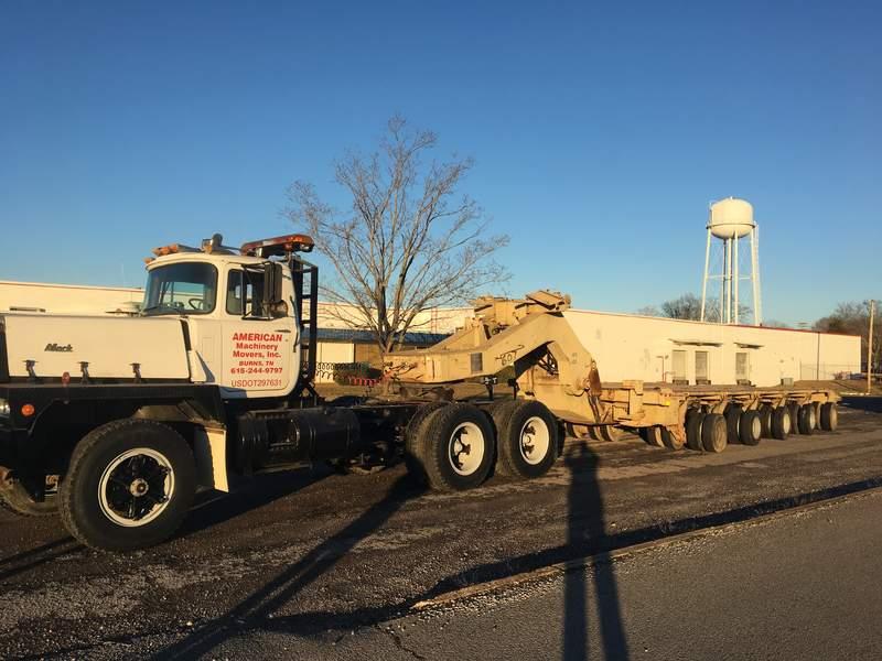

I just pulled it out of our warehouse and around the building.
There is a learning curve to pulling it. It doesn’t track like a regular trailer at all. If you swing wide for a turn, you’ll likely end up in the far side ditch.
To get it backed out of the building, it was kind of tight, so I had to put Dad to driving the truck, and I had to walk beside the trailer and manually steer it. Once in the clear, you put the trailer in automatic mode and it will steer with the truck.
