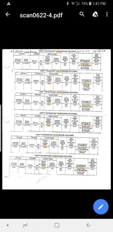

Hopefully that is ledgible, all the injector numbers to get you whatever you need.  Thanks to mackpro.  Or mack tech, I can't remember which one I got them from, but they both have been a HUGE help to me and a lot of people on here.

I have a ami370, put on an etech exhaust manifold, went to the 427/460 injectors from k&s thanks to mack tech and they were great to deal with, and had the local turbo shop build an s467 with a billet wheel.  The truck makes 44psi of boost and runs like a monster, fun to drive now.
Looks like we have our blueprint and a good testimony!!
Thanks ORMack.
You willing to mention cost on turbo build?
So I am relatively new to this stuff, am I correct in saying that to go from a 370 to 460 its just a turbo and injector change and no ECM work ?
Not that I want to change anything in my ECM, just curious.
I’ve heard about a 460 XT that’s about 485 HP is that also injector and turbo or does it include ECM ?

On 10/5/2018 at 7:50 AM, Mack Technician said:
If you add 100 your a 370, drop it to 460 and you need;
631GC5172M3 turbo (which I have for sale for 10% of new price, if you are staying stock)
736GB419M3 injectors (if your staying stock)
Your on your own for ECM software. Site is still mourning Mpro's departure.
Your truck will be set up as AMI not AI, but the peaks may overlap well enough since AI-460 has a long, flat, top.
Pay attention to torque rating of clutch, trans, driveline, etc.
