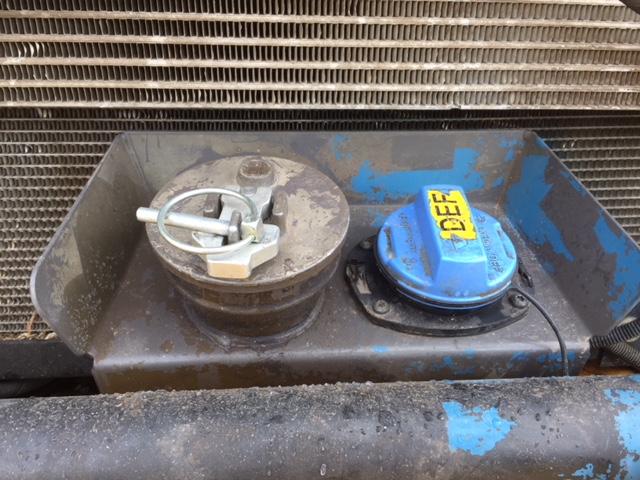

Look to the truck purity sensing, containment and the operator. I had one issue on a Volvo with impurity...in other words the operator was filling the DEF tank with fuel, stopped when he realized it, told no one and brought it in with a code and "no idea what's going on". We had to paint surround blue and put DEF stickers in multiple places. The blue cap was not sufficient, if the operator is a day-dreamer your in big trouble. Volvo put the fills too close together and set up the bad future scenarios. Did you get your hands on some of the impure fluid?

The machine Pictured is a Volvo L180H. It simply gave a monitor reading for impurity. I drained everything, flushed, ran some NAPA Ad/Blue through it and switched back. 8K hours and never another issues. Blue paint fixed it I guess? I shot the topside DEF supply through our spectrum and it came out in spec.

Our 2015 Pierce Firetruck's DEF fill is over the fuel fill. After this happened a THIRD time, we installed a plate on a hinge with a cotter pin that you physically have to remove to be able to open the plate to get to the DEF cap. The act of having to pull the pin and then flip open a plate seems to be enough to make guys think....so far........
