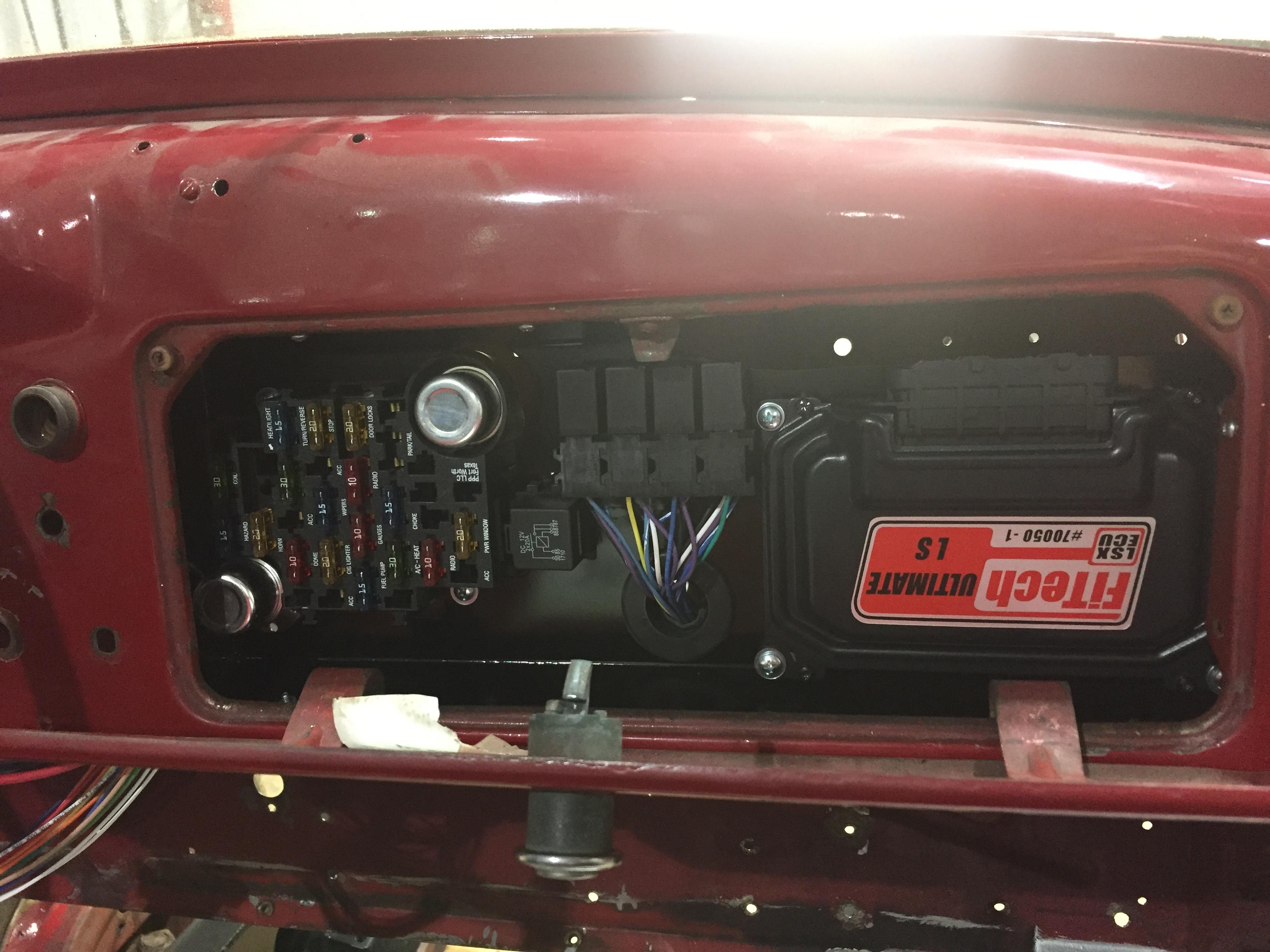

sounds like a wiring issue ,might be best to rewire all,my Mack was like a rats nest with wiring added through the years, check all the steel brake lines too ,I had a steel line that rotted away. good luck and post photos
I would second that. I re-wired my 45 bumper to bumper. I used a Painless Pro harness to start with and reconfigured it to work for my application. I had to switch to 12v negative ground but you can still use it for 6v positive ground.
