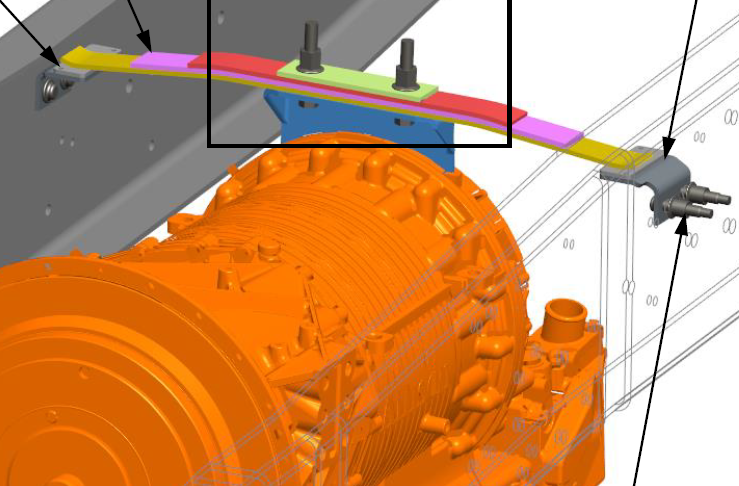

Pretty big undertaking.  Special transmission wire harness, and engine wire harnesses needed. Does the donor chassis have the same engine type as your RD, then maybe you could just pull the donor ECM. Not sure about component shop flashing new software.  Flywheel housing should be the same, but flywheel needs swapped out and you need the spacer ring. Allisons are very heavy and require rear buggy spring mounts at the rear of the transmission, so you probably need to fabricate brackets on your frame.  I'm not familiar with where the RD rear engine mounts are located (Flywheel Housing or Side of transmission) in either case they will not likely be the same.  There would probably be more headaches along the way, that I'm not thinking of.
Hate to say this, but I'd recommend trading your truck to get the transmission you want.
Pic of buggy spring

I have looked into doing an Allison for a 1985 MH with an E9-V8. The big issue is to get the trans to bolt up to the engine. The bellhousing that you have should work as it is a SAE #1 or something of that sort. From what I know most trans have the same housing diameter and flange, but I am no expert. There is a 13/16 inch spacer available to set back the trans. As for flex-plates there are several different ways to get the starter gear and torque converter to bolt up, maybe gear on torque converter. I have no choice but to make a custom steel "flexplate/flywheel" as the E9 is counterbalanced in the flywheel. Still working on that. The rear of the trans does need supported like in the previous illustration and not solid mounted. Trans I am going with is a HT754CR, 5 speed without deep reduction. What is going to make this all work is a cable shifted trans, no electronics. My truck does not have any electronics and the early Allison's were cable shifted before they had the brain. Actual RPM shift points are set in the valve body with spring pressures, that is old school as well and having someone do that setting is hard to find these days. As for help from Mack there really is no one there that could tell you much about older "Mack" trucks as they are focused on new Volvo stuff, just plain forgot or retired. Retrofitting is going to be all on the guy (you) that wants it bad enough to figure it out to make it work. Torque capacity for that HT750 is 1450 ft/lbs but can do that load all day long, is that matched to your engine torque rating? I am just playing with this E9 and will never be fully loaded.
