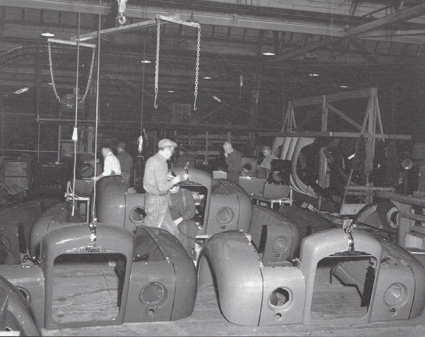

those shells and fenders in the Mack pictures are pre 1959.  back then you hung it as a section and adjusted as needed. i have always bolted fender, inner fender and inner headlight panel and outer as a whole and hung with the top two bolts as  section. i always take a 3/8 fine thread bolt and cut the head off to hang the back of the fender on til you get everything secured.  i have left the outer headlight panel off and just done inner with the assembly. either way you usually fight with the top headlight to fender bolt

  Fenders look great, hope your knee is heeled good.     If a person had an overhead crane,   all together would be great.     When I put mine together , I did it separately too.  Two people to hold in place and another to put bolts in.    And with the extended nose on the B71, there were a few bolts that I almost had to stand on my head to get in.
