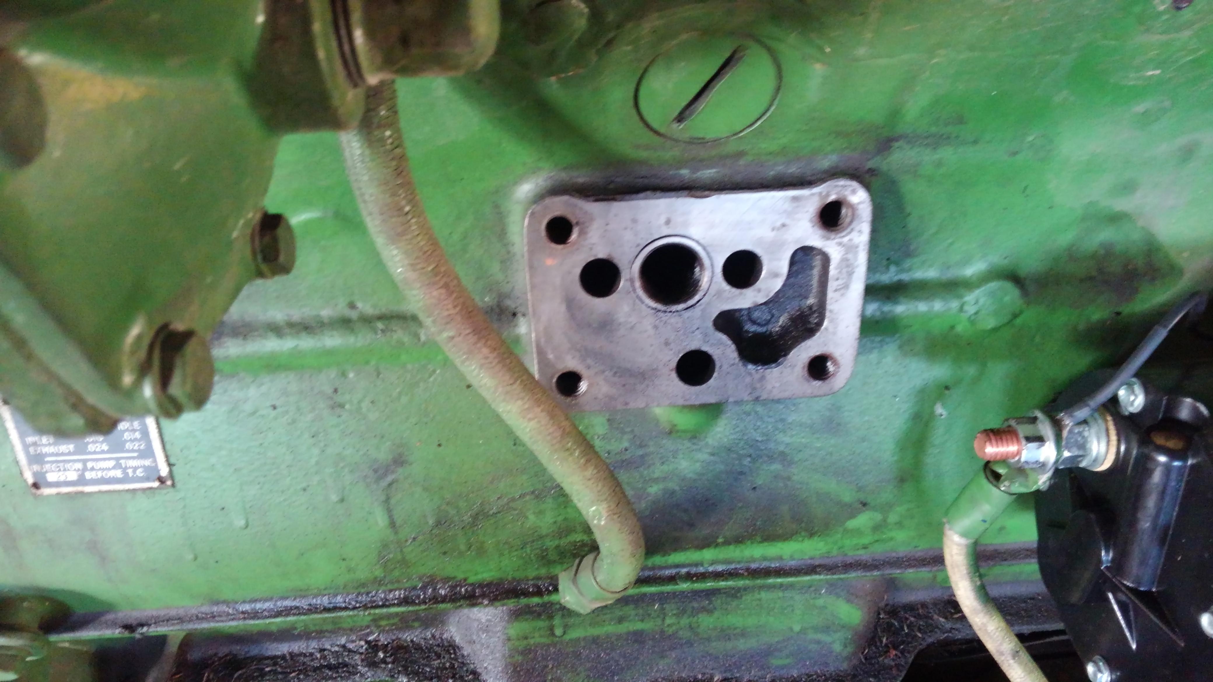

I wonder if you could just bolt on a filter/oil cooler from a 237?  The cooler connects differently to the top of the filter housing on a 237 so I doubt you could blend them together.  Not sure about the front side of cooler and water pump though.  Would need to see yours to compare.
Being yours is a turbo motor, it should have the same mounting plate layout.  Something to consider.

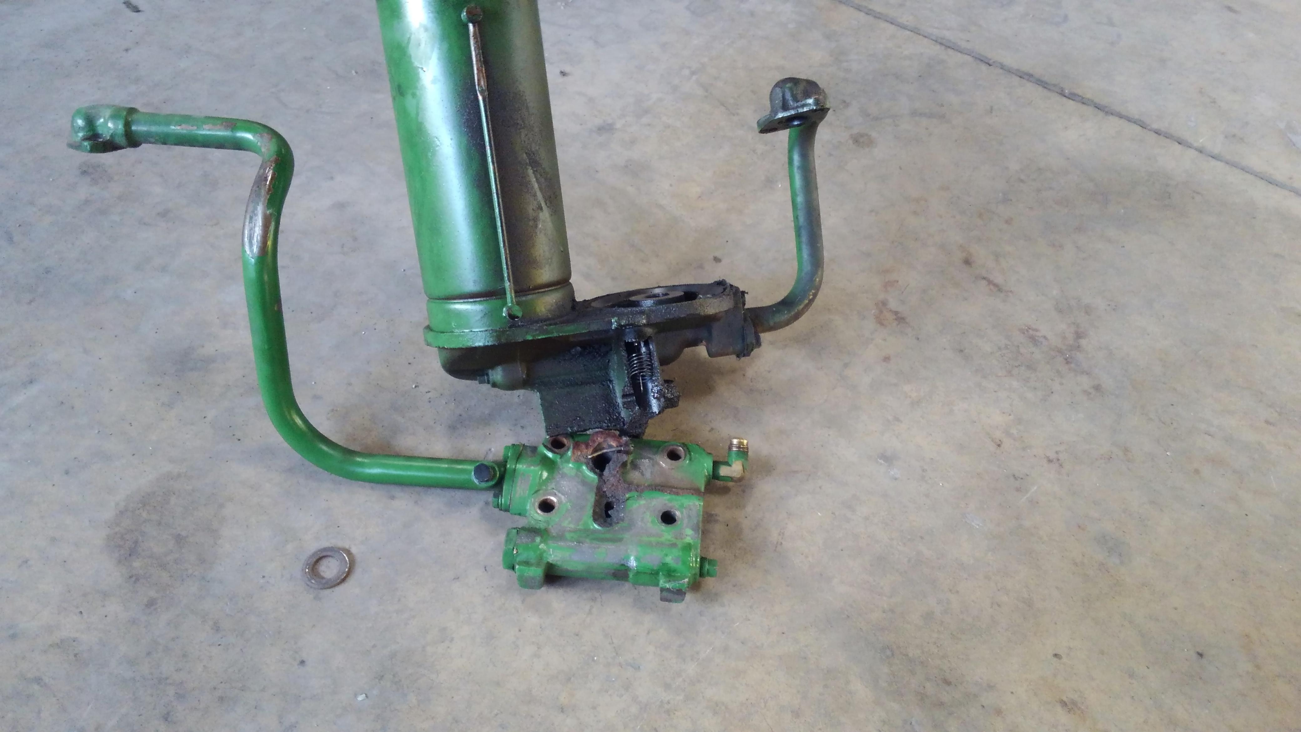

The cooler on a 237 plugs directly into the filter housing using o-rings.  I don't have a better picture of just the side.
The front of the cooler bolts into the waterpump housing.
