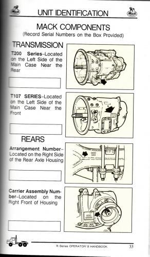

Thank you sir!  I’ll get a rag and some cleaner and see if I can find the tags. The previous owner thinks the ratio he ran was .417 and 38k# rear axles
Do you think the 1990 model engine was designated a EM7 or just E7 ? And what was the difference ?

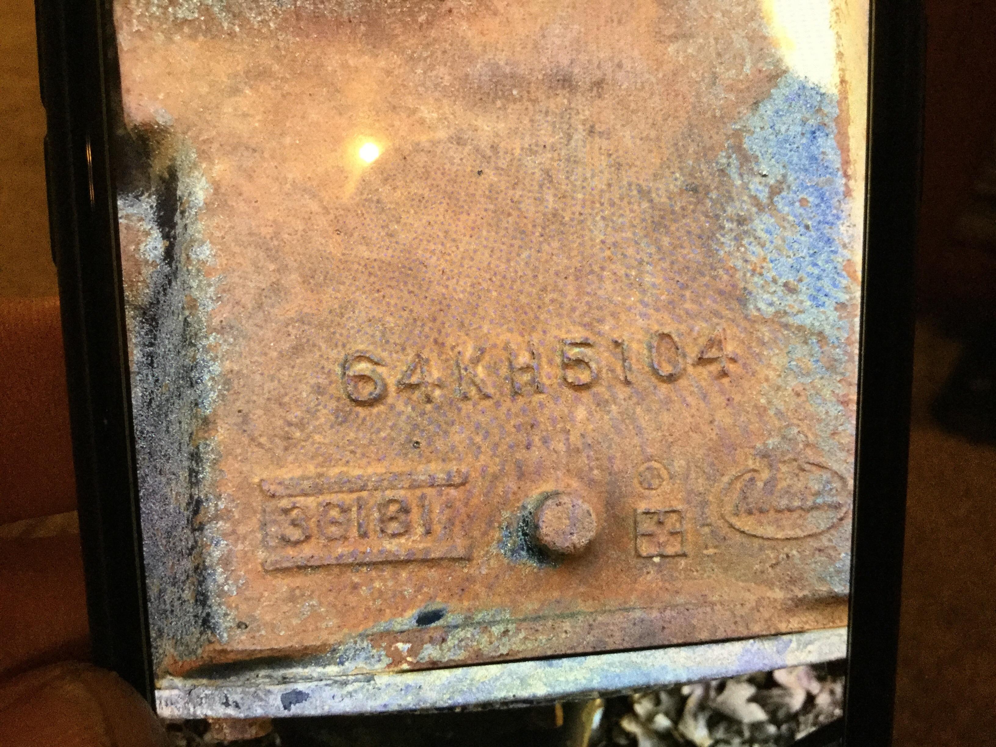

We got it running today. Runs good but needs 4 new batteries which I expected. Cleaned the tag on the top of the valve cover. It is indeed an E6M. 7 speed transmission with the air shift for low, high and N which I assume is neutral??  Can anyone confirm what the position (N) would be used for???

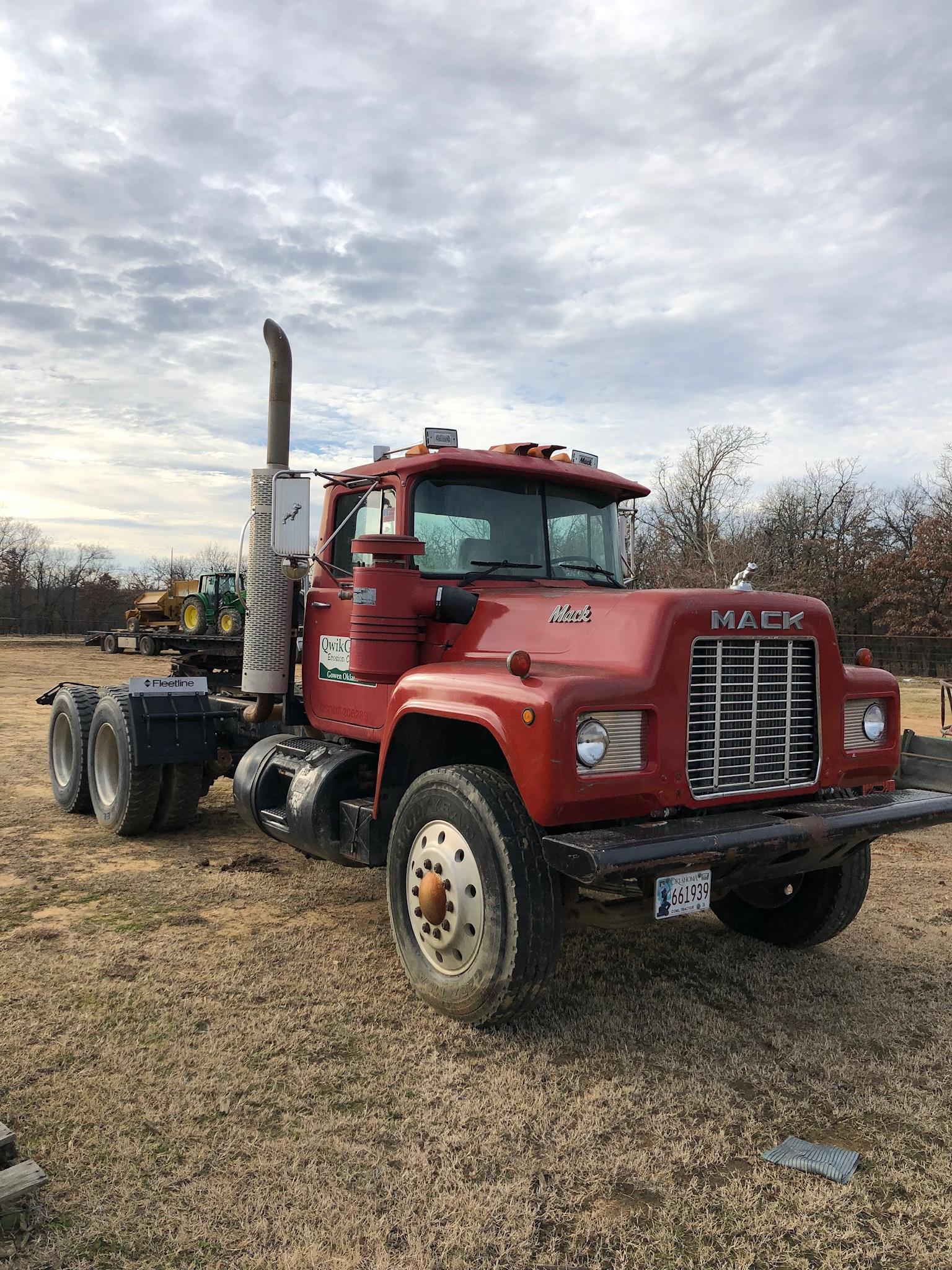

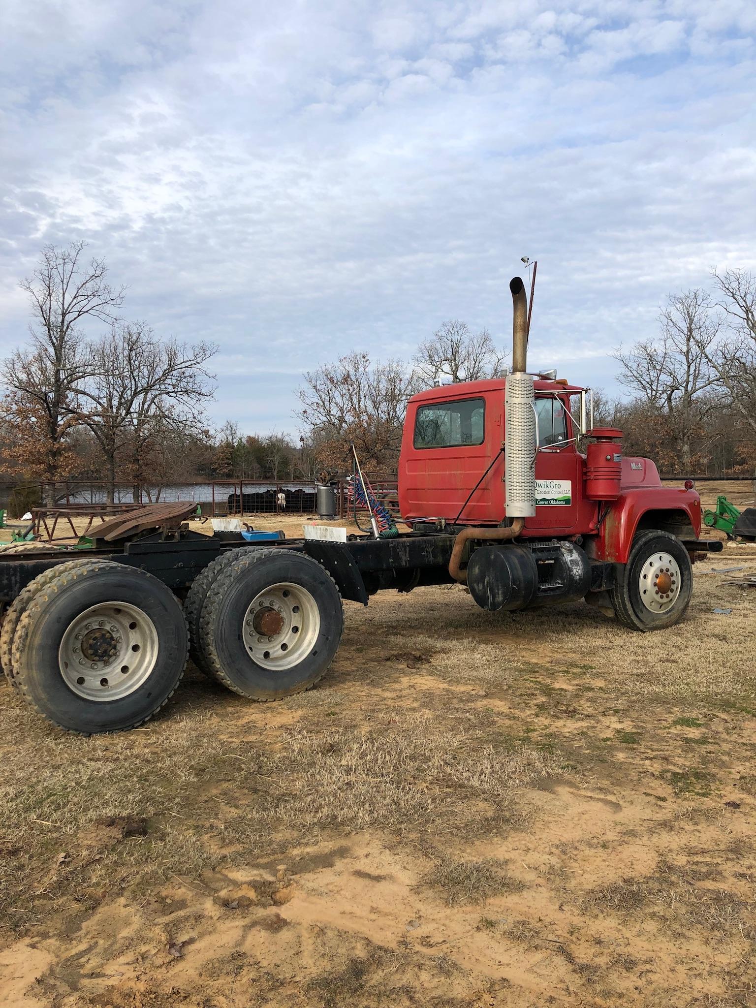

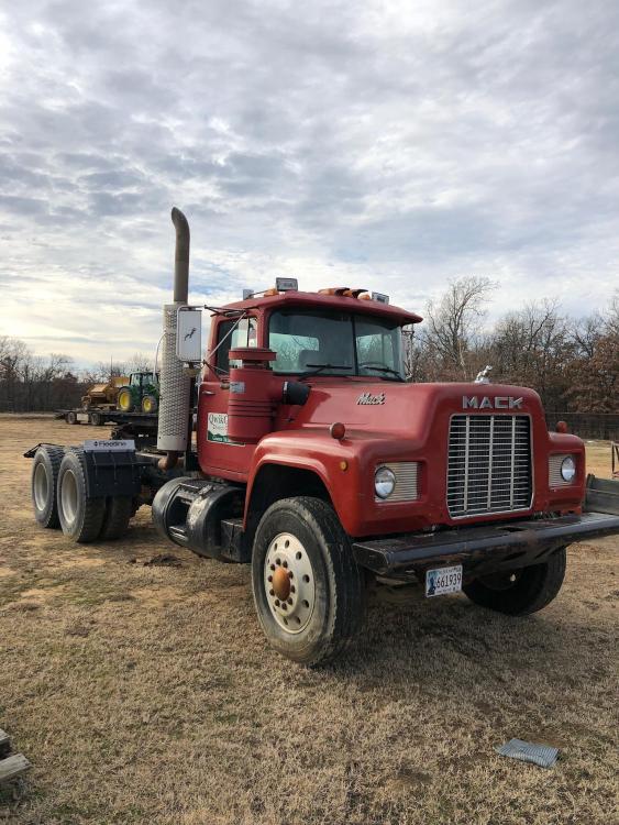

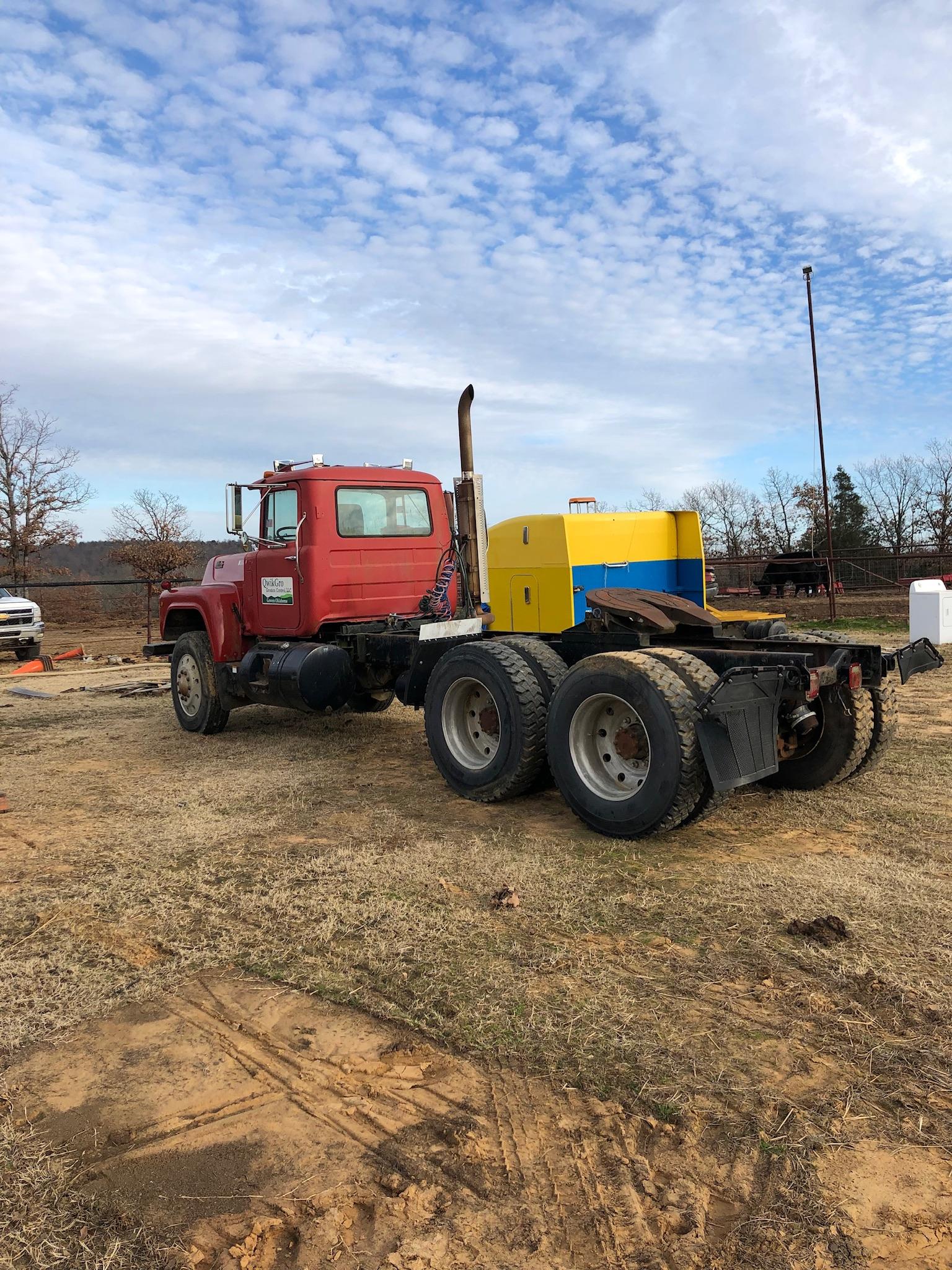

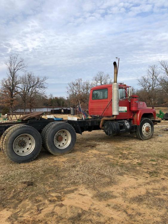

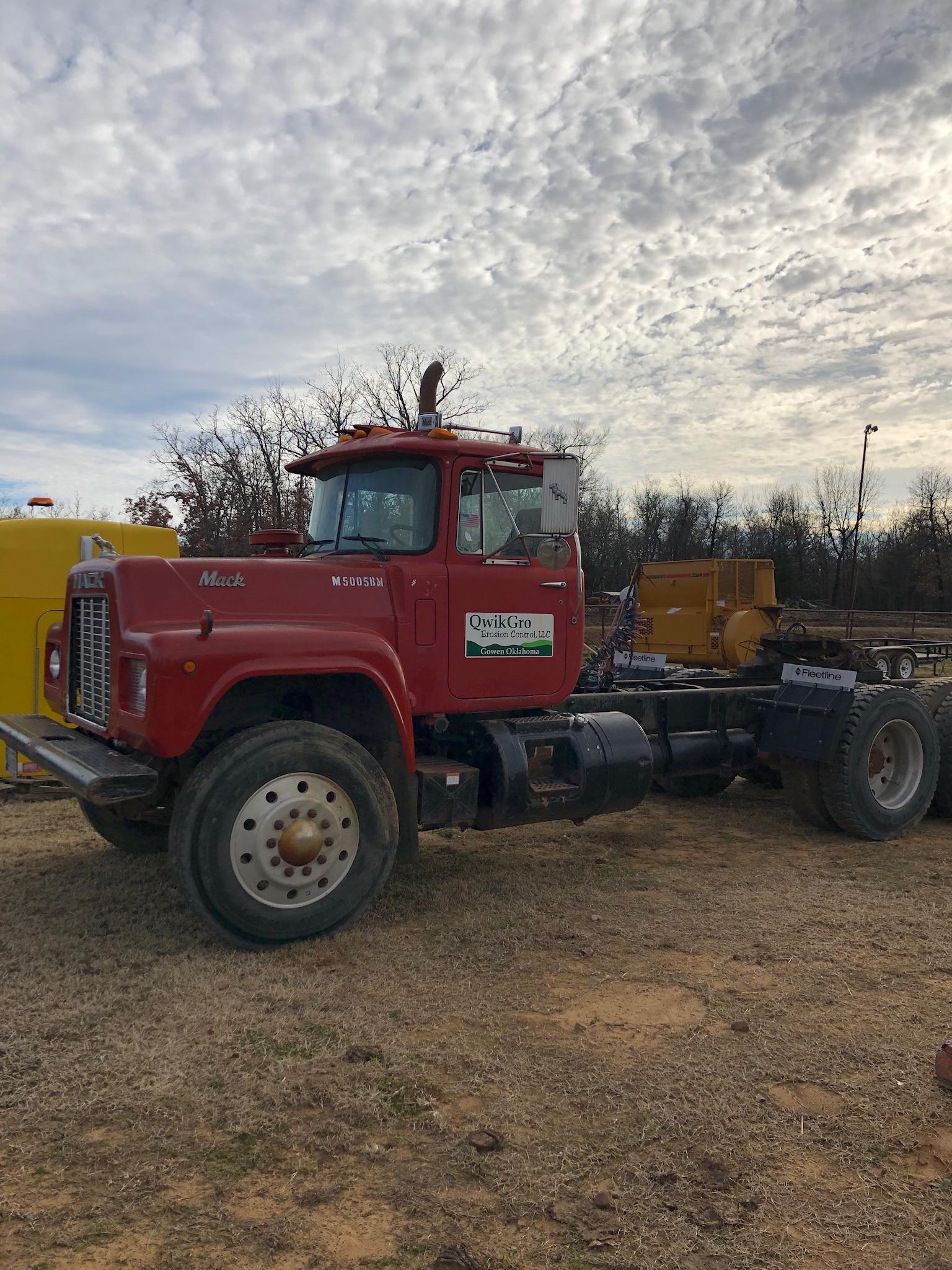

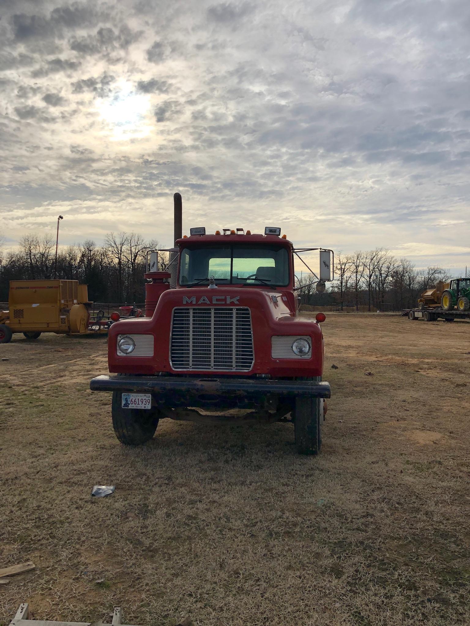

Here’s a few pictures I took of the bulldog today. My plan is to go through it a make a super nice rig out of her!
We couldn’t get the door stickers off with the heat gun and they are not representative of the current owner. I’m going to try one of those eraser/buffer wheels.
208” wheelbase
the rubber eraser wheels work great . use a variable speed drill motor and turn it just fast enough to take the decal off . your wheel will last longer and not burn the paint . they don`t work real well on painted letters but they will work
