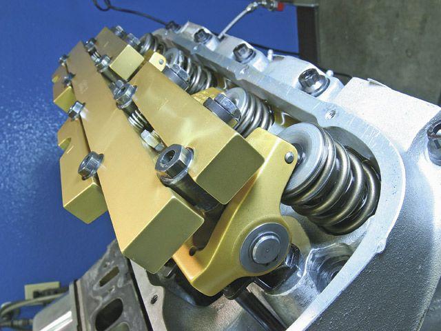

They need to be 6.13/16"  from the gasket flange to the inside top so  I would guess that out side should be 8" +/- . They need to clear a hi lift cam, roller rockers and a girdle.
The tall M/T copies Holly sells are too short.

On 1/30/2019 at 5:57 PM, 1965 said:
I remember the rules you were talking about. Back in the day did they have girdles or roller rockers? Guess they did because they made tall covers. You’ve schooled me on blowers back then.
The Girdles are a new thing, hence the extra tall valve covers. With the 1.7 roller rockers and the bridge to lock the adjustment and stop and "flex"
