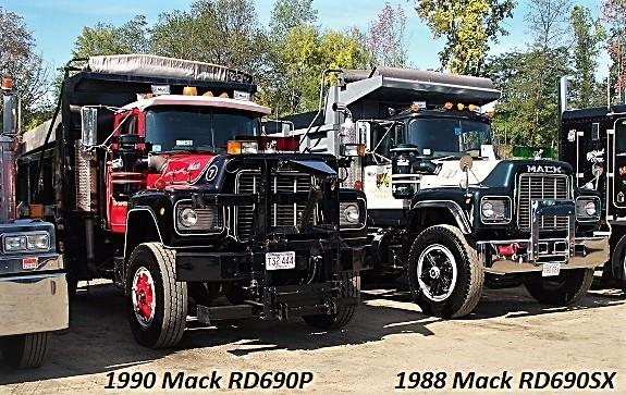

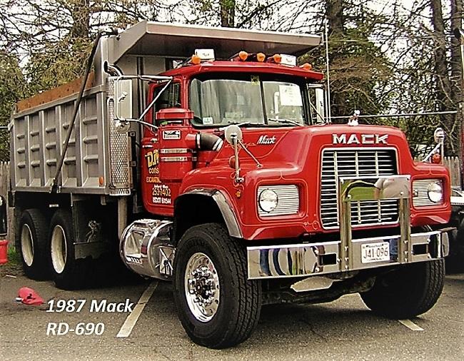

Can someone tell me what is the difference between an rd686 and an rd 690.  I thought it was just a year thing but now i'am not sure.   Maybe the 686 has only 6 speed and 690 has 7 spd or more Maxitorque gears.
On 1/3/2019 at 9:06 PM, Maxidyne said:
686 has the engine mounted intercooler, 690 has the chassis mounted intercooler in front of the radiator.
The Mack engine designation 86 represented the use of ENDT676, EM6 285 or EM6 300 engines over the course of the production run.  Early models used the Tip Turbine mounted on the engine for cooling the air charge.  The front mounted charge cooler replaced the Tip Turbine around 1982 on most models.  DM686 models continued longer with the Tip Turbine until 1988, for example.
Engine designation 90 indicates the use of the EM6 300 (early), EM7 250 HP Econodyne or EM7 300.
