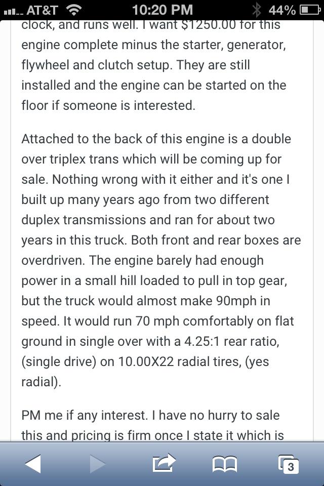

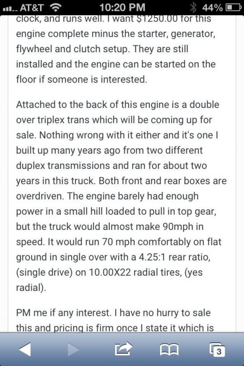

Doing some quick math, if you're doing 43 mph with a 6.34 ratio, you'd need a 4.50 rear to do 60 mph (4.54 technically, but if I recall, Mack made a 4.50 rear that went into some of the Bs with the direct-drive duplex). I'm guessing you have a single-over triplex with final drive ratio of .85. On standard rubber that would give you about 47 mph at 2100, pretty close to the 43 mph you mention. I would think that you have enough power pull a dozer at 60 mph with the ENDT and a 4.50 rear, at least on flat ground. I once drove a single-axle R model with an END 673 (no turbo), single-over triplex, and 4.14 rear pulling single-axle trailers with maybe a 10-12,000 pound payload, and it would run about 70 until it hit a hill.
