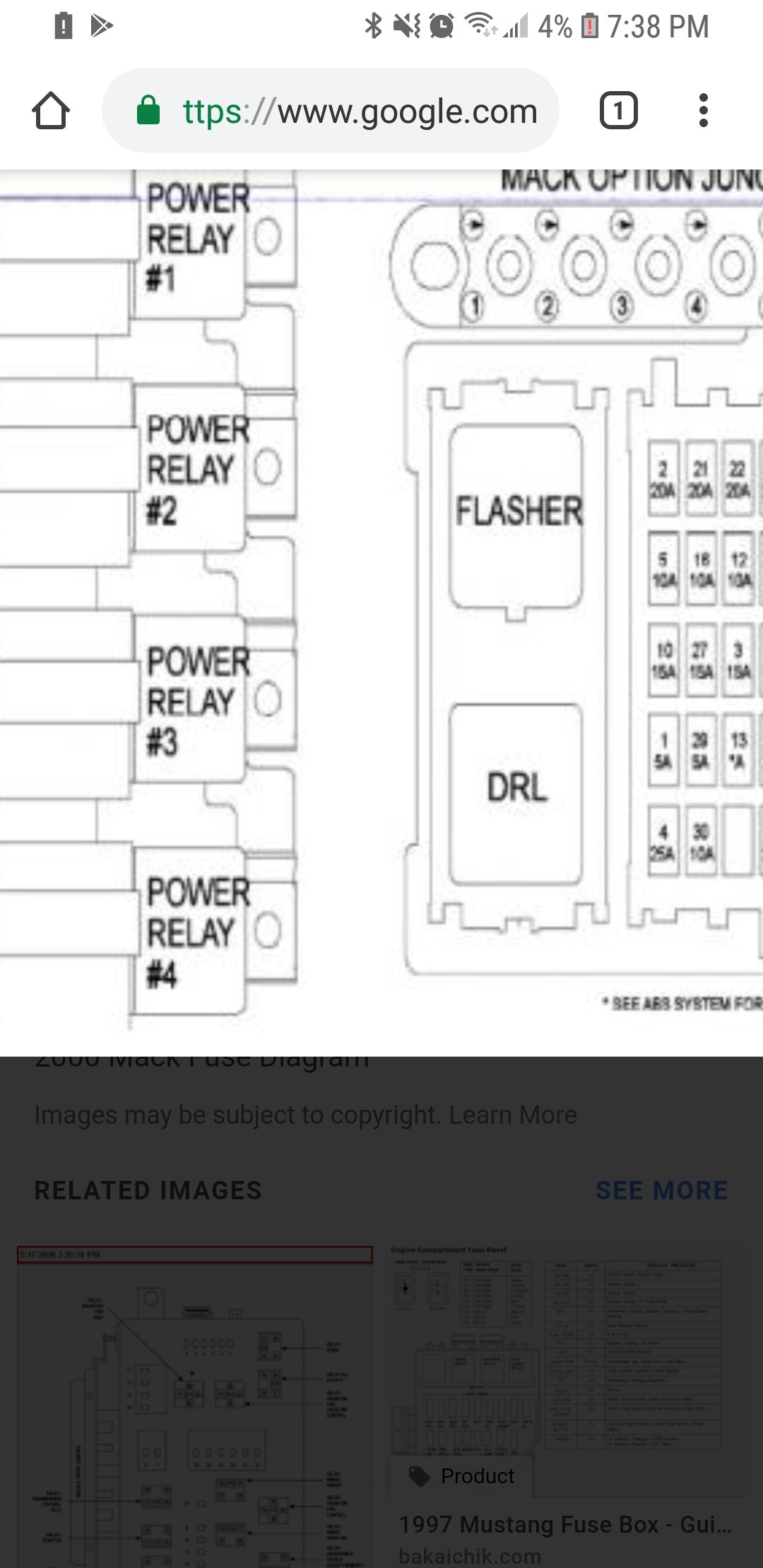

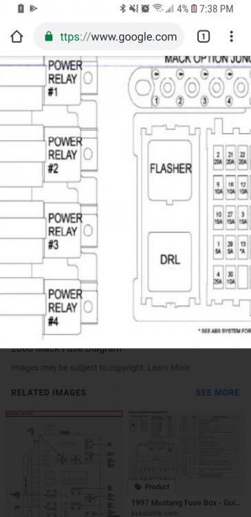

Took passengers side dash off looked everywhere cant find this relay mack said chrome like a ford cant find it ..1 on driver side firewall but they said that's not it..anybody have a picture just for reference that may help me thanks
Just now, fjh said:
accessory relay in the dash under the ash tray
not sure if they changed this in later years  how ever check under that PLASTIC  panel Three screws and your there! They may have changed to 4 relays as pictured above but the location will likely be similar!
I hope so I changed the 3rd relay it had a black burn spot on it..put electric grease on all them .ran 11hrs yesterday no problem so far working it today so far its good..
Thanks for all you guys help
