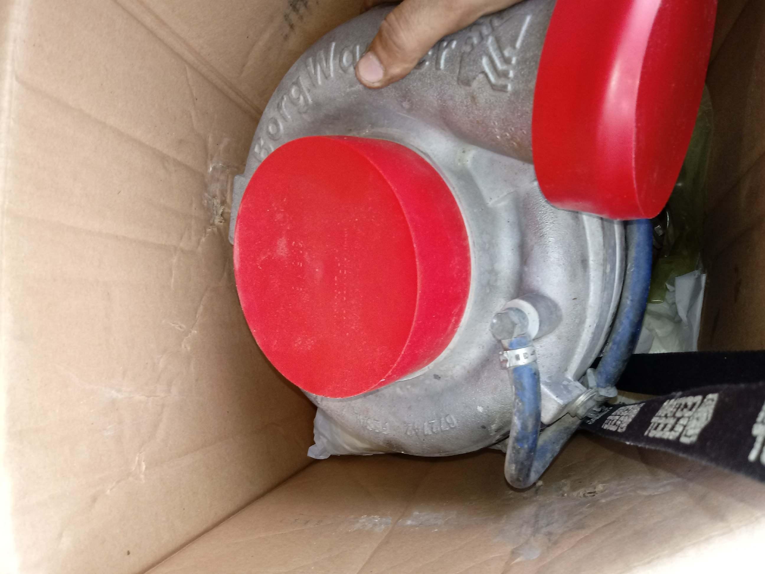

Hello guys,
I began sourcing out parts for my granite in order to change turbo , exhaust manifold and exhaust piping .I just found a good deal on what looks to be a mechanical wasgated Detroit 12.7 turbo that's too good to pass up.i want to know if it'll work good on my granite with upgraded injectors.i know it wouldn't be a direct fit , but as long as the exhaust flange bolts up I can take care of the turbo to intercooler piping.
Thanks
Red

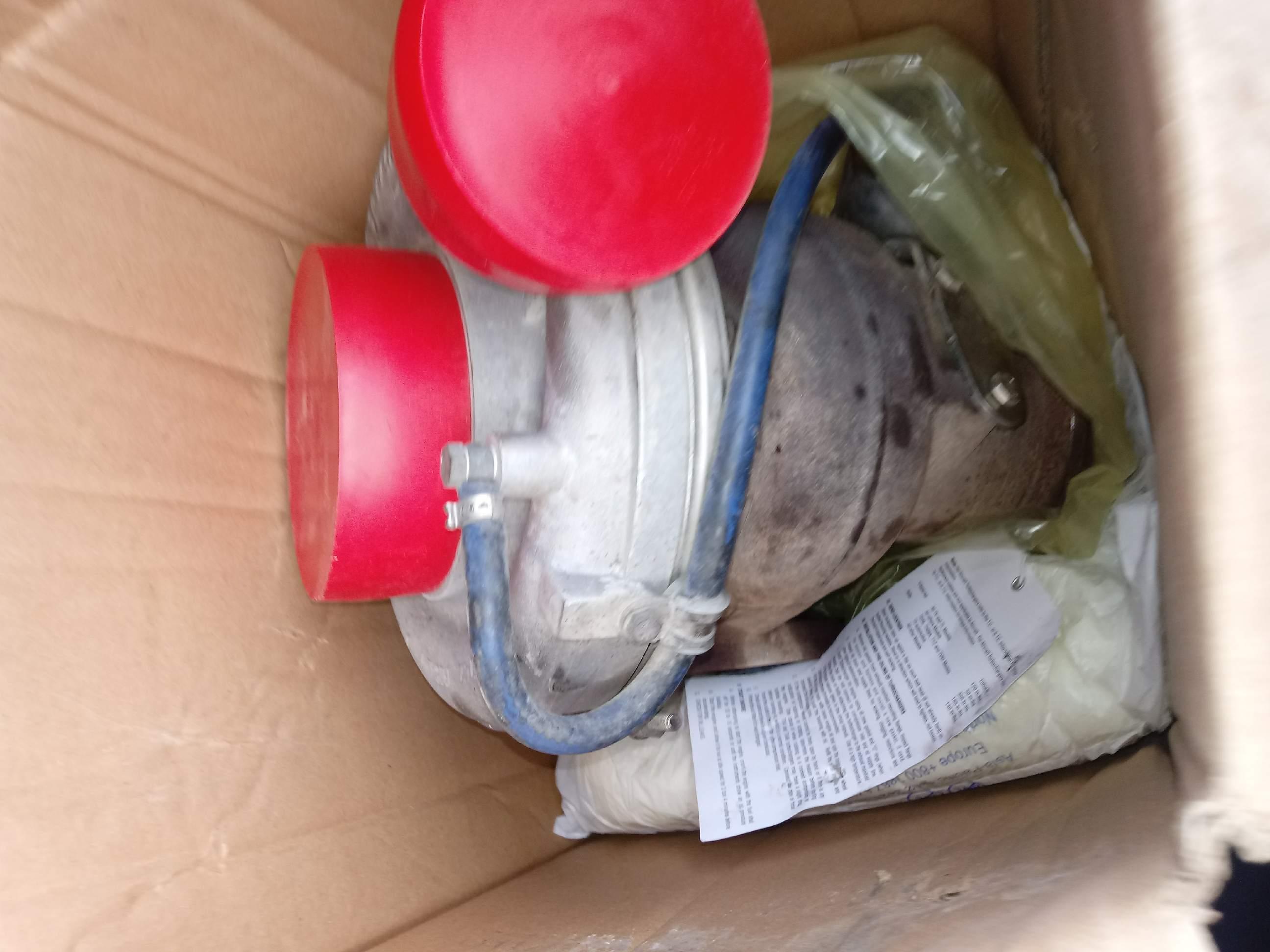

From the research i have done so far , i believe the wastegate is set to 35psi but I will confirm this when I bolts it up and have the vecu upgraded to the step 12b .I ain't looking for crazy horse power or even to tame any kitties , just want the bulldog to act like a bulldog not like the Chihuahua it is now😁
Gotcha and by the way, the wastegate part number you want is 172743. If the one you found online is the 171702 p/n, that is a non waste gate turbo. Get your vecu to 12b , 380P4 , which is for throttle response, won’t do anything for engine power but does help somewhat with tps reaction and if the person that is doing the programming is an older Mack “mechanic “, ask him if he knows Mr. Frank in tech support, if so, he might be able to get them to change the engine files as well. ( I didn’t say that out loud) good luck and keep me posted, just curious on how it helps.

Thank you for your insight.i believe it is a wastegate model (see picture at the beginning of this post) since it has the signal line from the cold side of the turbo to the wastegate actuator.i will post more pics Saturday when I pick it up.
