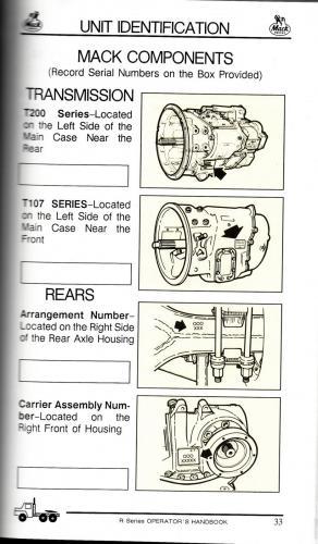

Sorry for the slow reply, been busy!  I went to check the axle ratio and the sticker on the cab is not readable.  Do you know where else the ratio might be located?  I'll have a look for you.  I know sometimes they're stamped on the differential somewhere...but if you can give me a hint that would save me a lot of time...plenty places that number could be!

Sorry it took so long to get back to you. My axle ratio is a 4.17.  And I don’t see a rear support.
