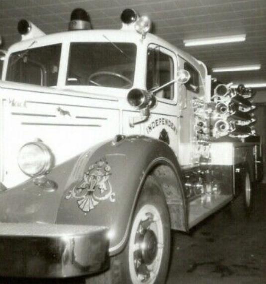

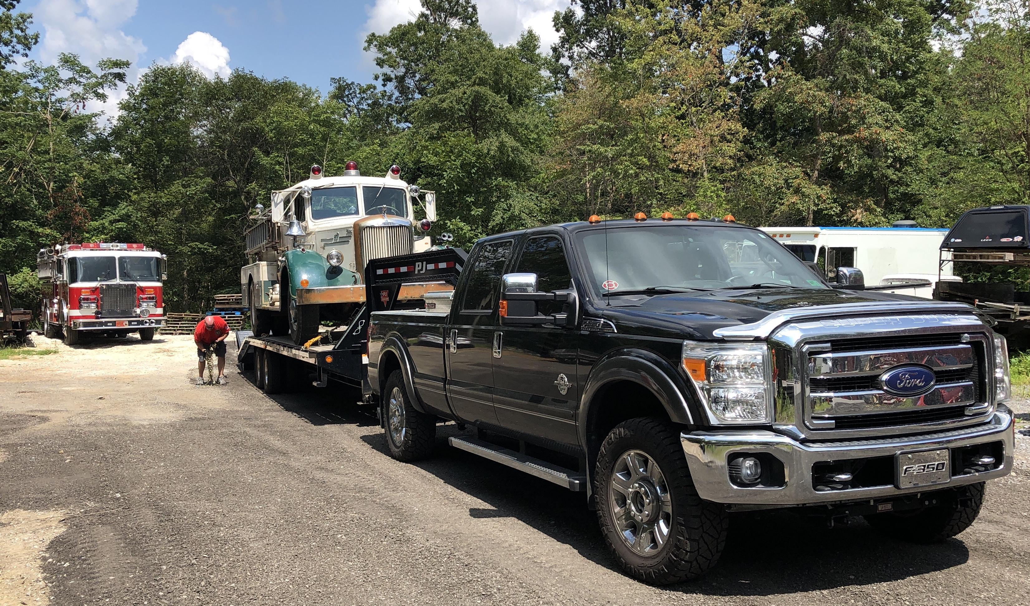

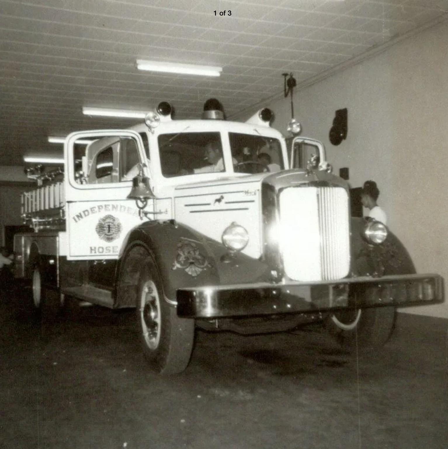

Well as it turns out the truck needs a tune up so it runs nice but it needs to get to the shop for such a tune up, but it needs the tune up to get to the shop. So I’m sure that paradox has baffled many as to how we’re gonna fix it, we’re hoping the local mechanic is willing to either come down and get it or we’re gonna try to call some friends with a flat bed and see if they’ll help get it there. Another reason why we want to get an old semi and a flatbed of our own one day, we just certainly don’t have the funds now... in the mean time thanks to Loadstar I found some old pictures of the truck. This also gives us a good view of the original fleur de le on the fenders.

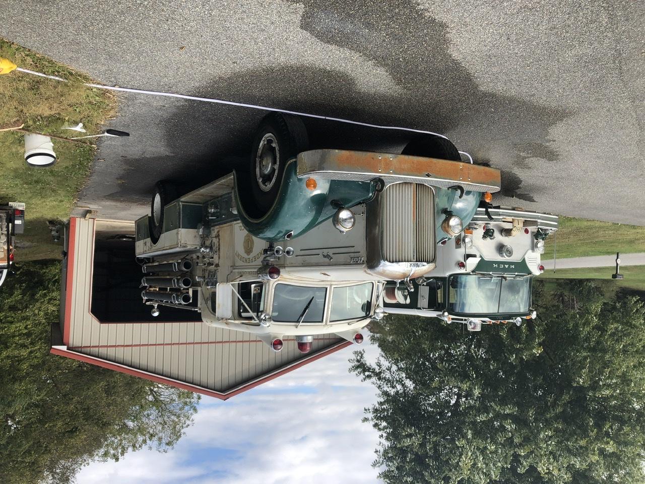

We’re trying to keep it as original as possible, only doing mods in cases like we couldn’t find the right fuel filters so now we have mustang filters which are much easier to get... in fact the company modded the hose bed to accommodate a bigger water tank and we plan on putting it back to the factory look, which luckily Mack took pictures of it before delivery, so we have references to go back to! That’ll be the next big thing but before that we have to get everything mechanically sound and working... the shop gets to work on it tomorrow so pray that it’s nothing major this time!

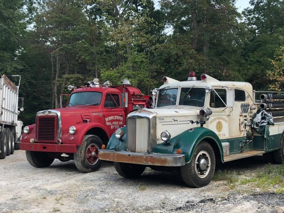

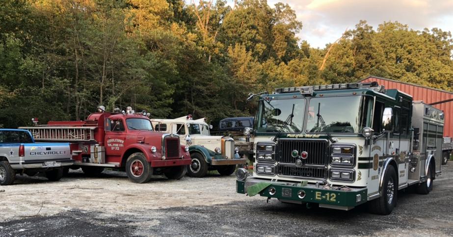

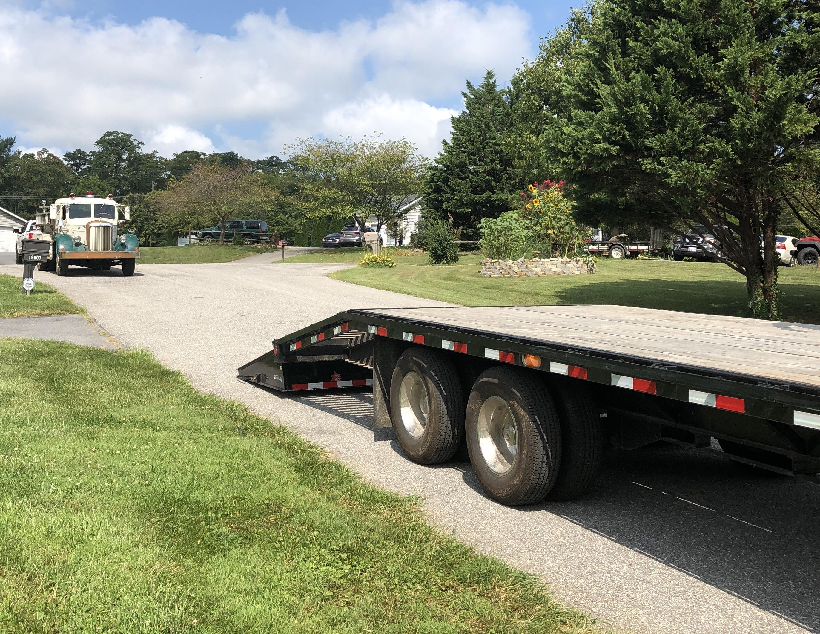

Well the shop discovered the valves were out of tune again but the main problem was the electric fuel pump in the back of the truck quit. Still looking for a replacement but for now we’re trying to bypass it. Next order of business is our main coolant leak is coming from the air compressor where the cab of it leaks, so we’ve got a new one coming in but it’ll take a while, in the mean time we’re getting a replacement just to make it easier to move around... hoping to get her back after that and it’s replacing some pieces of the water pump and some body work, then the cherry on top, a fresh coat of paint to match the original! All of it will happen in due time but we’re excited.

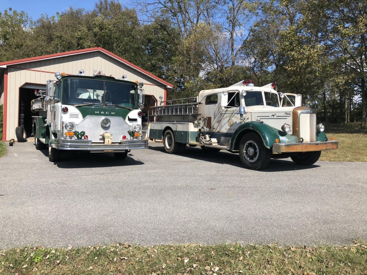

Have a picture of it next to it’s new shop buddy! Not sure who’s it is but they look nice sitting next to eachother...

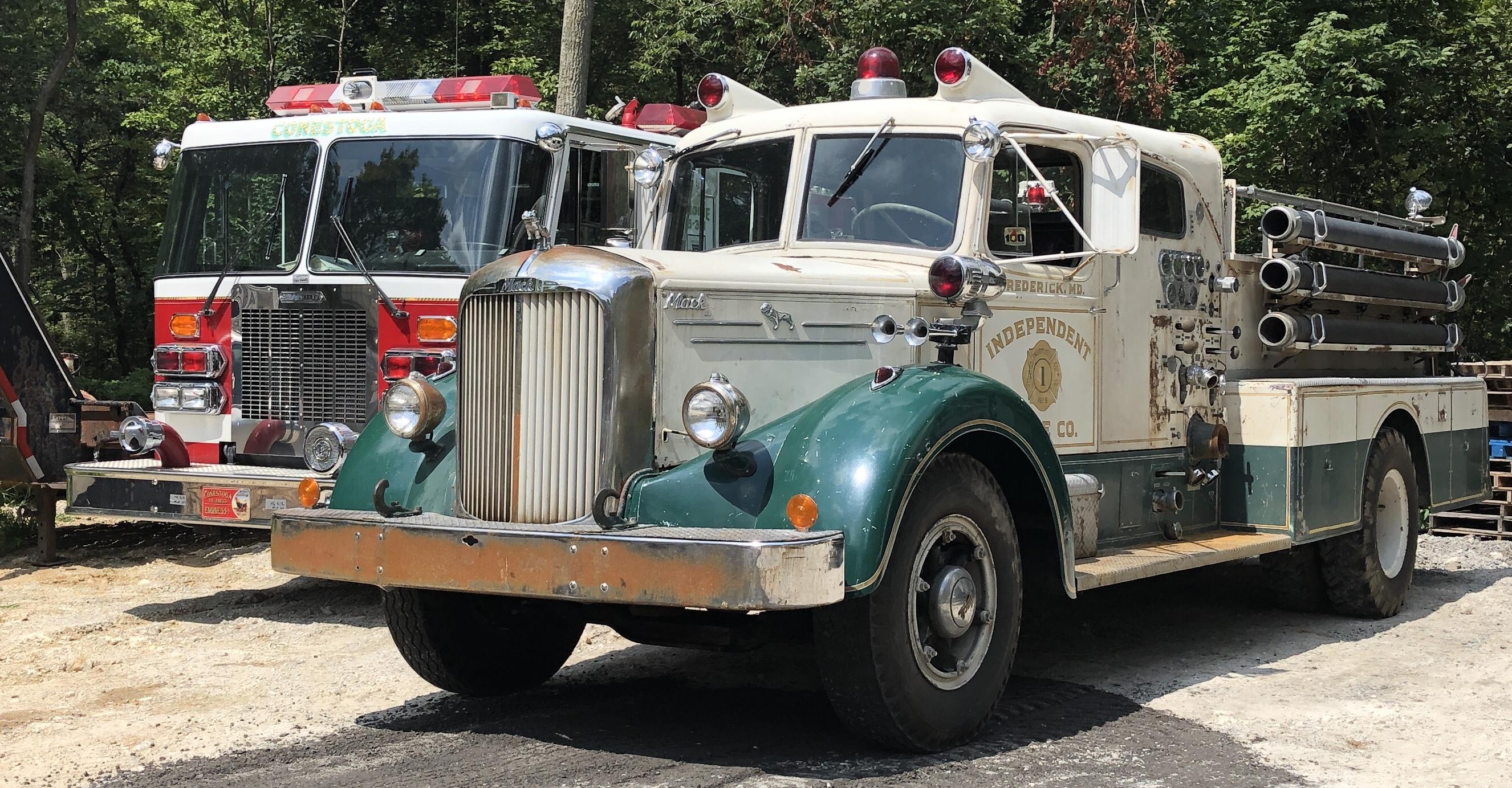

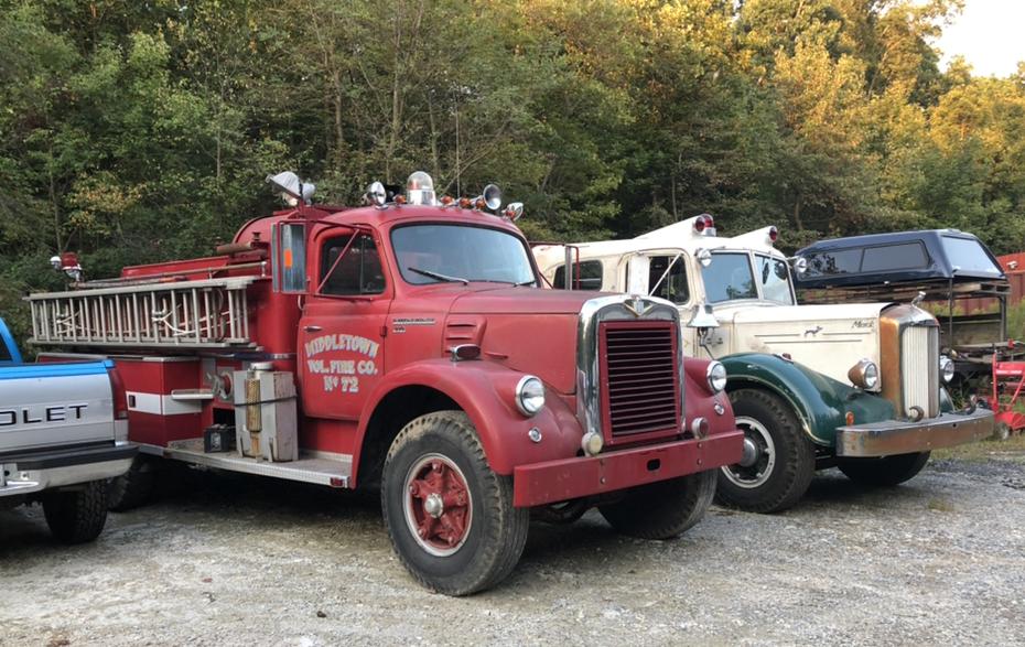

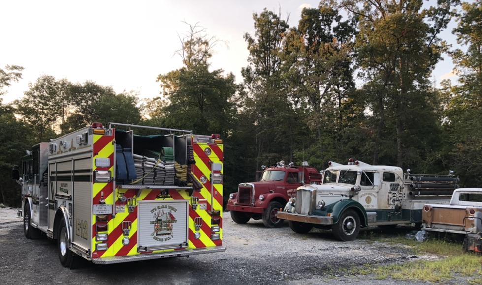

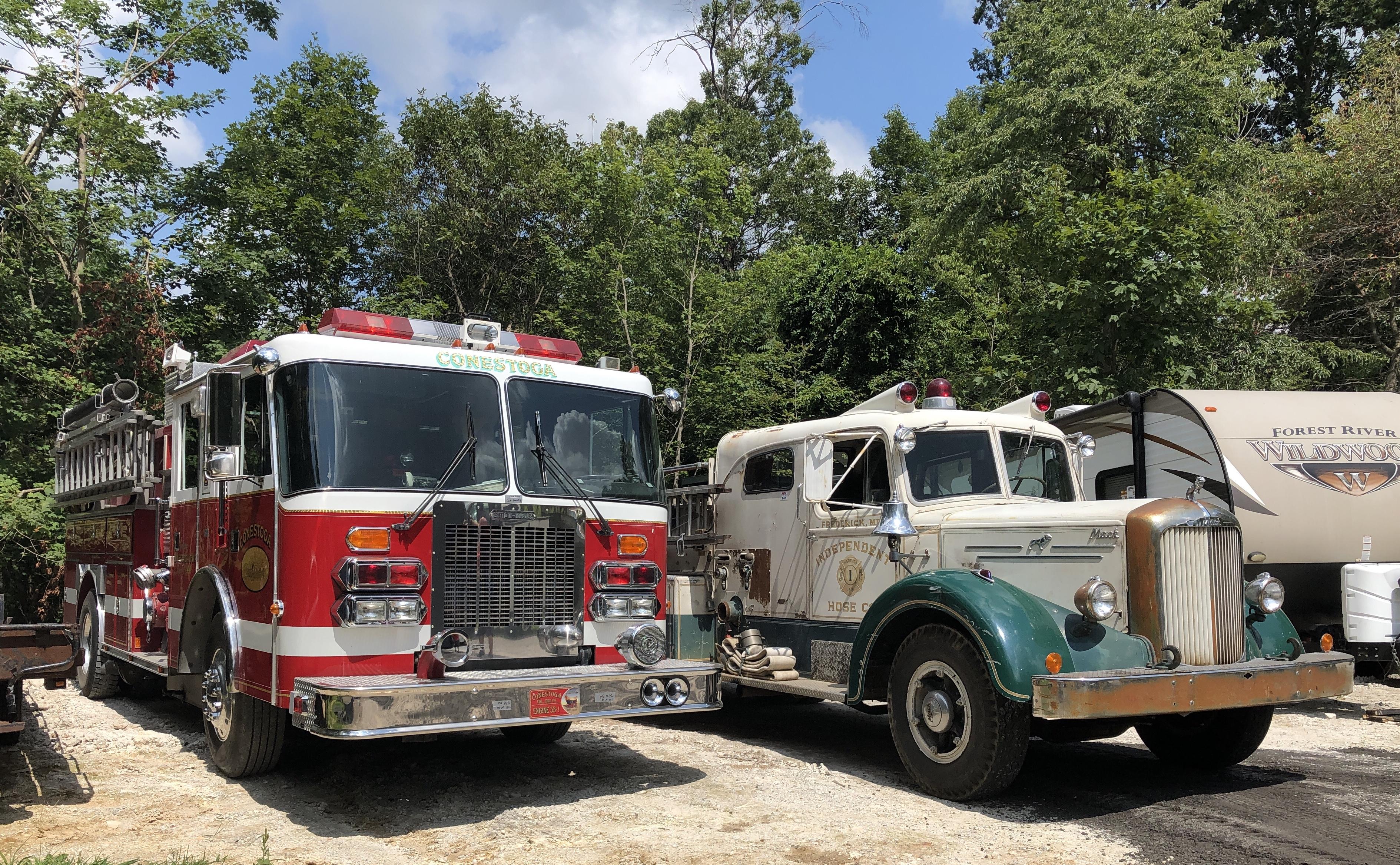

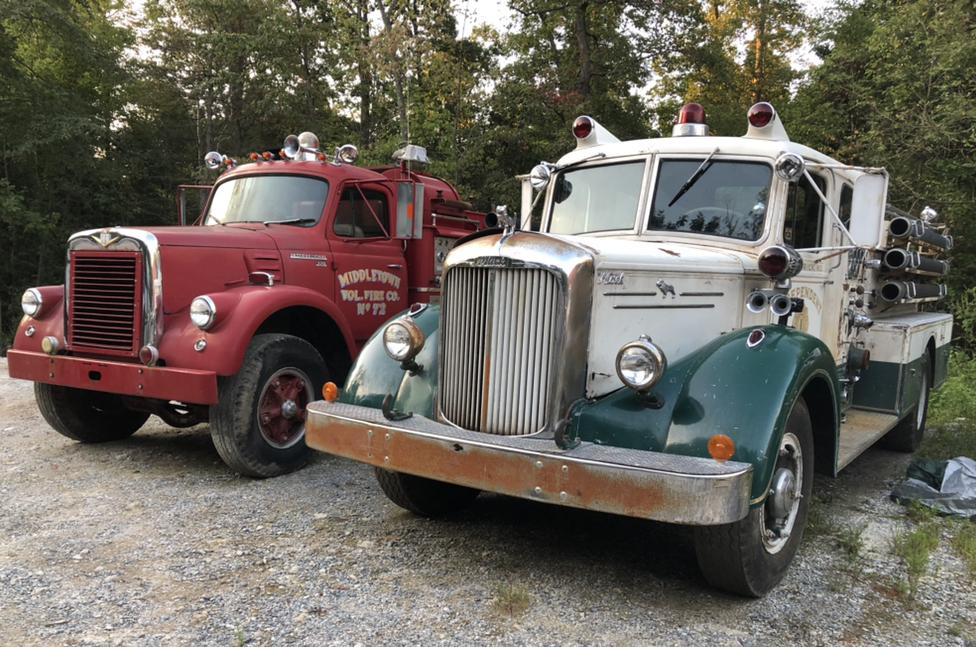

Stopped by the shop today and took some of my own pictures, and her replacement happened to be at the shop aswell... no update yet but enjoy some pictures anyways!

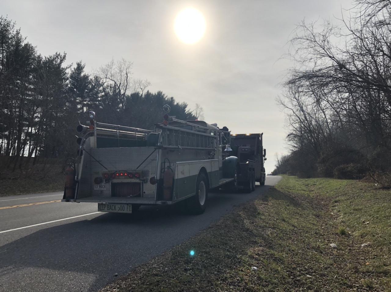

Well bringing it to the firehall for the funeral made us realize she needs to be tuned again, we were going up South Mountain at 15 MPH back firing like crazy the whole way, so on the way back home we dropped her back off at the shop she's been spending a whole lot of time at lately, and then the day of the funeral the CF, which has never had any problems starting, refused to fire up after an hour and a half of trying. She tuned over just fine but it seemed like she wasn't getting fuel... If anyone has any clues on what that could be let me know. It's a shame that right after my grandpa passed both his dogs are now sick...

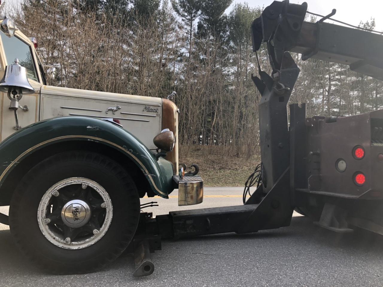

Took her stranding us on the side of the road to realize who we needed to call so she’ll run right... after a carb rebuild and just about everything we can think of she’s going to place we know specializes in old Macks and will put her back on the road... it’s just a shame it took us so long to figure that out...

$400 later and she’s in pretty good hands, these guys have actually worked on similar truck before, a few Bs with 707s, so I'm confident she’s in better hands now...
