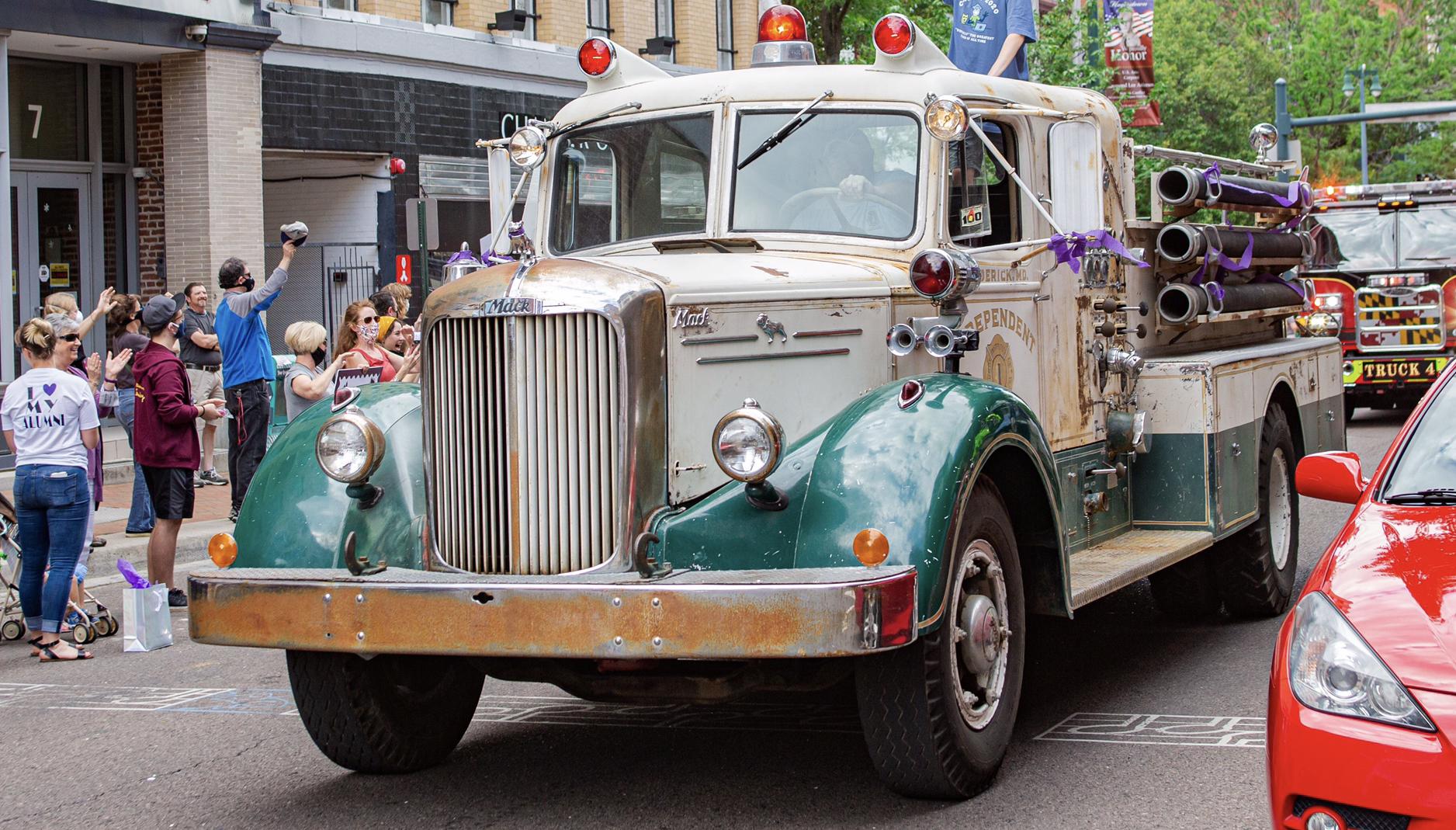

Beautiful looking Fire truck.  I posted some new pictures under '49 EE taking a break. check out the fire truck from the '82 truck races in NJ.  it was a demonstrator  for the company. guess people got scared driving up to it on highway thinking it was coming at them LOL.

lol i can see rite thru that glass,,,,and it looks like your pissing yourself...truck looks great,have a swinging time with it,,,the way that thing is setup with all that chrome,im thinking it would look amazing with fresh paint..oooooh i also like the blue jeans.....bob

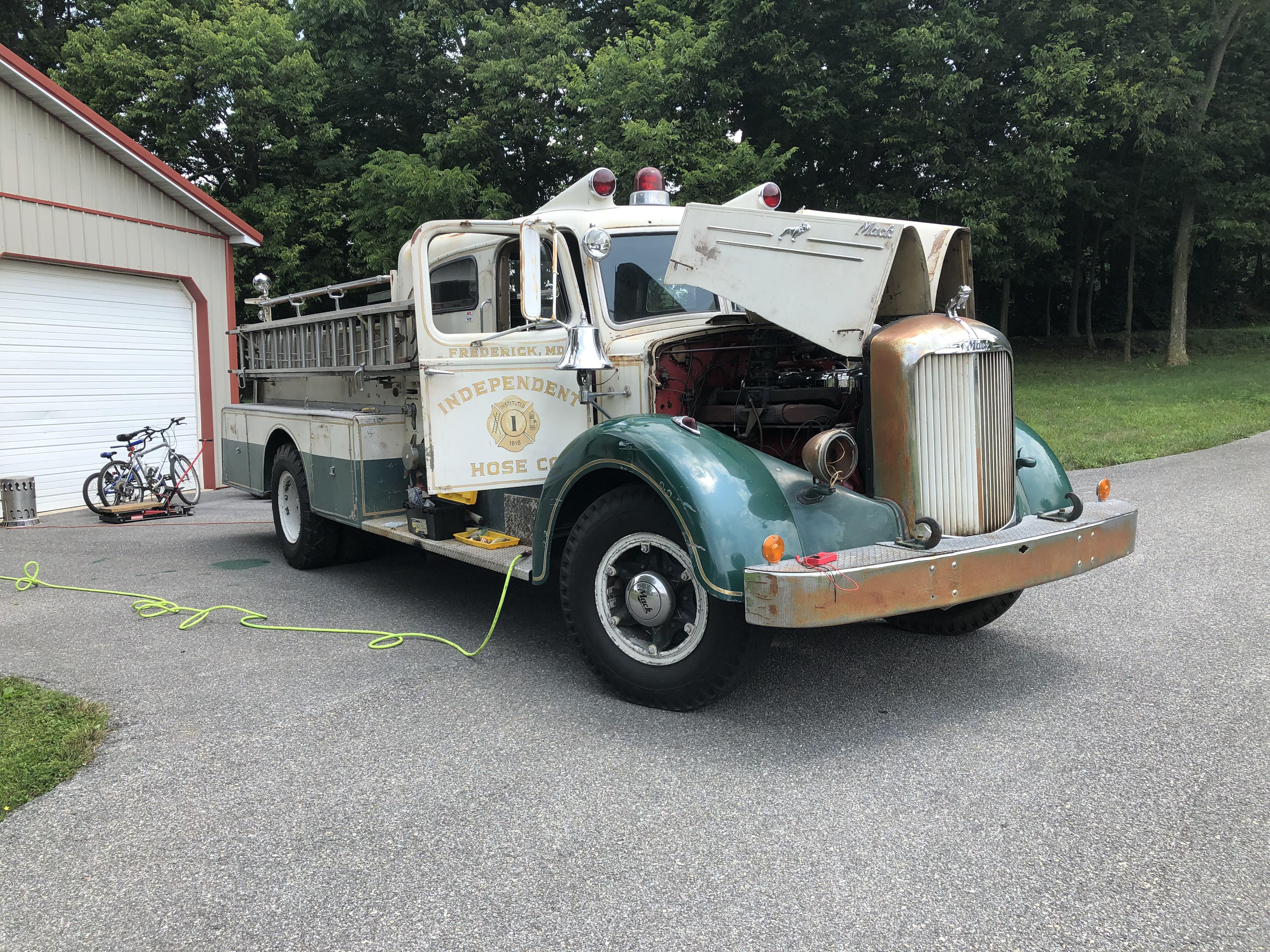

Went to take the truck out of the barn last week, and she just didn’t want to go for very long… started looking at the fuel lines and sure enough the line going into the mechanical pump is kinked. We’ve had to go to a few places now to find someone with both fittings to remake the little thing. And we know that’s the whole problem because when you bend the line back into shape the truck ran just fine. Hoping to have both of the truck out for a local 9/11 event we were invited to, so there’s that to look forward to!

The real issue with it kinking was the line was a little too long to begin with, long enough we could wrap it in a loop and it still worked. The new shorter line shouldn’t be able to kink because it won’t have to bend that much.
