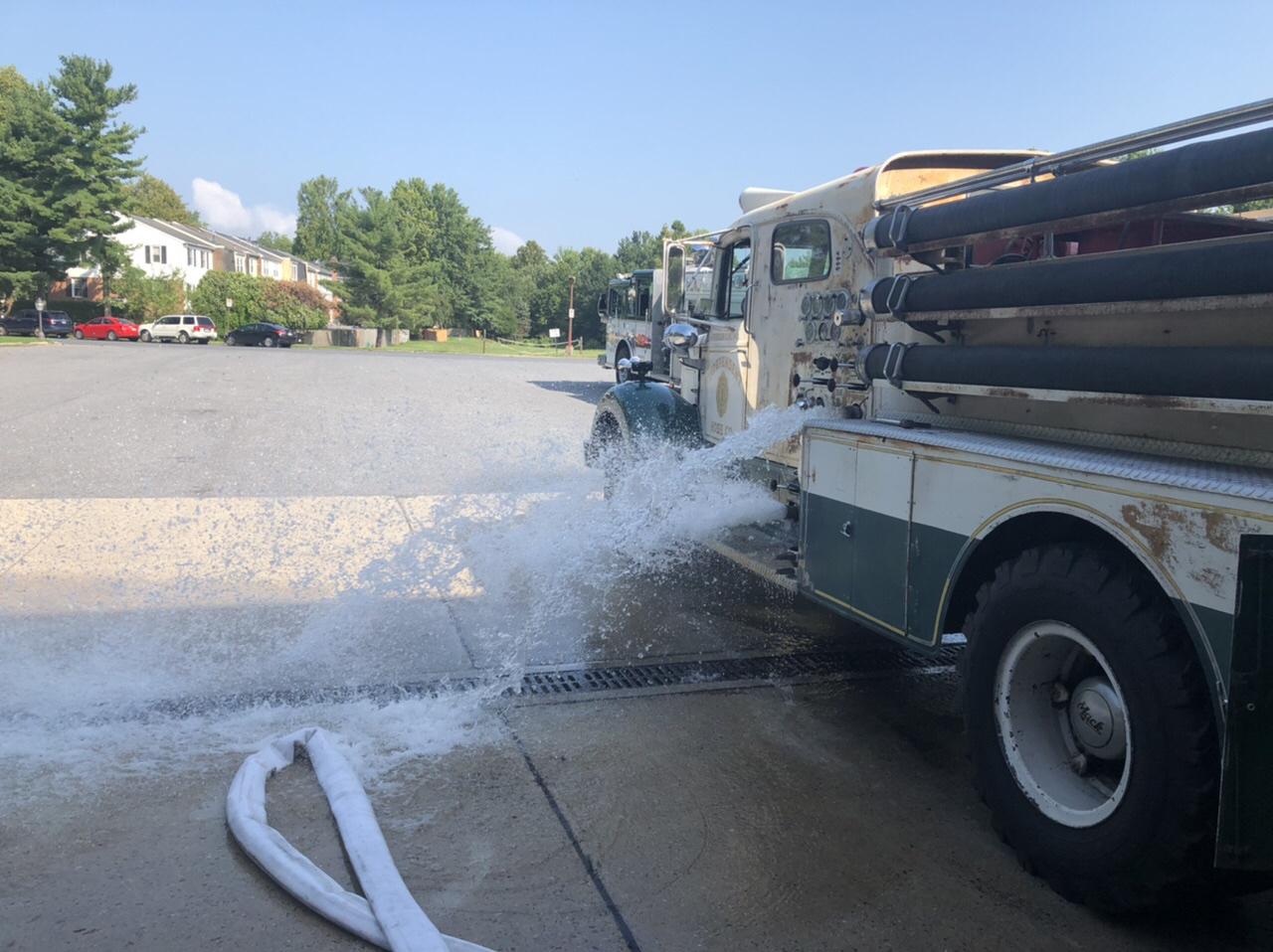

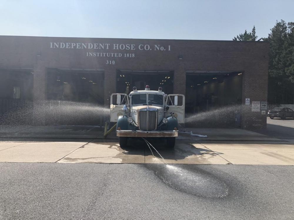

personally i would just replace it.....its most likely full of rust,and perhaps paper thin anyway at the bottom,,,because of the age.....love the photos...that truck never gets tiring,love it...and atleast yours is registered and driveable...lol.bob
