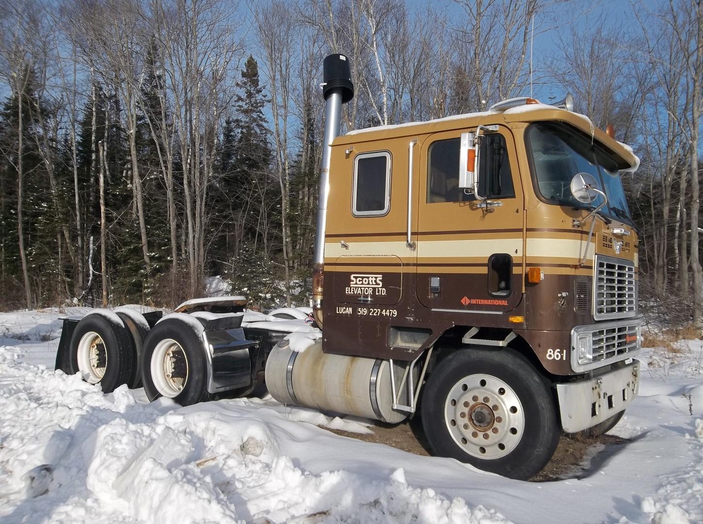

3 hours ago, Bullheaded said:
Solved my emissions issues. Just got home from picking up my new ride. I forgot how glorious mechanical motors are to drive!
So between this and the 2013 Star, I know which one I'll be using most.
Just gotta do a bit of body work where it has been dented in a few spots, some paint and good to go. Plastic wrap is still over all the interior, never been taken off. All the headliner, bunk walls, etc. Only the driver seat bottom cushion and the steering wheel are wore.
Nice looking truck, how about some more pics and specs?
