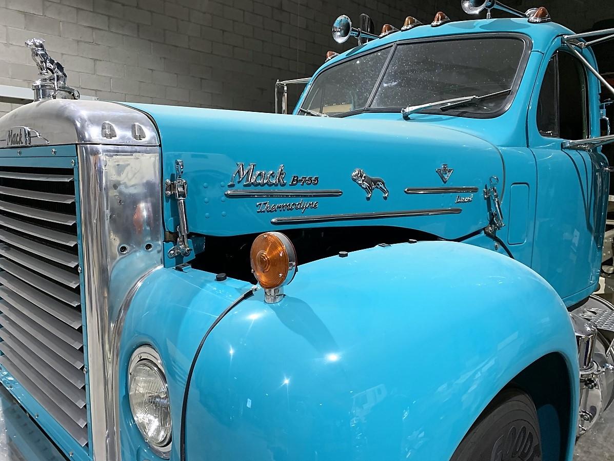

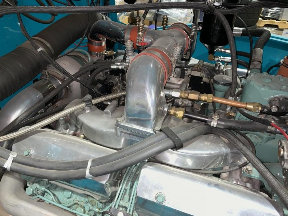

This is my 1965 B-755 that came with a normally aspirated 864. They were not good engines and forget about parts so when the truck was restored I put in a rebuilt 375HP 866 V8 single turbo that I could get parts for back then. So there are at least 2 B's with Turbo V8's around. I really wanted to put a E9-500 in but the Quadbox still in the truck would not have survived for long. Engine color is right for 1965 V8 but originally a Silver engine.
AZB, those polished aluminum pieces on your engine look great. When my truck grows up, I want the engine to look just like yours!
Thanks, The polished stuff would not have look as good on a silver engine that it started out as. 866 V-8's where silver in the early 70's and that is what I started with. Gold color was on the 865's
All it takes is time here and there, files, sandpaper, polish and a BLACK hands from aluminum grit and polish. It did not happen over night but over a year or two. Man the casting to start with are not good quality, you can see definite differences in color within a valve covers and radiator. Must have been the filler scrap aluminum they melted into the mix when cast.
I had some small pieces parts for an ENDT-866 powder coated aluminum finish and they look very close to polished aluminum parts, but they'll stay looking like that without maintenance. I may do the rocker covers and intake plenums too, but haven't looked into the cost yet.

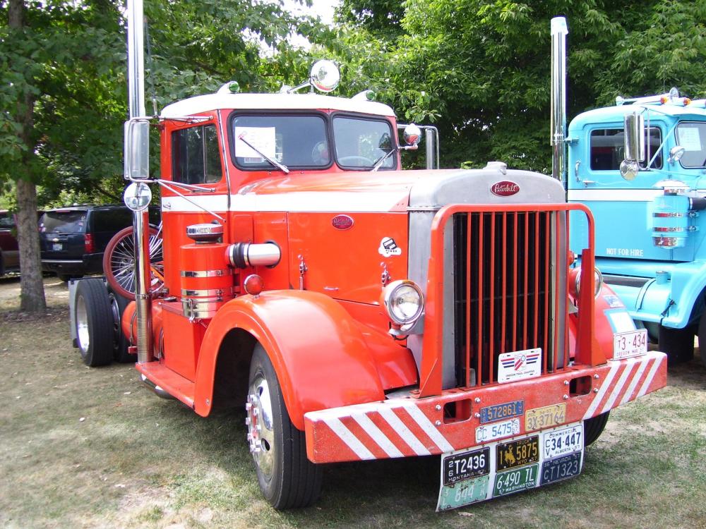

 That Pete has a Iron lung on it.
On 1/18/2019 at 9:36 PM, Freightrain said:
But there is something about those old supercharged Cummins.  They do sound GOOD!!!
Edited by Truck Shop
One ping only
34 minutes ago, Truck Shop said:
That Pete has a 300 Iron lung
Just observing but did this post to the wrong thread? We are taking about B-7X Mack's here not Pete's? Is this related to a Supercharged HNRS in a B-77 Mack? By the way this engine is my second favorite behind an E9, so much so I got one in a 53 LTL. No disrespect.
Yup,. I like the sound from them.
The Pete came up because I commented about liking the sound of the old Cummins and I found that video to let everyone hear it..  I like Mack's, but also the old supercharged Cummins.  That's all.
