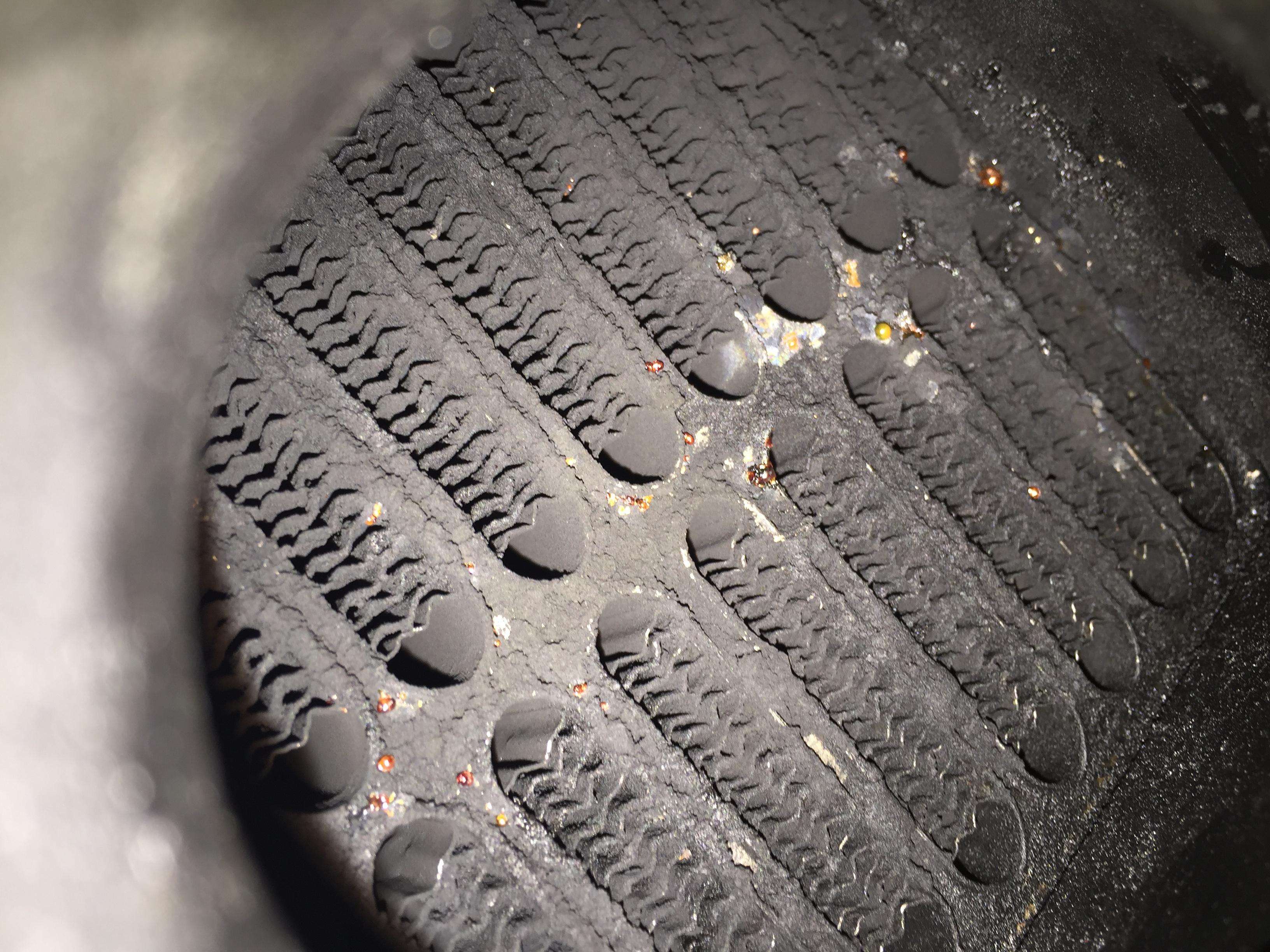

Ok I pulled the cooler because I seen what looks like tiny red droplets of coolant and the inside of the housing is damp and sooty. I’m not sure if what appears to be red droplets is coolant. What do y’all think? You may need to blow up the pic to see

ok the cooler took care of the one I posed the pick of. The next one has a new cooler and compressor. I guess someone else has been
