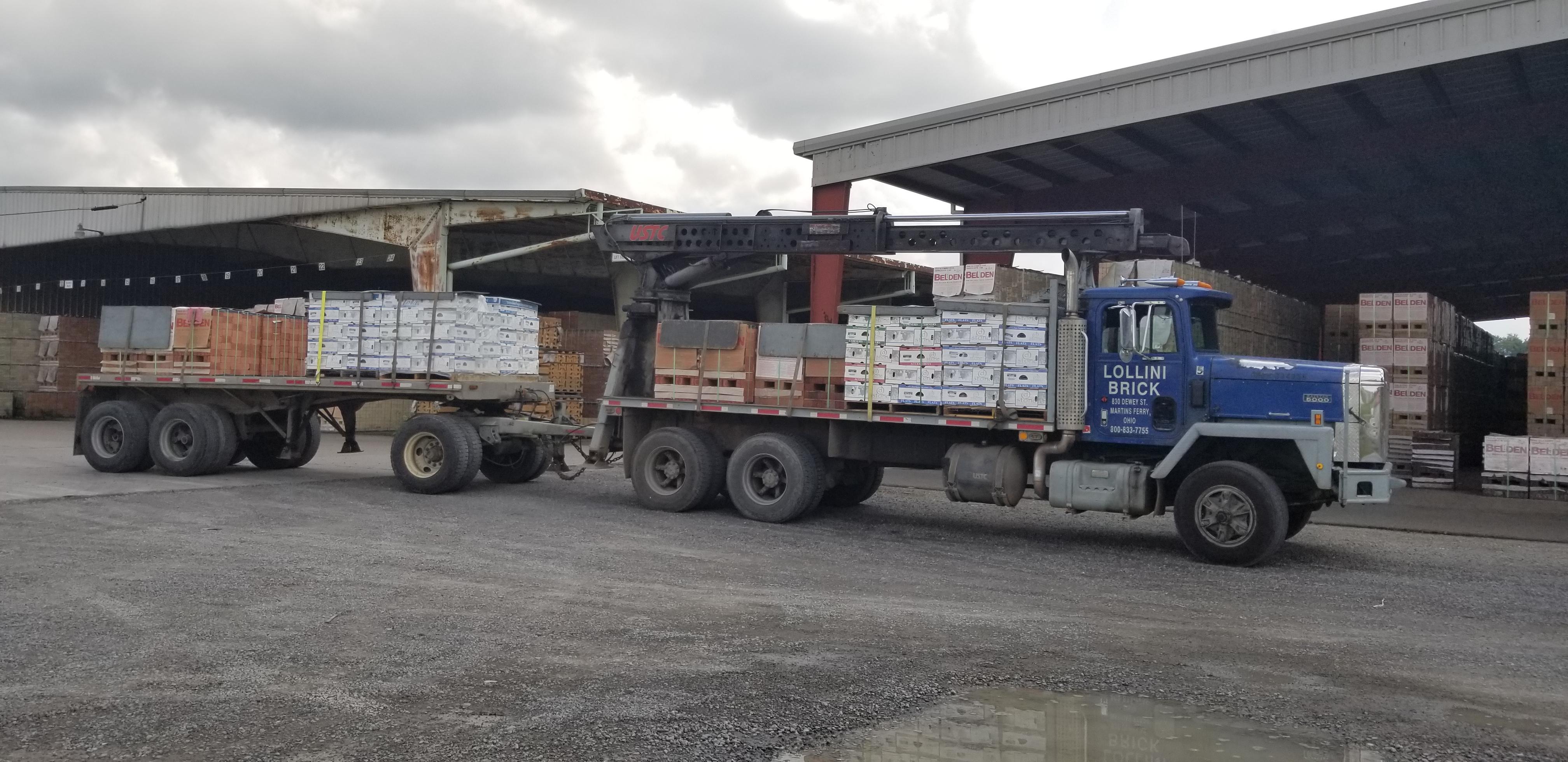

I have been pulling pup trailers for over 40 years and love how they follow my tandem flatbed boom truck. We haul brick and stone with a 1987 Mack RD and an 1990 International Paystar 5000. Trucks empty are 30,000 and the pup weighs around 10,000. So we are 40,000 empty. Years ago we would go up to 60,000 but now we try to stay under 50,000. My main problem is now with my age and weight and the pup trailer so high that it is getting hard to tie down. My friend has a Eager Beaver 20 ton lowboy for sale the deck is 34 in off the ground vs my trailer which is almost 60 ins. His trailer is about 8,000 lbs. My trailer is 27 feet total with tongue his is 31 feet. Lighter but longer easier to back up but will not follow as well as my old 1971 Ravens. I do not see to many guys haul freight on lowboys but do not see why you could not. We only pull the pup about once a week to go to the brick plant or make a far off delivery. Local deliveries are made with just a straight truck. I also own a John Deere 310D backhoe which is mostly for personal use but it would be nice to have a way to move it. Also my pintle hitch is 34 in off the ground but I think his hook could be adjusted up or we fab it. I am going to start carrying a ladder with me but I do not want to fall so I fill the low deck would be safer. I am thinking wrong here. The wheel base on our trucks is 237 in so I am also going to be pretty long with that setup. Another issue would be tongue weight. With the pup trailer there is no weight on the tongue. Any thoughts on this setup? Thanks

We always wanted a tractor in our small fleet. It would not be real practical having another truck around and only using it once a week though. I would love a tractor with a drop deck trailer, perfect for an older driver. Here is a pic of some of the loads we have to tie down.

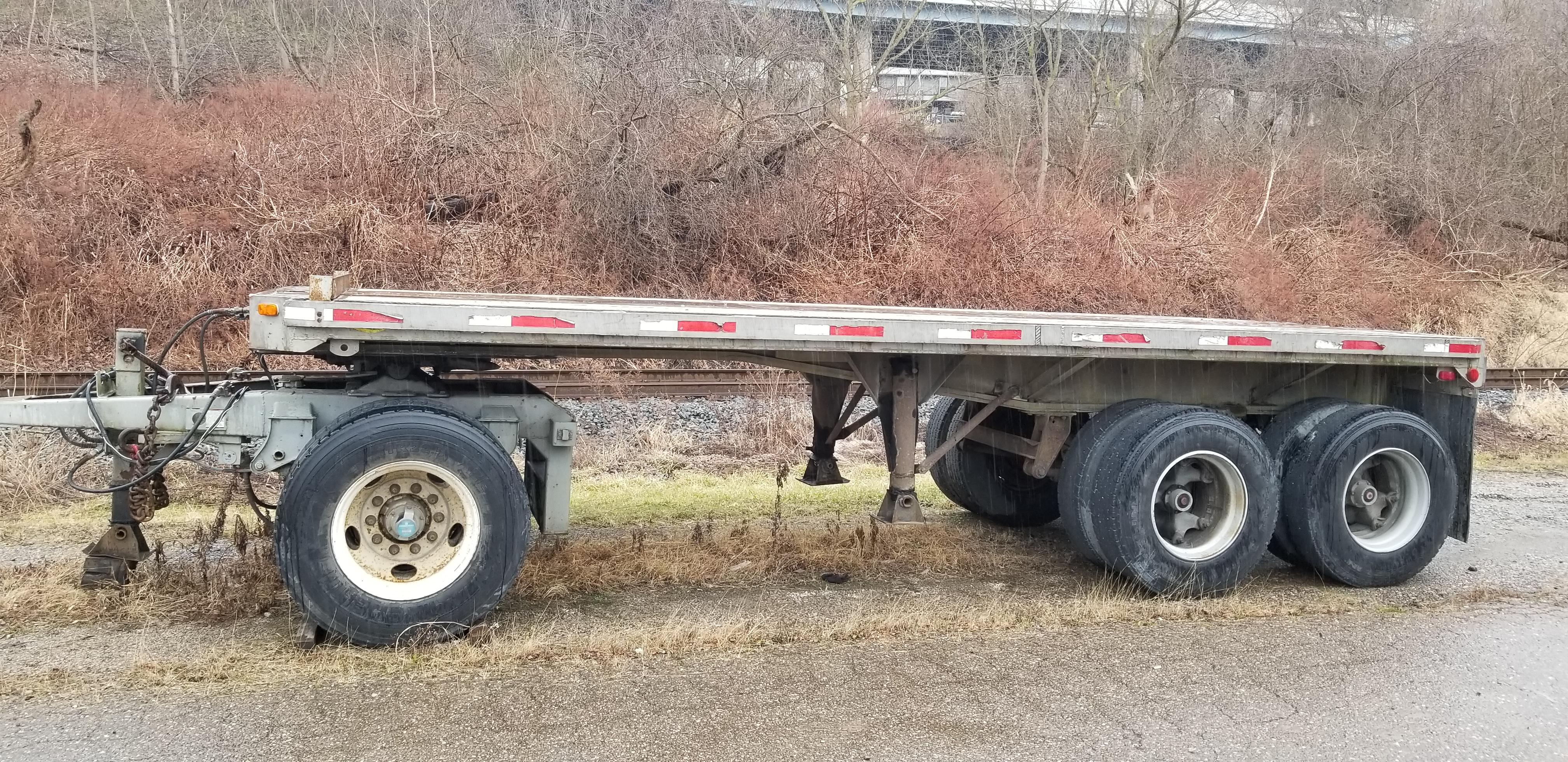

Your current setup is a short fifth wheel trailer and a dolly. You could probably lower the deck height by 6" or more by using a turntable trailer.
Do you really need a three axle trailer?

1 hour ago, 1965 said:
Curious; what’s bad about the pintle hitch trailers?
you can`t turn em tight` can`t keep tires on em  because if you have to get on brakes hard you flat spot tires`  single landing gear sinks when loaded `  are a real pain for one person to hookup` single gear usualy won`t lift tongue if dropped loaded or bump it a little to hard and collapse the gear` plus lots more reasons( i )don`t like em                 this is one more reason not to like          though not involved
Edited by carlotpilot
Gotcha; my deal is different, thought pintle hook would be better than the goose neck were using on a 4500 truck. Goose neck a pain to hook too, but you can turn sharp

Thanks everyone lots of good advice here. We put a hook on a stick for me and the other driver about a year ago to grab things off the bed without climbing. I will buy two of the tridents with the sideboards,  did not know about them. I am going to start carrying a 6 ft. fiberglass ladder with me from now on when I go to the plants. We do not need a three axle trailer it is just what we have. My dad and I bought that trailer over 30 years ago for $2500.00. Before that we had a 1952 and a 1953 Trailmobile  two axle trailer with the turn tables. Those were nice old trailers and they had a spring mounted locking pin to make it easier to back up. The trailer has reyco single leaf springs on it. The dolley is newer I think it is a Greatdane but also has the reyco system. I am 6'2 280lbs and not as strong as I used to be. The real solution here is for me to stop drinking beer and lose 80lbs. Anyway thanks for the help, this is a very friendly forum. Randy
