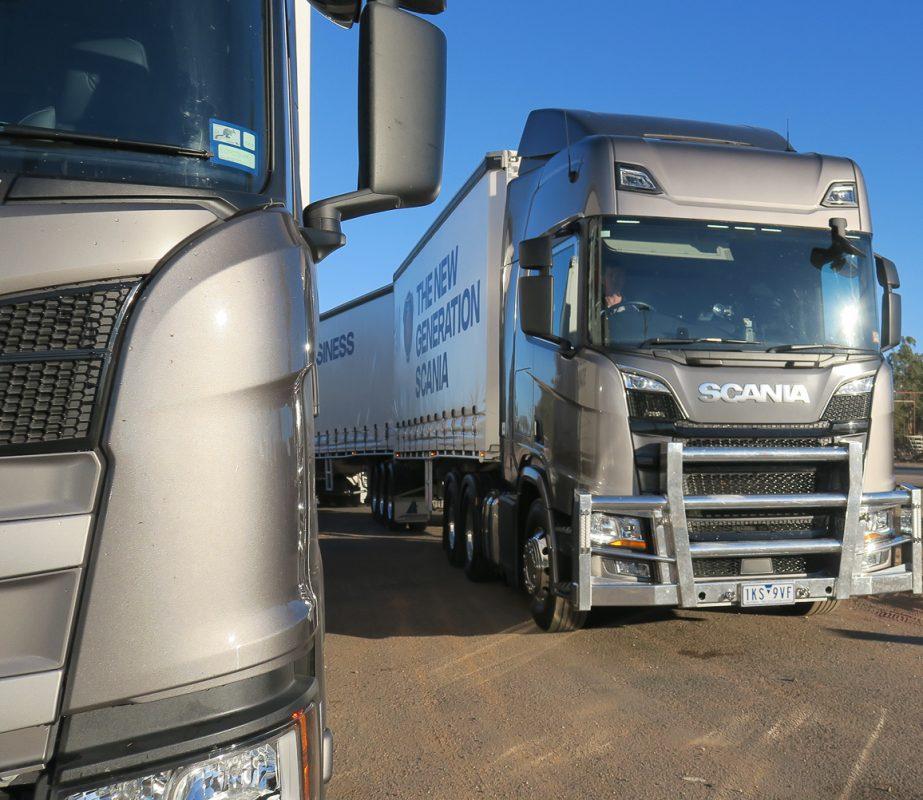

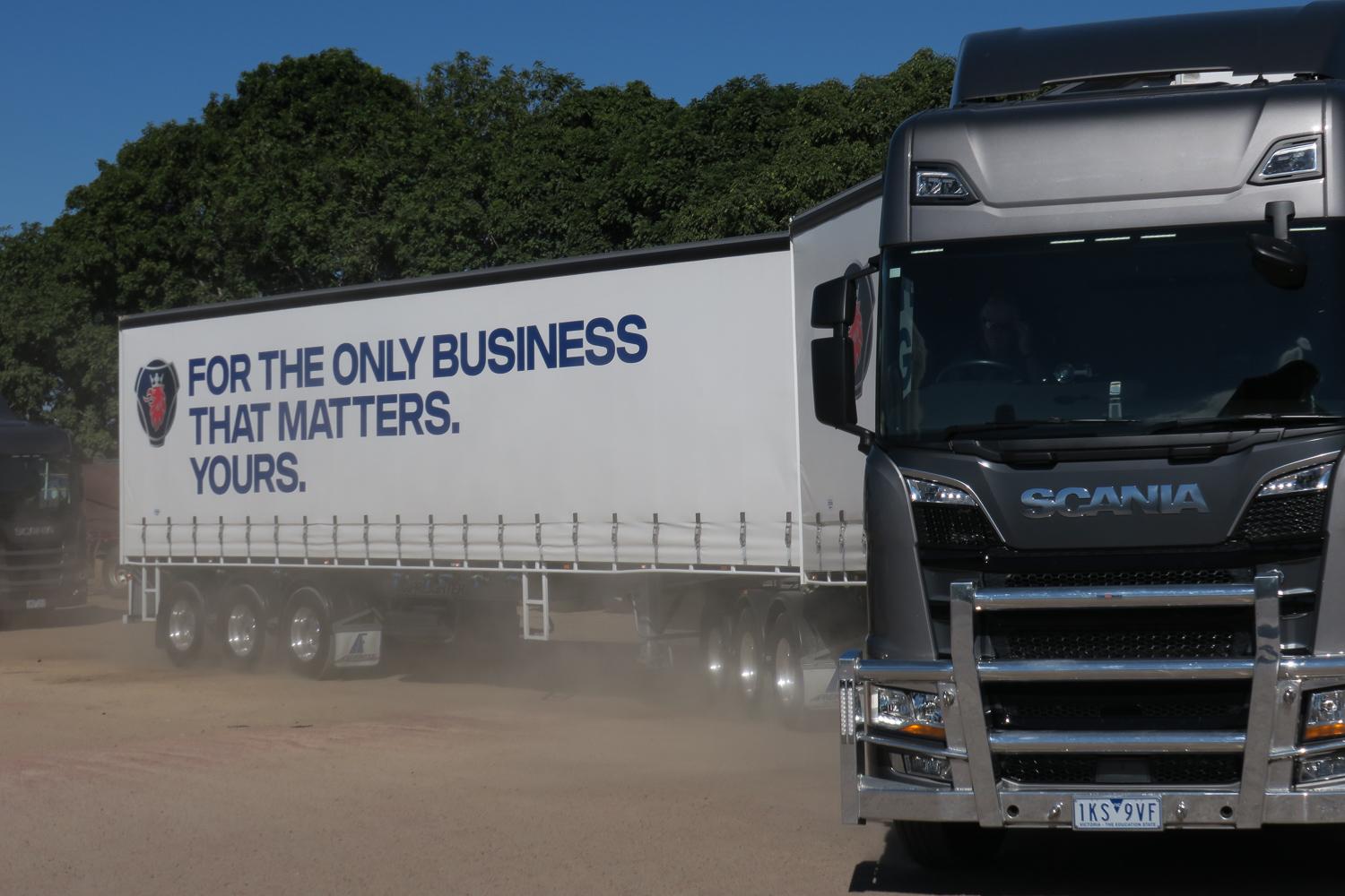

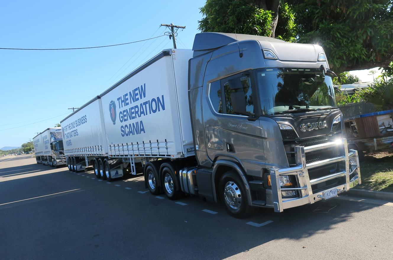

This test drive included two trucks, the 620hp fitted with a V8 engine and a 500hp running the 13-litre in-line six engine. These are both prime movers which are likely to pull B-doubles. The 620 can expect to work this hard day-in-day-out, but the 500 is more likely to pull a variety of combinations, including a B double.
