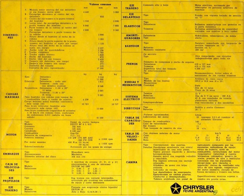

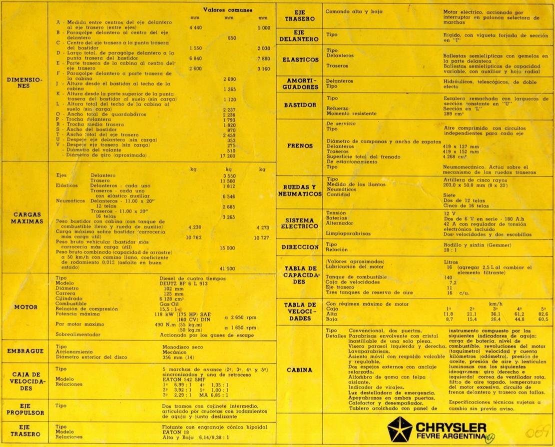

Dodge DD-1000 / Specifications
Chassis: riveted ladder with "U" section stringers.
Reinforcement: "L" section.
Bodywork: truck on frame, two-door
Engine: Deutz BF6L913, lateral camshaft controlled by gears.
Cycle: Diesel 4-stroke, valves at the head
Feeding: turbocharged, turbo-cooled.
Cylinders: 6 in line.
Displacement (cm3): 6128
Diameter x Stroke (mm): 102 x 125.
Power (HP-SAE): 175 to 2,650 rpm
Torque: 50 Kgm at 1,600 rpm
Compression ratio: 18: 1.
Fuel system: direct injection
Injector pump: commanded by gears to the camshaft.
Transmission: 4 × 2 to the rear wheels by tubular cardan.
Clutch: Mechanically driven dry monodisk, diameter 330mm (13 ").
Gearbox: EATON 542 SMF
Speeds: 5 forward (synchronized from 2nd to 5th), and
1 of recoil.
Rear axle: floating with hypoidal conical gear.
Capacity: 11460 Kg.
Differential: Eaton 18, 2-speed electro-pneumatic drive.
Ratio: 6.14 / 8.38.
Front suspension: semi-elliptic leaf springs with binoculars, double-acting telescopic hydraulic shock absorbers.
Rear suspension: semi-elliptic springs of variable capacity with auxiliary load and radial blade.
Brakes: Air, independent circuit for each axis, drum in the 4 masses by "S" cams, rear with self-adjustable "guitars".
Parking brake: Pneumatic drive by valve from the board.
Direction: Screw and endless, semi-reversible.
Optional: Hydraulically assisted.
Tires: 5-spoke gunners, 8J x 20 ".
Tires: 11.00 × 20 ".
Gas-Oil tank: 140 liters.
PBC (tow cap) at 50 km / h: 41500
Between axes (mm): 4440/5000
