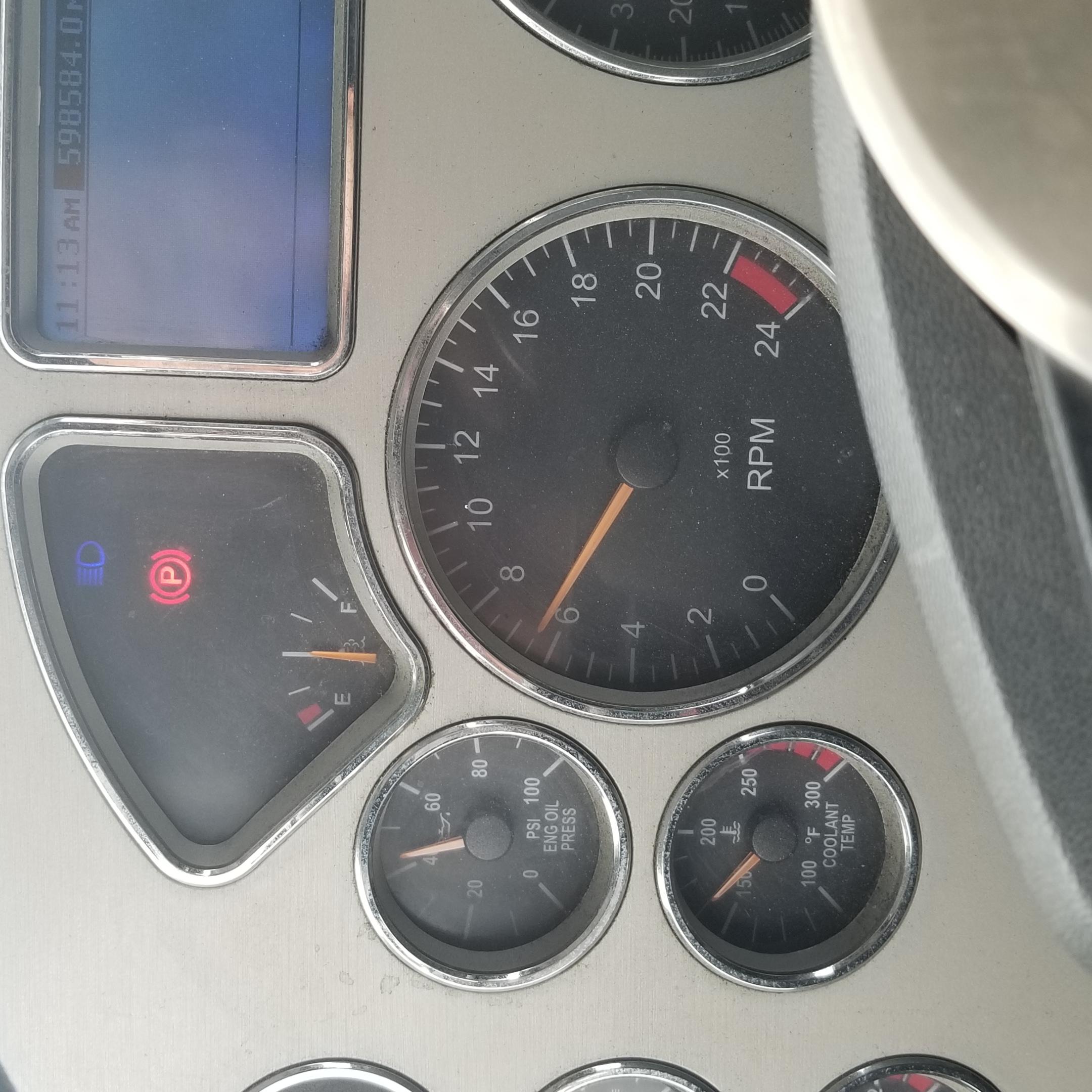

The clicking sound leads me to lean towards a relay. Try swapping a couple of them and see if that fixes the problem. If it does replace the bad relay.
Check your EPDM for corrosion.  The epdm is the fuse box behind the clutch pedal or where the clutch pedal would be.  The windshields would leak and water runs all over the epdm causing corrosion.  Pull a few relays out and check them.
Mack added a little rain coat to the epdm to keep water away.  But I still see the with corrosion
Had a truck where one headlight would turn on when the truck was sitting in the rain over night.
