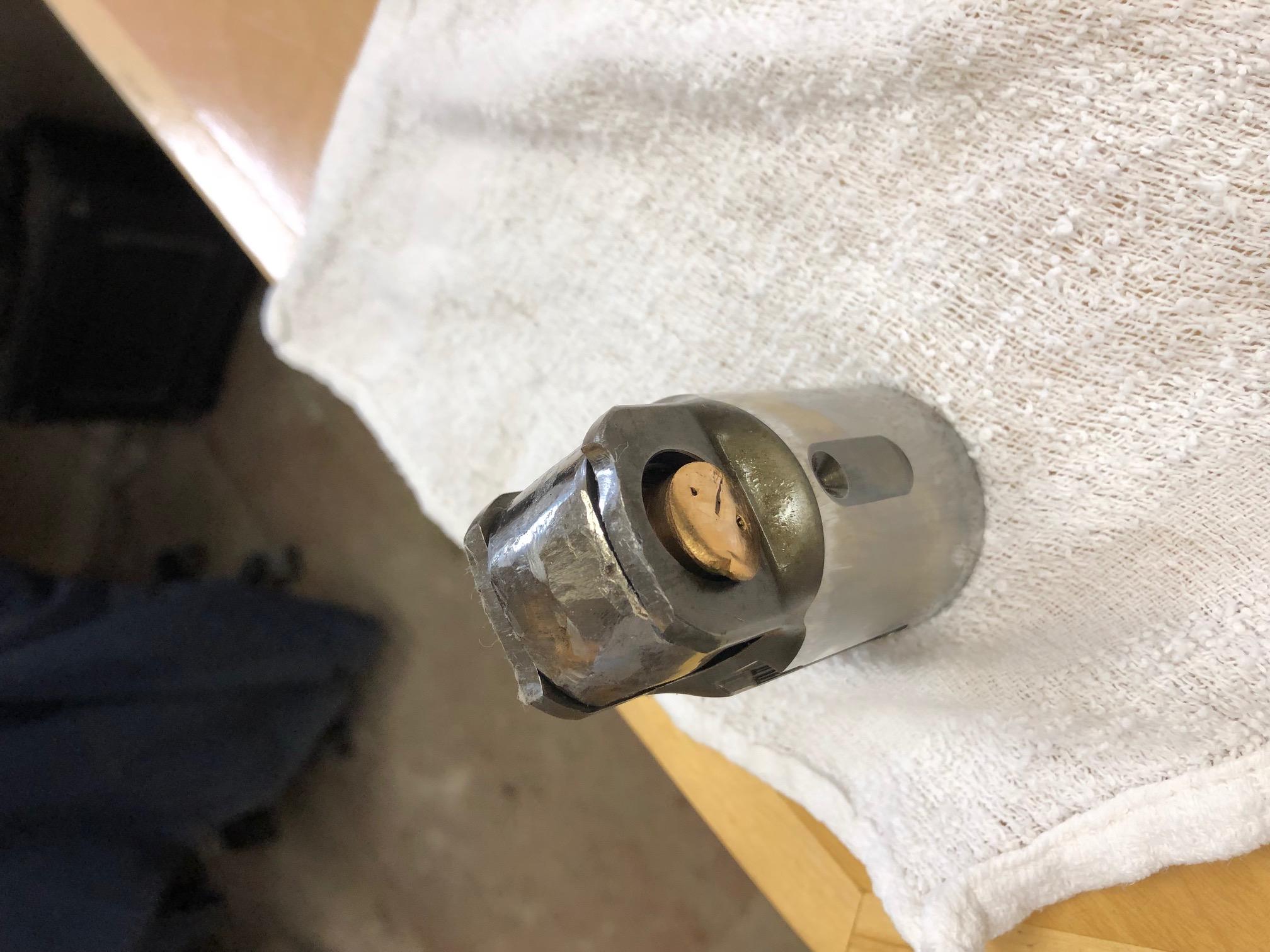

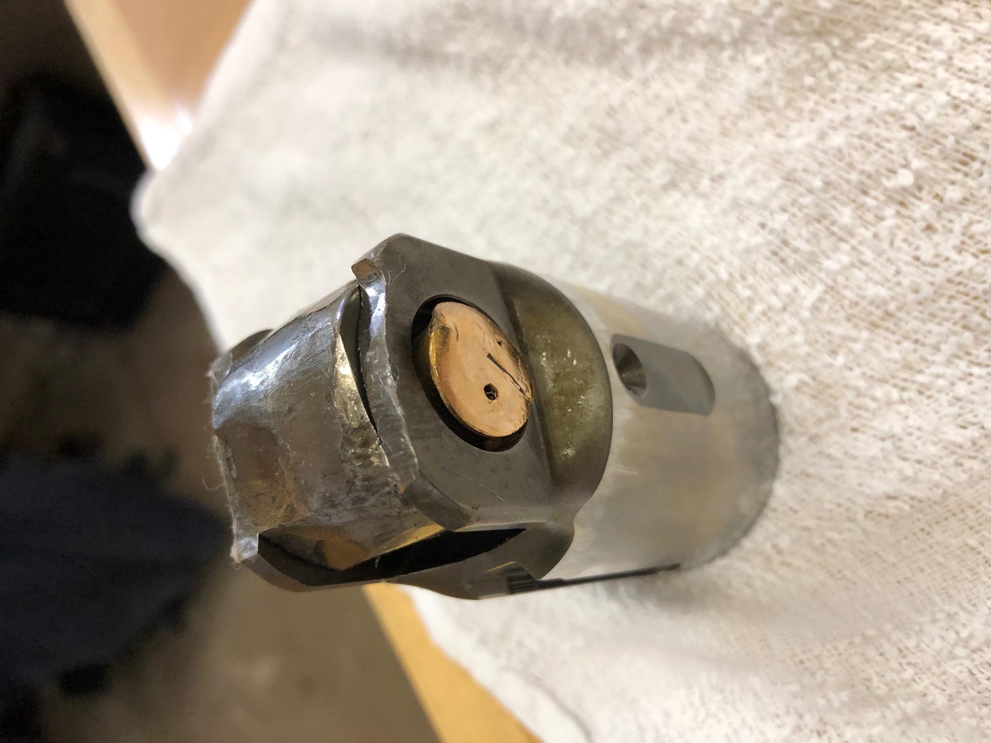

sorry it took so long been covered up, so i blew air in the injector hole the only place i heard air was coming out of return line at fuel tank. But the eup roller has several flat spots should i be concerned or drop a new roller in and see how she does?

😩 Flintstone’d. Sad day. Camshaft replacement time.

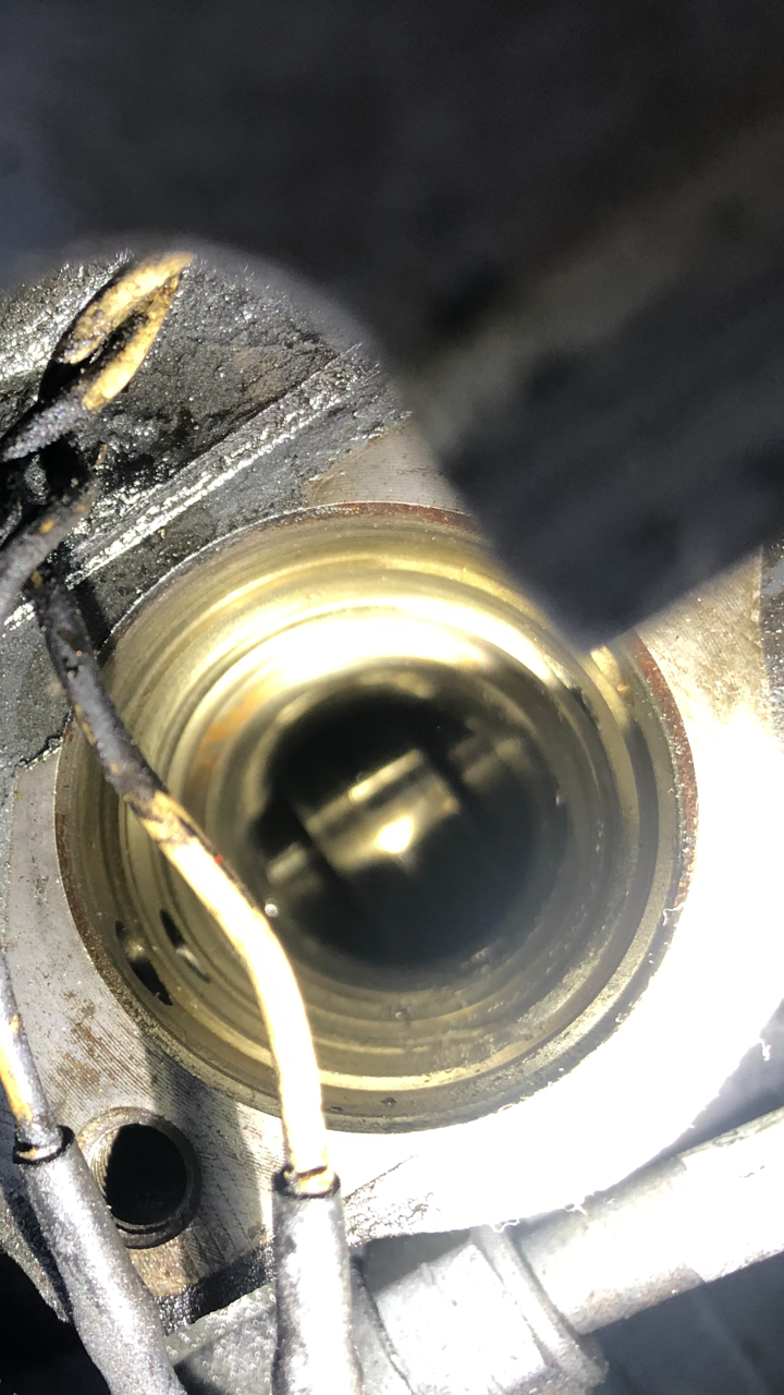

Yup its time ! You need to also look to make sure the roller guide pin is not sheared off take a look down the hole see if the pin is still there !!!

Yes you should and the pin is replaceable Chances are the cam is done for!

In My opinion Its worth a try if its going to cost you a roller and a guide pin and some time that's all you got to loose! if in deed the scratches are minor, Go for if it! If you get a year you pay your self .f it fails tomorrow  OWELL You rolled the dice !!
Flush the pan out and give it a go! I Have A hard time believing the cam is not damaged beyond a few scratches  however veiwing the lifter damage!

So there ya go! Tech has some evidence its doable!    remove the broken pin.  maybe lightly brake hone the roller bore  while  the pin is removed install the new guide pin and rinse the pan out , give it a try Not really to much to loose in my mind! Might go for ever like that!😉

Thanks for all the help ended up putting new cam and rollers in working on #6 eup tappet bore pin part# 20706385 are these just pressed in? having a hard time trying to get it to tap out, does anybody know of a certain way to remove pins? Thanks!!

Interference fit. I’ve always pounded them out with a punch. Not always fun. Imagine #6 is nearly impossible to get a decent swing on.
