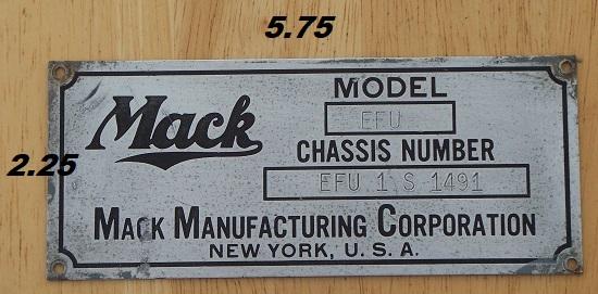

The VIN tag for the E model is usually on the seat bolster.  So if you open the pass. door, the VIN tag is right in front of you.  Here is a picture of an E tag and the holes are 2.25 apart on the short side and 5.75 inches on the long side.  I have seen a couple fire rigs where the VIN tag has been mounted on the inside firewall just above where the passengers feet would be.
With the style of your truck it may have been mounted on the front of the seat bolster.  Maybe you can find some empty holes matching the measurements?

Thanks for the info J Hancock! I see a set of holes on the front of the seat bolster (passenger side) which are very close to the dimensions you gave above. I can't see any stamped marks on the frame rail though. I did find a registration slip from 1962 in a stack of old paperwork I received which has an ID number listed although it does not match the letter/number format in the example tag above. I also just learned this morning of an alleged "box of chrome parts" located at our other fire station which I'm hoping may contain the missing tags... we shall see.

Would the plate on our Type-45 definitely look the same as the E-model tag pictured above? would the model stamp read "type-45" or something else?
On the front of the seat bolster, passenger side I see the hole pattern approximately matching the dimensions given by J Hancock but there is a second set of holes next to it that I'm wondering if may have been the mounting point for an additional plate of some kind, perhaps fire engine specific? any info or pics of plates on type-45's greatly appreciated.

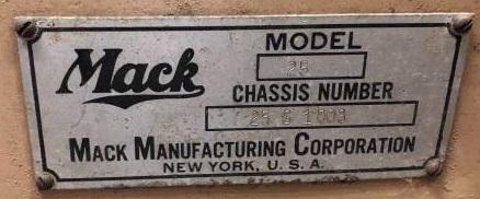

Not sure on the second plate and I don't have a 45 VIN plate to look at.  Here is a fire truck model 25 VIN plate.  Sort of hard to see but first box is 25 and the lower box is 25 S 1003.
Jim

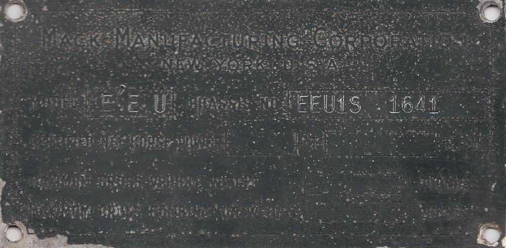

OK.  There is a slightly larger VIN tag that I had forgotten about.  The one I have unfortunately has been painted over in a handsome shade of dark green.
Top left box is the model  EEU and the box on the right is  the chassis number  EEU1S 1641.
The HP box and the weight boxes are not stamped.  The vertical holes are 2 5/8" on center and the horizontal mounting holes are 5 5/8" on center.  The overall tag is 3 X 6 inches.  Probably should break out the paint stripper...

yeah that looks more like the one in my pic, and the hole pattern matches. Now I know what i don't have :) kind of disappointing actually because I think the other ones look nicer. At least I'm not the only one with a bunch of stuff that's been painted over!
