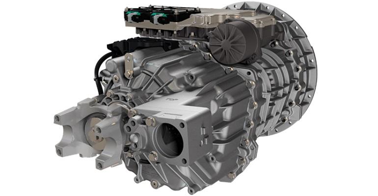

Eaton Cummins Automated Transmission Technologies recently expanded its Endurant automated transmission lineup to include a new dual Power Takeoff (PTO) version of the 12-speed model.
The new dual PTO option of Endurant provides customers with two PTO mounting locations: an eight-bolt bottom mount and a four-bolt rear mount with a combined 95 horsepower capability. A single PTO model with an eight-bolt bottom mount location also is available, giving fleets enhanced flexibility in the secondary market.
