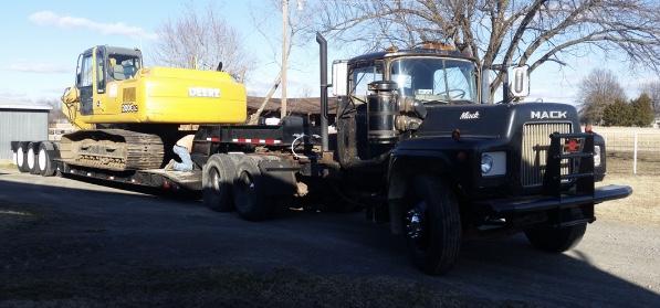

I have a 1978 R685ST with a 285 maxidyne and the 2 stick 6 speed with 4.17 rears and tall 24.5’s. Truck is getting a new cab this week and paint job. Old cab is rusted out badly. I have an Eaton RTO14909MLL from a wrecked mixer truck with E7, I think has mounts that will work. Now would be the time to swap transmissions if I want. I was thinking it would help lower my rpm at highway speed and give me a little more top end and maybe help me out on hills. I live in an area with lots of hills. Pull a lowboy to move my equipment and pull an end dump. I like the 2 stick but the gap from 4 to 5 is pretty big with all the hills and I can only get about 60 mph or so on flat ground to the floor tached out. Transmissions look to be within 1”-2” of each other in length. U joints different. Would it be worthwhile to swap? Since the cab is off anyway

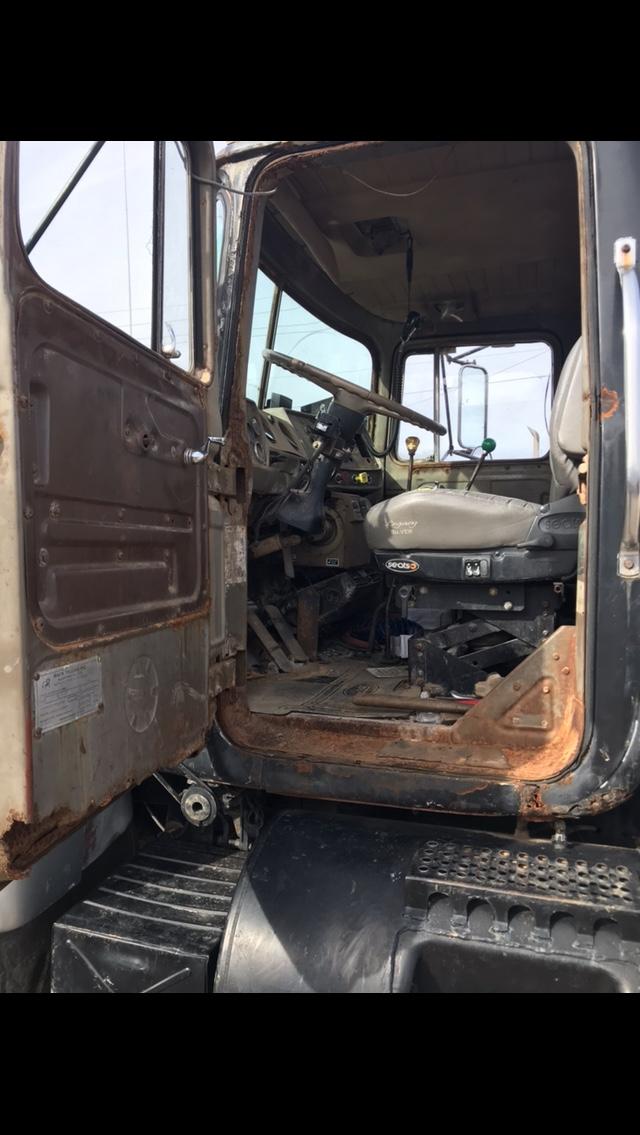

Rob,
The old cab and doors are rusted out severely. It was an oil field tractor that pulled salt water tanks. The engine has about 300,000 miles and does not leak or use oil. It’s rough and it’s loud. But it’s been very trustworthy. Refurbished cab and interior with new dynamat and sound insulation and some interior panels from a wreck. I’m actually going to install a stereo if it works out. Lol.  I’m fabbing up a cab air ride (to help counter those camelbacks, lol) and it’s getting a pair of new used 6” stacks and new rubber. A Lund sunviser off another wreck and new paint. I like the truck. Very simple. It is awful to service... has 3 big oil filters and holds 14.6 gallons of oil. Lol. That hurts. Lol
